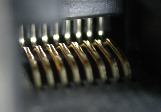

Do keep in mind that those pins may appear to be bent, because they are supposed to be bent! But what you are looking for there are pins that are touching each other, or are not all resting at the same height. Not so much a bend -- that's normal.
#309181 - 16/04/2008 12:04 Re: Ethernet link light on empeg, but not on switch(es) [Re: mlord]
Posts: 14527
APIWATW:
Description: A good ethernet connector (upside down).
