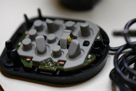

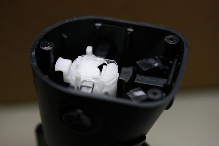

so i guess the switch inside is stuck... can i take the stalk apart ? Yes. I just took mine apart here to find out. Be *very* careful not to drop any pieces. Do this at a table in the house, not in the car. Remove the rubber mounting pads, and undo the three small pozidrive (phillips) screws. Keep the stalk upside down during all of this (KSource button at the bottom!!). The switches are all on the removeable plate, and the "shift" switch is the larger yellow one:
Description: Stalk button assembly. Description: Stalk mechanical assembly -- keep it upside down like this, or it will fall apart and be VERY difficult to reassemble.

Note that second photo above: there is a clear plastic plate just sitting there, only gravity holding it in place. I think this is what may be wrong in your stalk: that plate may be in the wrong location or something.
