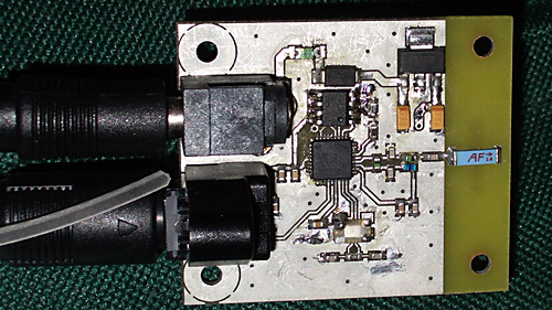

Since things have slowed down quite a bit with Empeg related tasks, I've turned to developing some related audio bits. One such device is an SPDIF wireless transmitter. It has TOSLINK on both receiver and transmitter and is about 1 inch square including chip antenna. It's only a prototype so far but at least it works. I need to work on improving the range (about 5-10 meters through floors and walls) and make it auto select sample rates, but otherwise it seems to be great.
The nice thing about it is that it does not depend on any particular application like the Airport Express and also is lossless with error correction.

#321796 - 28/04/2009 07:21 Re: Wireless SPDIF Anyone? [Re: maczrool]

That sounds interesting, please keep us informed of progress!
How is it powered?
How is it powered?
Also, when you feel the product is mature enough, the folks here may be interested.
Thanks. Currently it's powered by a wall-wart type supply. See attached picture.

If anyone is interested in reading more about this, the chip I'm using is the Nordic nRF24Z1 . It supports up to 24-bit (with compression) or 16-bit uncompressed 48 kHz and S/PDIF or I2S and also wireless SPI and I2C for control.
Currently I am dealing with a frustrating problem of the device not working with anything but 44.1 kHz sampling rates no matter how it's programmed. It may be that it only does 44.1 kHz over S/PDIF and I have to resort to using I2S via S/PDIF receiver and transmitter ICs to get the other supported rates.
