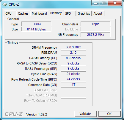

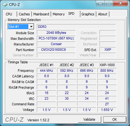

Here's a screenshot of CPU-Z. Does everything look Kosher? If what CPU-Z is showing is accurate, you're actually running the memory at DDR3-1333 speeds whilst it is capable of running at DDR3-1600 speed. What are the BIOS settings? Can you show me what the SPD tab of CPU-Z says?

The motherboard's product page says: Supports six unbuffered DIMM of 1.5 Volt DDR3 800/1066/1333*/1600* (OC) SDRAM, 24GB Max Those asterisks and the "(OC)" don't exactly give me a warm fuzzy.

The motherboard's product page says: Supports six unbuffered DIMM of 1.5 Volt DDR3 800/1066/1333*/1600* (OC) SDRAM, 24GB Max Those asterisks and the "(OC)" don't exactly give me a warm fuzzy. Yeah. The current i7 CPUs only officially support DDR3-800 and DDR3-1066 operation.

Uh oh, you guys are scaring me  Optimistically, would I be able to overclock it to the correct specs? Shouldn't the memory be able to dial down okay? I had to run some errands, but I'm back. I have 2GB in the system now, with a different stick this time. No problems running flash video for about 10 minutes now. I think this one is fine. Here is the SPD tab with the one stick in.

Uh oh, you guys are scaring me  Optimistically, would I be able to overclock it to the correct specs? Shouldn't the memory be able to dial down okay? Yeah. It'll be able to run at a slower speed fine. You're still actually overclocking the memory controller but it appears unofficially Intel are rating it for operation at those speeds anyway. They've already unlocked the QPI bus multipler due to pressure from motherboard makers. I'd check the PSU as others have mentioned. Are there are any BIOS updates for your board? What voltage is it set to in the BIOS for your RAM?

Harumph...I just updated the BIOS, and now I can't figure out why it's lowered the speed of the RAM to 1066. I mean, if it runs smoothly at that speed with all the sticks in, I suppose I'll be happy with that, but it looks like all the settings are the same and yet it's reporting a lower speed for the RAM.
I'll check the voltage in the BIOS on the next restart.

Harumph...I just updated the BIOS, and now I can't figure out why it's lowered the speed of the RAM to 1066. DDR3-1066 is the maximum official speed for the memory controller in the current i7s. You need to tell it that you want DDR3-1333 or DDR3-1600.
