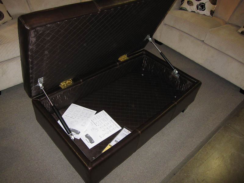

Ok, let's get back into it. smile Sorry, but I've been a bit busy with my other construction projects and didn't get the images off my camera.
The diagrams on the McMaster Carr site seem to orient the lift in the most sensible orientation. As you can see below, in this commercial Ottoman, not only did the install orient the lifts upside down (chamber down, piston up), but the install is also "rough" looking. The lifts are installed in a sort of backwards configuration compared to the illustrations and definitely don't aid at all in the first few inches when opening the top. This also means the top can slam shut in the last few inches. Maybe even a full foot. Not too good when concerned about little fingers.
Incidentally, my ottoman should look a *lot* better than this unit when it's been upholstered and fitted with hardware.

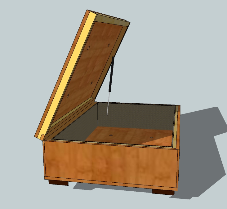

These images on the McMaster-Carr site show how I think the lifts would be best installed for this application:
I'd like the top to open to 65 degrees which I've shown in the model below (along with a crappy representation of the lift).
The frame is 31 x 47" and the top is definitely balanced in the middle. The top currently weighs 26lbs and could weigh between 40 and 50lbs once upholstered.

#332904 - 12/05/2010 16:04 Re: Engineering/Mechanics lever questions/calculations. [Re: hybrid8]
Posts: 5553
This is probably a dumb idea, and certainly not as elegant as what you intend... but as far as figuring out where the lift attachment points should be, could you make multiple pivot points like in the attached drawing and just use the ones that work best?
#332906 - 12/05/2010 16:32 Re: Engineering/Mechanics lever questions/calculations. [Re: tanstaafl.]
I could make the multiple attachment points. But I still need to figure out one thing ahead of time.... Which lifts to buy. smile In choosing those I need the right combination of compressed and extended length and force.
#332908 - 12/05/2010 17:25 Re: Engineering/Mechanics lever questions/calculations. [Re: hybrid8]

#333237 - 22/05/2010 16:45 Re: Engineering/Mechanics lever questions/calculations. [Re: wfaulk]
I understand what the sliders do as you've explained, but I don't know how to use what you've implemented to do what I think I need to do.
I know the spring parameters, so I don't want to manipulate them manually, but I'd like to set them as limits for the line representing the spring. I don't need to change them once they're set. I understand I can just leave the sliders where they are for this.
The way I imagine working the puzzle is to move (rotate) the lid about its hinge with the spring ends fixed to points I've set. So I thought I'd like to move both ends of the spring.
This is something that shouldn't have been that difficult to do in Sketchup so that's why I was trying that Physics plugin. However, I may have to give it a shot in a Windows VM. At this point I'm not so concerned about the forces because I don't even know where I can mount the ends of the spring to allow the lid to close (and open) properly (at all).
Edited by hybrid8 (22/05/2010 16:46)

#333266 - 24/05/2010 00:40 Re: Engineering/Mechanics lever questions/calculations. [Re: hybrid8]
Why? What information are you going to gain by looking at the lid halfway closed? The fully extended length is when the lid is fully open. The most compressed length is when the lid is closed. Both of those are depicted in my diagram. The points in between are irrelevant; at no point will the spring need to be anything other than between those two extremes.
If you move the mounting positions somewhere where the spring would bottom out, the lines depicting the spring turn red.
Set your desired fully-open angle. Set the length and stroke of the spring. Move the bottom mount point around. It'll give you all the information you need to know after that. The only vaguely hard part is entering how far away from the seam the lid end will mount.
The really hard part is figuring out where to place the spring so that it's strong enough to start lifting on its own at a useful point.
#333267 - 24/05/2010 02:07 Re: Engineering/Mechanics lever questions/calculations. [Re: wfaulk]
We're obviously on two completely different paths in thought here.
It's not the extension of the piston in between open and closed that I'm worried about. It's the extension when closed, which isn't necessarily fully compressed. When the lid is open, the spring will be at full extension unless I employ some other device to limit the lid opening. How compressed the spring is when closed depends totally on mounting position and that's what I don't see how to figure out without moving the lid.
The spring will actually only work in very few positions, irrespective of its force and the weight distribution of the lid. Speaking strictly of its ability to extend and compress, only very few positions for each end will allow the lid to get to the angle desired when open and flat when closed. Obviously the force is important to complete the functionality, but it's irrelevant if the lid can't be actuated through its desired path (from 0 to 65 in my case).
The idea behind me getting a compressible object into Sketchup was so that I could actuate the lid and check whether certain mounting locations would allow it to both close flat and open to the desired angle. That's why I mentioned being able to move the point which represents the most outward on the lid in ggb.
