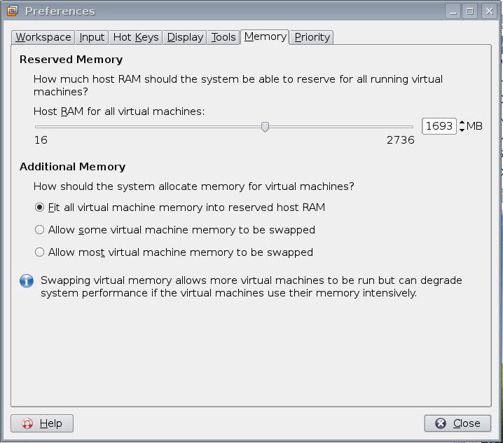

Workstation doesn't do that on my systems. I wonder what config option is misdialed on yours ?

Yeah, that setting doesn't make any performance difference. It wires the guest's memory, so the host OS doesn't swap it out, but VMware still writes its own backing store. Some people are suggesting that you can move that backing store to be in /dev/shm, but I'm concerned that that will cause double memory usage. I guess I can try it out.
It is ridiculous that it has this backing store at all.
