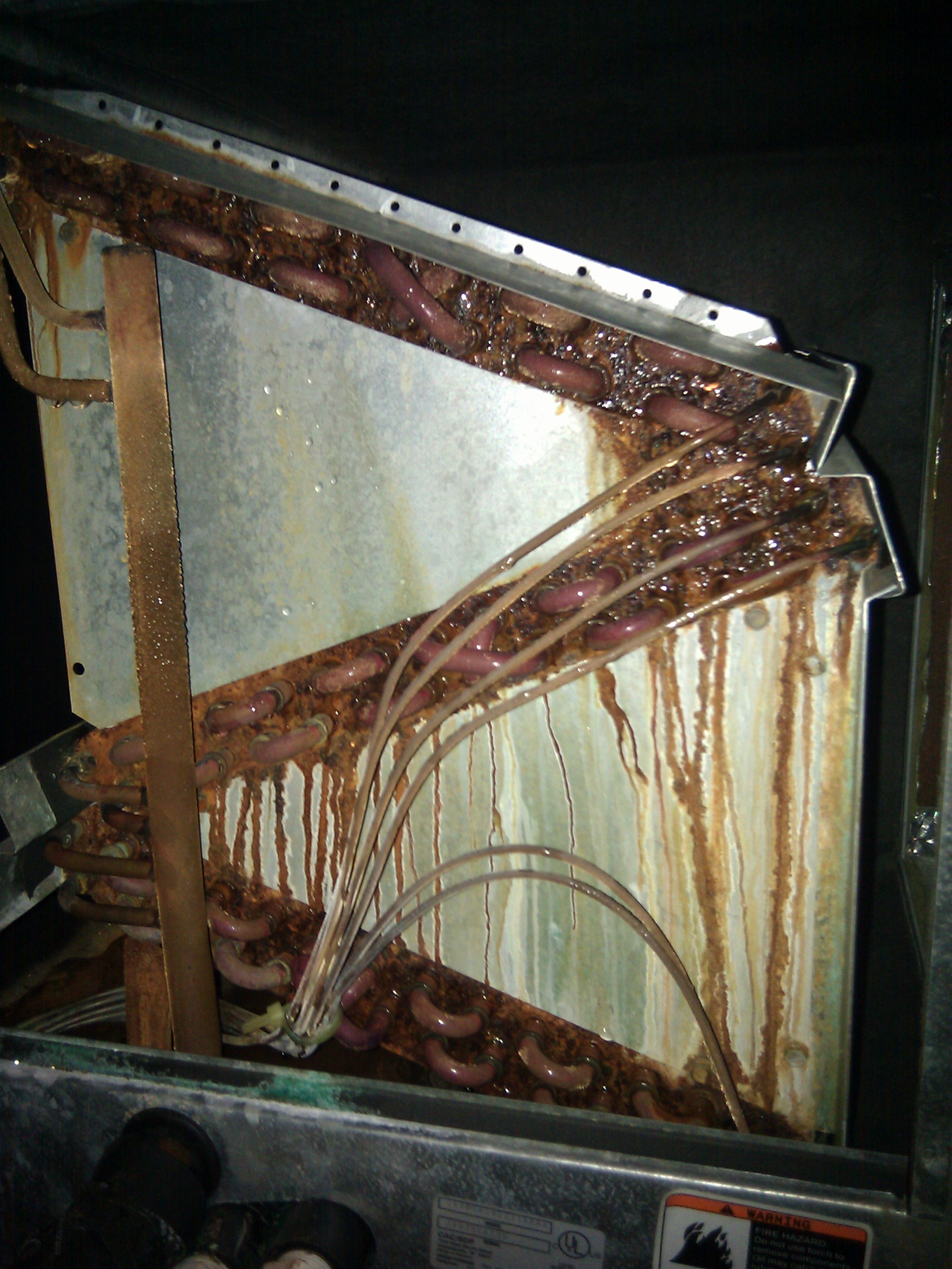

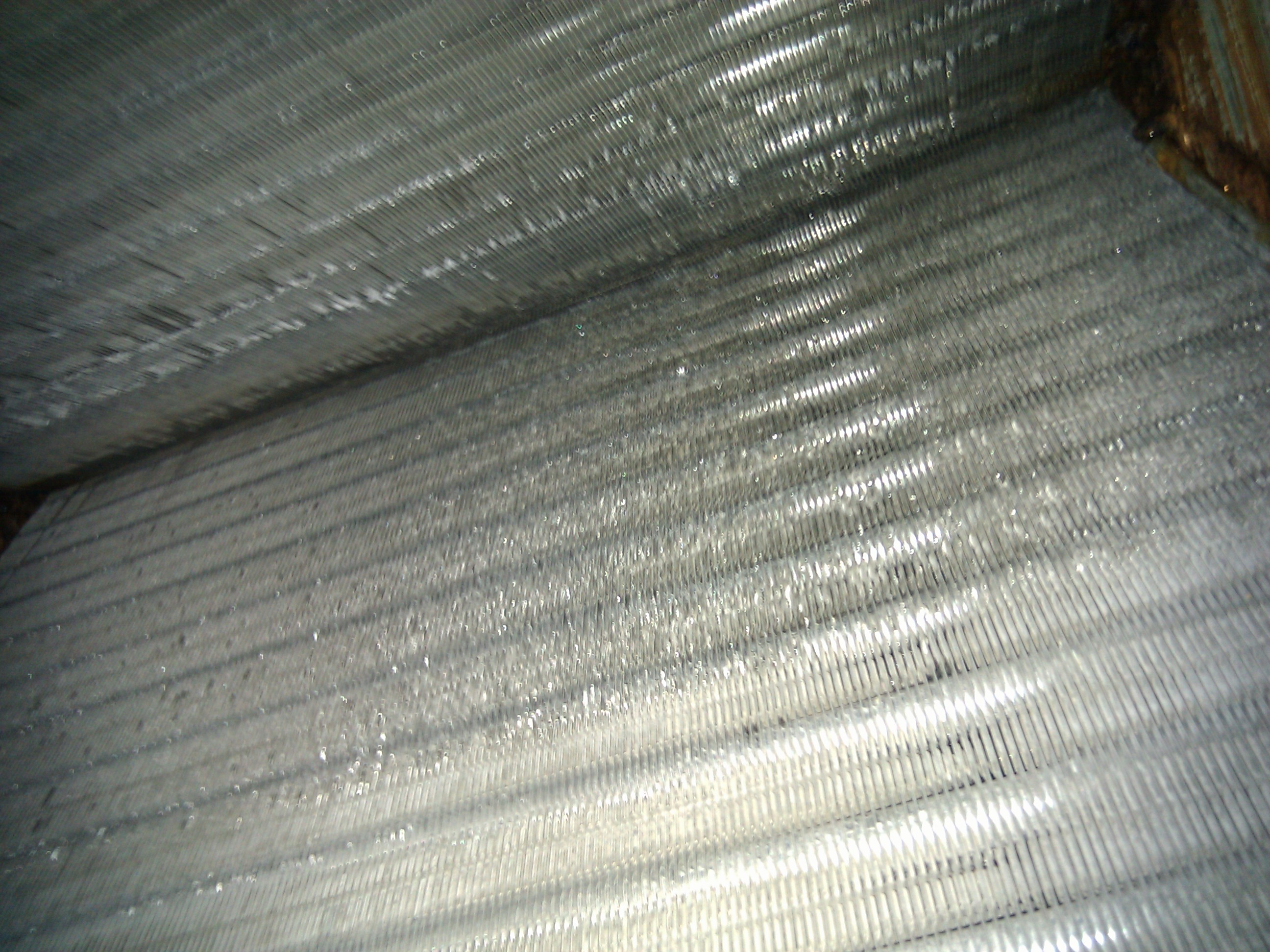

The evaporator is not frozen. Unless it was able to thaw out over a few days. In fact, I can't imagine that it could possibly get cold enough to freeze. It was about as cool as the outside of a glass of iced tea, and produced about as much condensation (per unit of surface area).
The only filters are the ones in the return vents, and we change those regularly. At least I couldn't find any in the furnace/AC unit in the attic.
The ductwork is not exactly well sealed. It looks like there was some sort of dope used to seal the seams, but it's not doing the job, not to mention the sizable holes where the refrigerant pipes go in. But I can't imagine that that would have a huge impact.
There was an odd sound coming from the evaporator. It may well be normal, but it sounded like a leak. It was kind of halfway between a whistle and a hiss. It wasn't constant. It seemed to do it for about 30 seconds, then pause for about a minute, then repeat.
There were two refrigerant tubes running into the ductwork, one insulated and the other bare. I assume that the insulated one should be the cool one. It was moderately cool. Enough to generate some condensation inside the ductwork where it was uninsulated. Inside the unit, it split into two or three smaller tubes that fed the evaporators. On the other end of the evaporators, the return tubes were more and smaller. They were pretty cool. Where they passed out of the ductwork, they were somehow joined into a single return tube, which was sometimes room temperature, and sometimes somewhat warm.

Yes, the insulated one is the cool one. When you say "unless it was able to thaw out over a few days", were you running the AC during those few days? It will thaw out in a couple of hours, typically, but you usually need to turn it off first. You want to run the AC for 8-10 hours constantly and then check for freezing. The evaporator, in the area you describe as "pretty cool" should be cold. Unambiguously.
The evaporator might make a hiss sound because you could be hearing the refrigerant escaping through the orifice tube/expansion valve. You probably know this already, but the AC works exactly like the cold created by discharging a CO2 fire extinguisher. The rapid expansion and transition from liquid to vapor, because of a pressure drop, absorbs heat. In an air conditioner, they just collect all that gas and then re-compress it and condense it in a cycle. So you can hear the hissing of the refrigerant some times, which is the gas expanding out the nozzle.
I can't tell from your photos, but is the evaporator coated with a spider-webby looking grunge? If so, that is going to have a big affect on the cooling. I am pretty certain your system is not operating at capacity. There's only about 4 things it can be: dirty/frozen evaporator, dirty condenser, low refrigerant, malfunctioning/clogged expansion valve. Well, add two more: there are two fans in the system. Is your condenser fan working? If the coils are clean, the fans are running, and the compressor is working and it's not getting cold on the evaporator, you should have the refrigerant level checked.

It was kind of hard to look at the heat exchange fins due to the way the mechanism was mounted and the location of the access panel, but they seemed perfectly clean. Shiny metal and nothing left on my fingers when I touched it.
Just to be certain, the condenser is the big fan unit outside, right? That may well need to be cleaned. It's worth looking at, but I'm not going back outside in the heat today if I can help it.
Like I said, the cold pipe was about as cold as the outside of a glass of iced tea. I would have hoped that it would be cold enough to be unable to hold onto it for very long, but I'm pretty sure that I could have held it indefinitely.
Sounds pretty clean. We can tentatively rule out low airflow across the evaporator, I think. The furnace fan *is* running, correct?

Was the evaporator quite wet?
Oh, yeah. Dripping. Well, at least the copper tubing leading to the evaporator. I don't recall the fins being wet; in fact, I'm almost certain they were dry.
I'm going to clean the compressor unit tonight, and observe how dirty it is. I'll also verify that the fan is actually working.
I was surprised at the amount of rust on the evaporator, too. You'd think that a device that's designed to be wet wouldn't be made from carbon steel.

Yeah a 20 degree drop across the evaporator seems reasonable. That's more a function of the surface area of the heat exchanger itself. Keep in mind, however, that as the ambient air inside the house cools, that 20 degree drop will continue, *progressively* cooling the air more and more.
If the system has a leak, even on the low-pressure side, it won't maintain refrigerant. These are volatile compounds that evaporate readily to the atmosphere (making them good refrigerants!). Also, even a small leak will get water vapor in the system, totally screwing you.
I think you need a new evaporator and consequently a evacuation and recharge. Too early to tell 100%, but that's how it looks to me.
