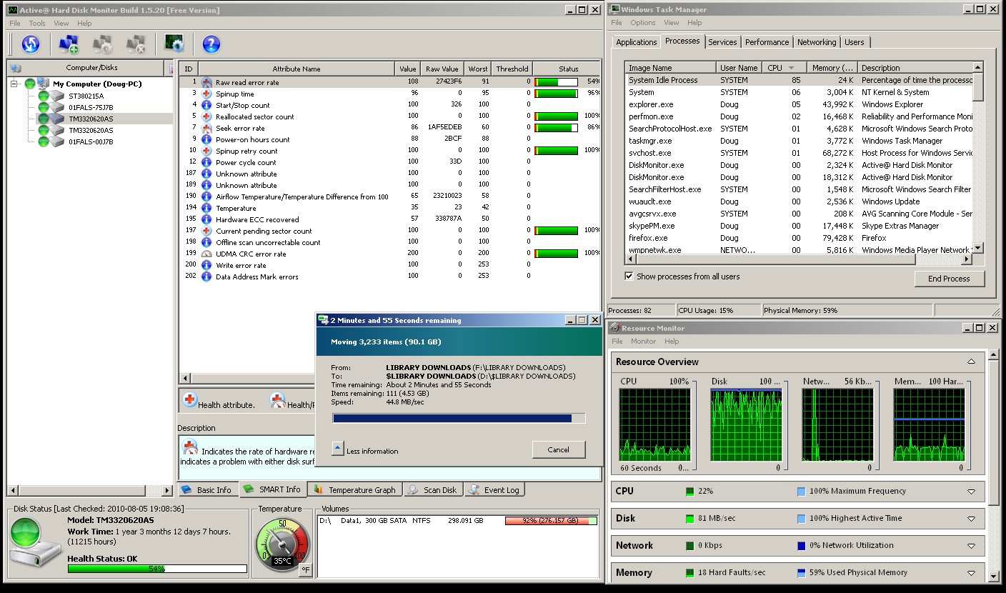

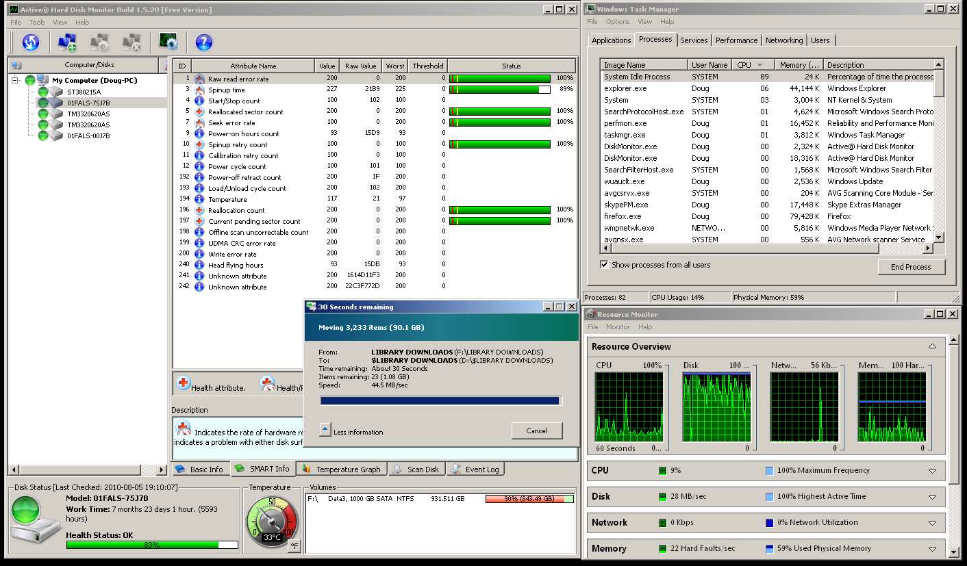

Running backups overnight, the backup program slowed and finally quit ("program not responding..."). A little bit of experimenting seemed to show that any program with high disk I/O exhibited similar behavior.
The first attached screen shot seems to point toward the cause of the problem, but I am beyond what little bit of expertise I have in these matters.The shot was taken copying C:-->M:, but the failure actually occurred while copying F:-->L: which would suggest that it isn't a problem with a specific drive.
Is this as serious as it looks? MEMTEST.EXE showed zero errors after running for an hour.

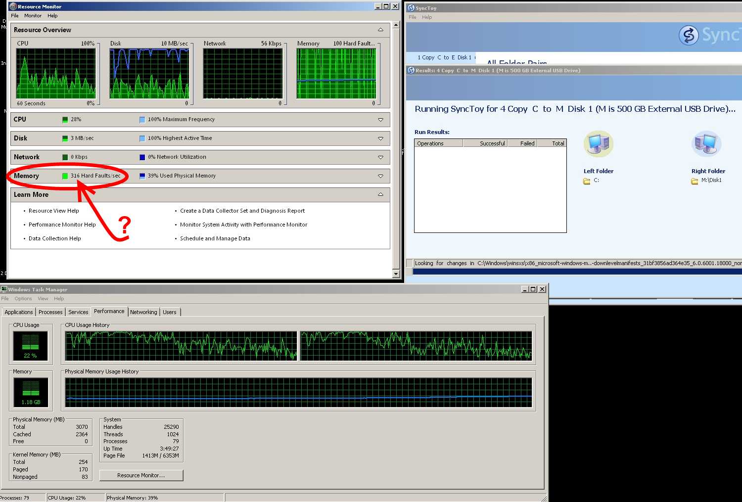

The second screen shot shows what things look like when the backup application stalls. It looked pretty much like this for about five minutes before I captured it.
Right-click on the picture and select "View Image" to make it more legible.
Does anybody know what is going on here?
#335815 - 05/08/2010 14:18 Re: Memory problem? [Re: tanstaafl.]
Depends on what you think it looks like.
It does not mean that your memory is faulty. In this context, "fault" means that the information that was requested was expected to be in RAM, but wasn't, because it had been paged out to virtual memory on disk.
It does mean, however, that you have less RAM than the processes you're running concurrently need. It still works, nominally, because the OS is able to move data from RAM to disk when it needs more RAM for something else, but a hard drive is many orders of magnitude slower than your RAM.
This is normally not a big deal when you have multiple programs running concurrently when they're not really doing that much all at the same time. (For example, if you have Photoshop open with a huge image, it's okay for it to page all that memory out to disk when it's not being used, because you're doing something else. When you get back to Photoshop, it'll just pull it back into RAM and page out what you had been working with.) But when processes all actively running at the same time need more RAM than you have, it starts using the hard drive as intensively as it uses the physical RAM. Or tries to. And it's incredibly slow.
So: run fewer programs or buy more RAM.

Yeah, what Bitt said. "Fault" doesn't mean faulty in this case. It just means that there was a ram<->disk swap happening, which happens all the time on computers, even when things are working normally.
He's got the maximum possible memory for a 32-bit system, and this is an overnight backup (i.e., not a lot of other programs running).
A backup program should not cause a machine to run out of RAM and slow to a halt. Something else is going wrong here, something OS-related or software-related.
Sometimes I've seen AV programs get into race conditions with backup programs.

#335818 - 05/08/2010 15:02 Re: Memory problem? [Re: tfabris]
Memory-mapped I/O (i.e. MapViewOfFile, which is the Win32 spelling of "mmap") probably also counts towards page faults. 300 page faults per second isn't very many, though; pages are 4Kbytes so that's only 1.2Mbytes/second. Is that about how fast the backup is going?

#335820 - 05/08/2010 15:55 Re: Memory problem? [Re: tfabris]
That's what was confusing me. I can't imagine how you're running out of ~3.5GB of RAM when you're not even using the computer. At the very least, I'd imagine that a decent backup program would give you the option to use fewer system resources.

#335825 - 05/08/2010 17:03 Re: Memory problem? [Re: Dignan]
Posts: 5691

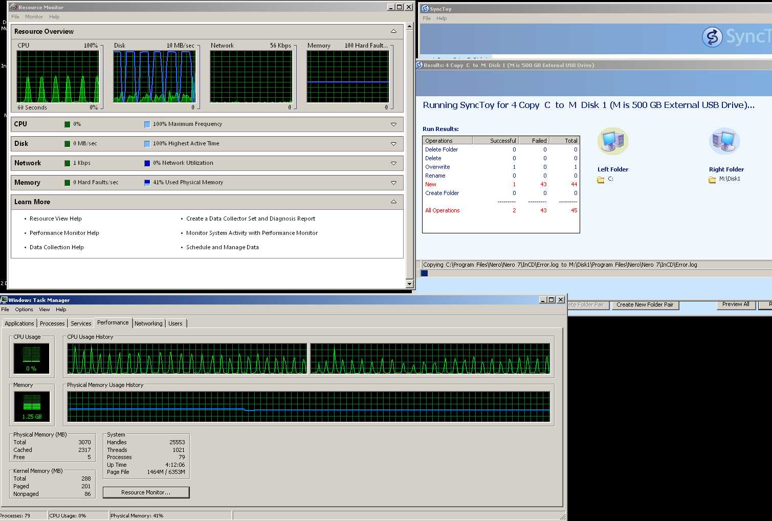

About 2.7GB (if I'm reading it right -- it's quite small) is being used for caching. This is expected; Windows Vista (and 7) aggressively use memory for caching.
And, as Peter says, those page faults could well be caused by memory-mapped I/O. This is perfectly normal.

#335827 - 05/08/2010 17:08 Re: Memory problem? [Re: Dignan]
You've got the memory and nobody is using it so the OS might as well use it to cache files. If an application does need that memory then it'll get released and allocated.
#335829 - 05/08/2010 17:21 Re: Memory problem? [Re: tfabris]
Oooh. He's got so much RAM that no one process can map it all (unless both the sysadmin and the process jump through hoops). Perhaps the backup program is sizing its buffers by system memory size, and running out of address space in MapViewOfFile? Is it possible to tell Windows to boot with only 2GB of RAM and see whether the problem goes away?
Alternatively, take a look in the Processes tab in Task Manager and see if the "VM Size" of the backup program grows endlessly, until it reaches 2GB and things start failing.

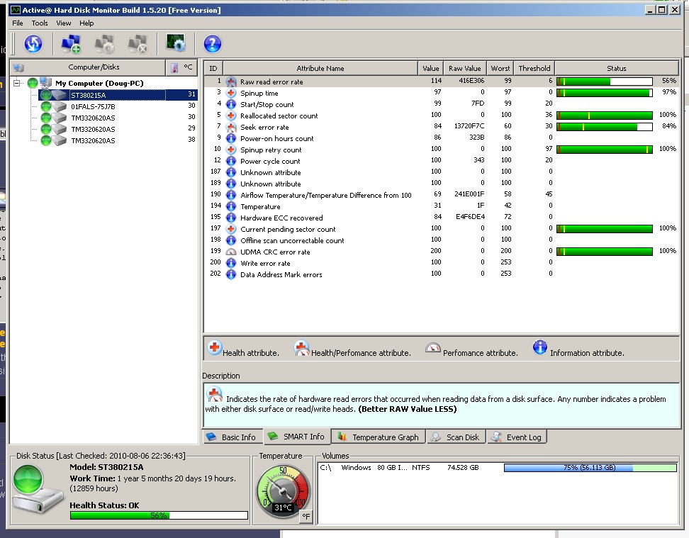

Let's see what this tool has to say about the state of your hard disks, please?
Here are pictures of source and destination drives.
I think the hardware is OK, but there is something very flaky going on with the computer as a whole. Right now it works for about a minute, then freezes: no mouse, no keyboard, and when the diagnostics are on screen, no disk activity, no memory activity, then it will start working again. It has frozen twice in the process of typing this post.
Neither one of my backup programs will copy more than a handful of files before it freezes up, yet Windows Explorer copied 90 GB of files at an average rate of around 50 MB/sec without any problems at all.
I ran an 8-hour MemTest with zero errors.
I can't deal with this anymore tonight, I'm going to shut it off, and hope it works better in the morning.
#335841 - 06/08/2010 01:25 Re: Memory problem? [Re: tanstaafl.]
Your D: drive error rates are less than healthy.
Download SeaTools and see what it reports. (It appears to be a Maxtor drive, and Seagate owns Maxtor now, and SeaTools claims to support Maxtor drives. If it's not a Maxtor drive, try and find a diagnostic utility from whoever the vendor really is.)

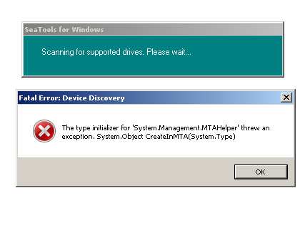

Not too much, as it turns out... frown

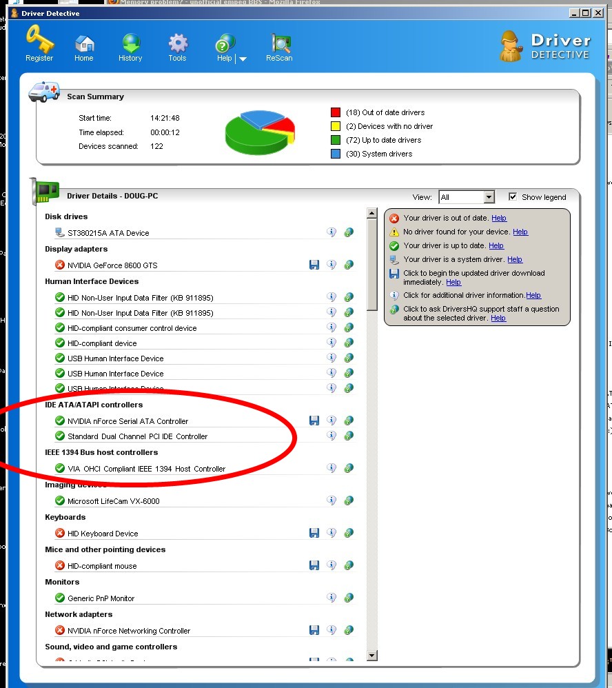

Are your IDE/SATA controller drivers properly updated on that system?
#335852 - 06/08/2010 17:40 Re: Memory problem? [Re: tfabris]
Apparently...
There are some outdated drivers, but in every case they are for equipment no longer installed, or for equipment that is (IMHO) operating properly so why go looking for trouble?

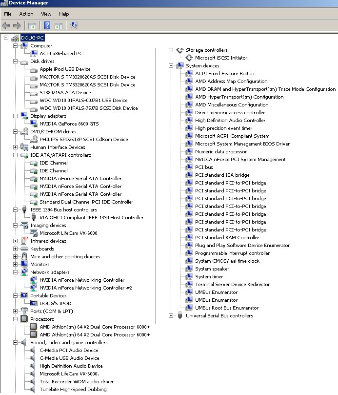

Out of curiosity, what motherboard or chipset do you have? A screenshot of Device Manager with the System section may help identify it (I think, don't have Windows handy at the moment to reference).
And does the external Vantec dock plug into eSATA directly into the motherboard, or into some sort of eSATA PCI card?
Here is a more useful screenshot.
#335888 - 07/08/2010 14:42 Re: Memory problem? [Re: tanstaafl.]
Yep, the second shot of device manager confirms the NForce chipset is running your SATA ports too. Some motherboards have other storage controllers embedded, though this tends to be for extra ports above what a chipset can support, or for adding in newer standards that haven't been universally adopted yet in motherboard chipsets.
