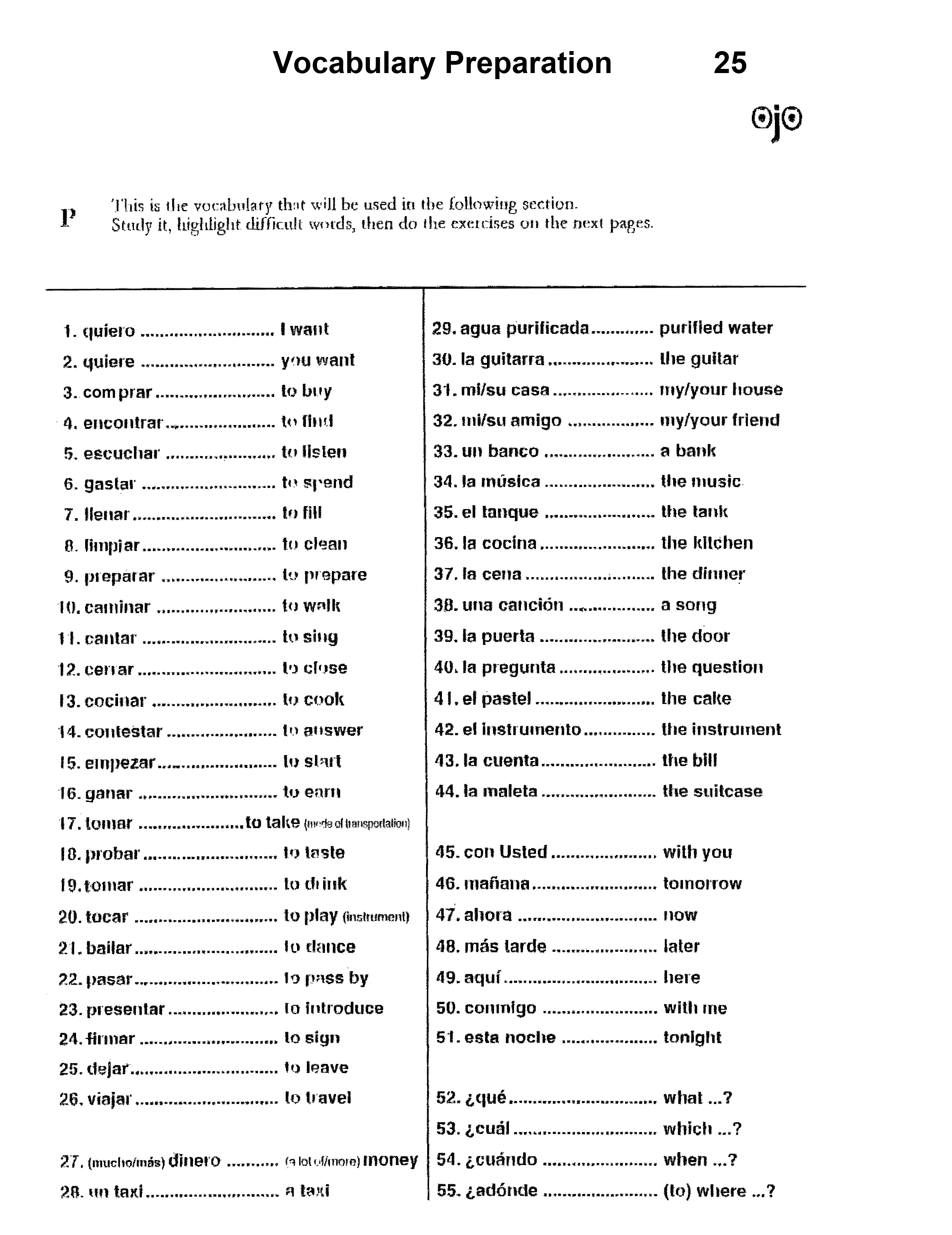

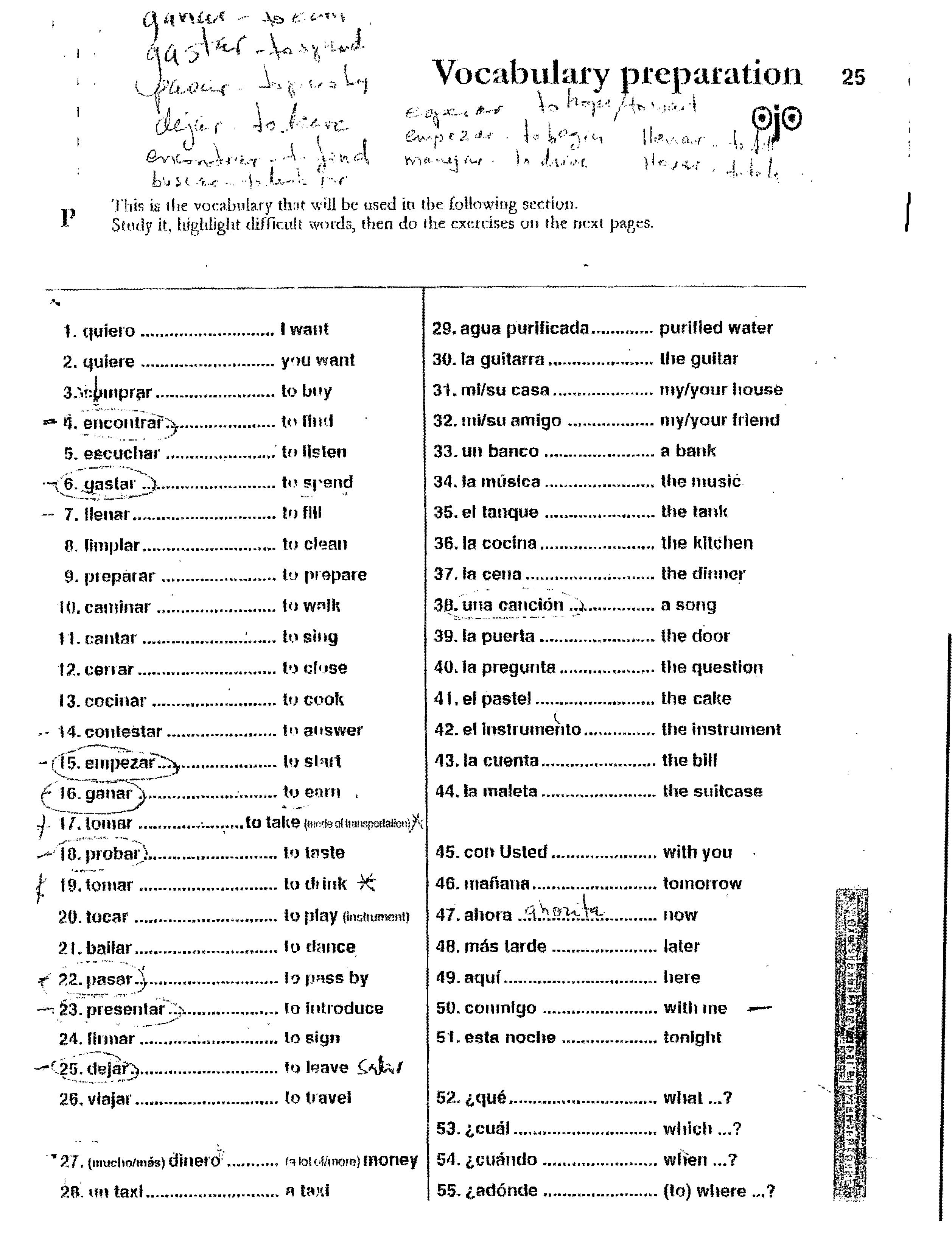

I have scanned into my computer a 170 page document. I saved it as a PDF file, then used Adobe Acrobat to save the PDF file as a Microsoft Word document (not too successfully, it saved a blank page between each "real" page but that could be fixed easily enough I guess) and also as a multi-page TIF file.
It is the TIF file I am most interested in. The original document was about a 4th generation copy with pages mis-aligned (I straightened them with the scanner software) and lots of noise and lack of contrast. Some pages were written on. If I could edit each page as a graphic, I could improve the look enormously.

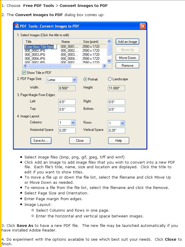

edit: I tried saving the PDF file as a .PNG file, and that saved the document as 170 separate files. That means I can edit each page individually, but is there any way to concatenate them all back together as a single document when the edits are done? I don't relish trying to print 170 separate files on 85 double-sided pages.

There should be free programs that can distill (adobe lingo) multiple images into a single PDF file. I don't think that will be a problem at all, so your best bet is probably to deal with the individual PNG files for now, rather than the multi-page TIFF files. You likely won't find many programs other than FAX software able to properly deal with multi-page TIFF - and then likely only being able to read, not edit. On a Mac, you could likely use the built-in Automator with a couple of simple actions to put all those images into a PDF. Here's one program: http://www.pdfill.com/pdf_tools_free.htmlAnd here's another program: http://www.Derring.com/swiftpdf/

I tried saving the PDF file as a .PNG file, and that saved the document as 170 separate files. That means I can edit each page individually, but is there any way to concatenate them all back together as a single document when the edits are done? A point-and-click way to do it, is to open a new LibreOffice document, and just insert each PNG into it, one per page. Then save the result in the format of your choice (eg .DOC or .PDF), and print it. With 170 pages, that could take an hour or two, but it's a one-time thing.. right? Otherwise, this could be scripted and completed within 10-15 minutes using commonly available tools on Linux. Cheers
