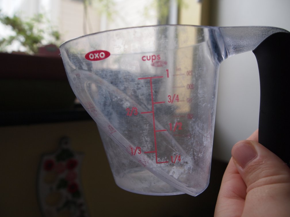

Here's a real homemaker question for you folks:
I have a really nice dishwasher from Kitchenaid that's no more than two years old. Up until about 1-3 months ago, it cleaned everything really well. I would just fill the detergent container with Cascade powder, make sure there was still Jet Dry in dispenser, and everything would come out just fine.
Then for some reason all my plastic stuff would come out cloudy, with this weird film on it. I've included a photo (though it shows a lesser case of this problem).
This is ONLY happening to plastic items (well, it's happened to a metal stirring spoon too). I've had no problems with my glassware or my ceramic/porcelain plates and bowls.
Any ideas what's going on? I've been searching around the web this morning, and everyone either talks about glassware specifically.

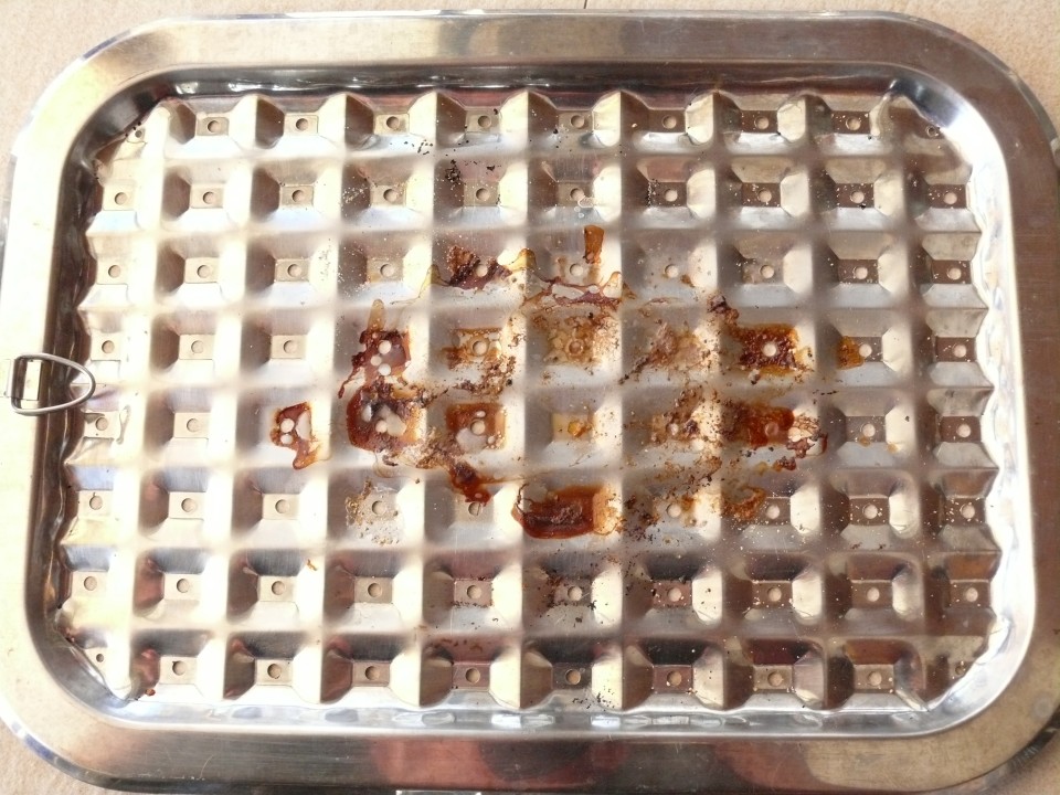

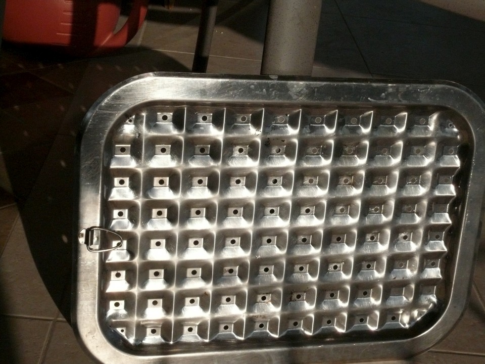

#342655 - 20/02/2011 15:26 Re: Dishwasher residue? [Re: tanstaafl.]
Posts: 5554
It [my Bosch dishwasher] does an incredible job of cleaning the dishes.
I continue to be impressed by it. Attached are three pictures of what it did with my broiler pan with grease thoroughly baked on. You could almost say vulcanized.
First is the pre-cleaning stage, then the pan before washing, finally the pan afterwards. Note that the pre-cleaning, although quite vigorous, accomplished little.
Description: Pre-cleaning stage
Description: Before the dishwasher
Description: After dishwasher
