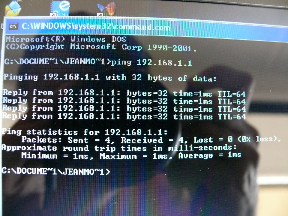

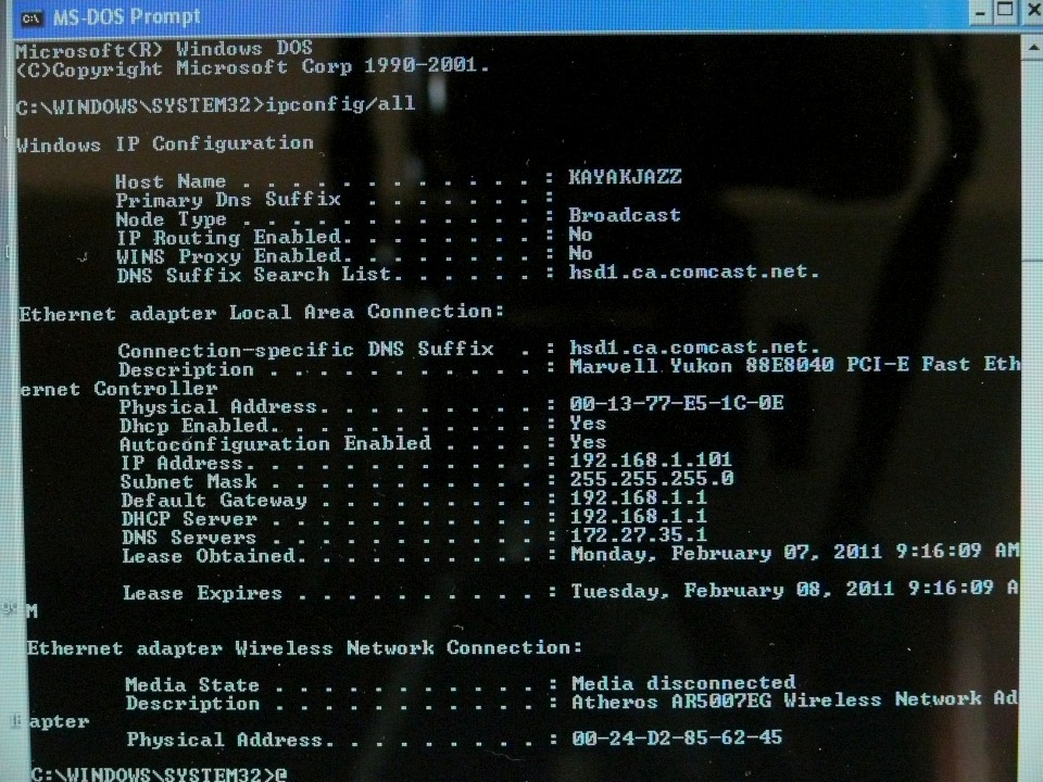

Ping 192.168.1.1.jpg (406 downloads)ipconfig-all.jpg (354 downloads)

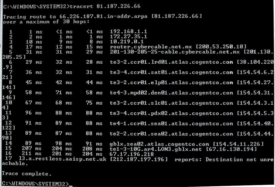

now try "tracert 81.187.228.66"

Don't be too critical of the photo quality. I live (literally) in a glass house with bright sunlight streaming in and lighting up the very reflective screen on the netbook. Makes things difficult...  It would have been so much better with a DSLR  There, someone was going to say it...

Posts: 5554
It would have been so much better with a DSLR  LOL!  Attached is the tracert photo. Thank you for the help! I am way over my head with this stuff! tanstaafl.

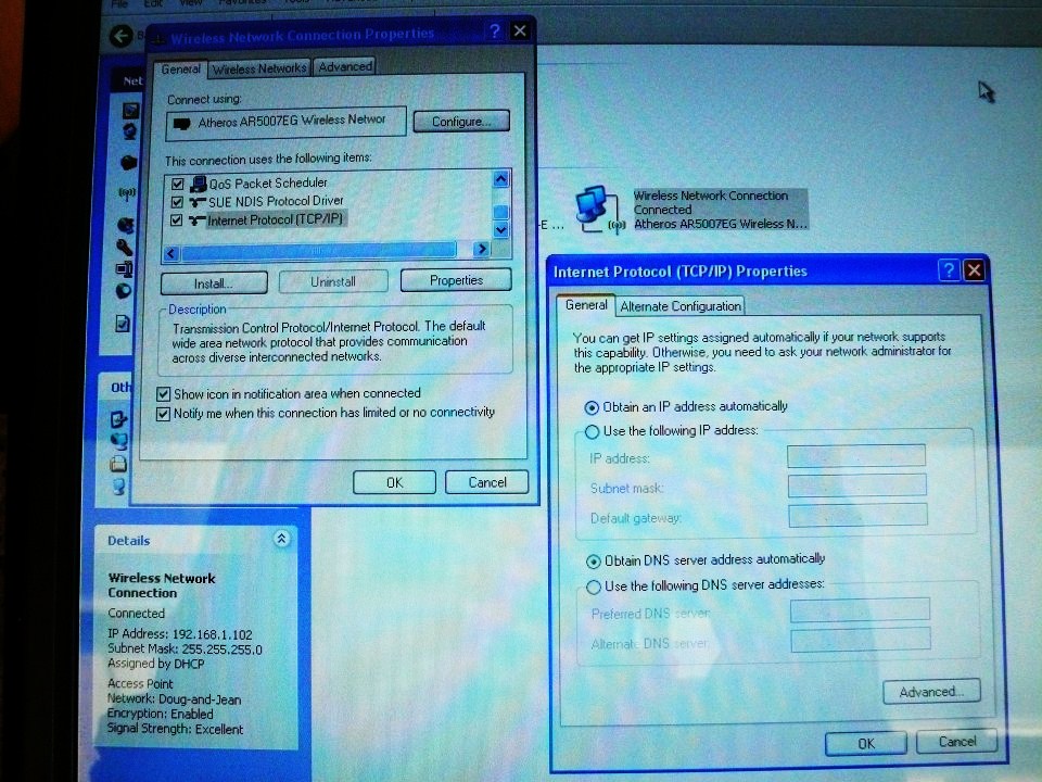

Control panel Network connections right-click your connection and click Properties double click on the entry for TCP/IPv4 make sure the radio buttons for obtaining IP and DNS automatically are checked
#342039 - 07/02/2011 18:09
Re: Why won't SWMBO's netbook connect to the internet?
Posts: 5554
make sure the radio buttons for obtaining IP and DNS automatically are checked OK. tanstaafl.

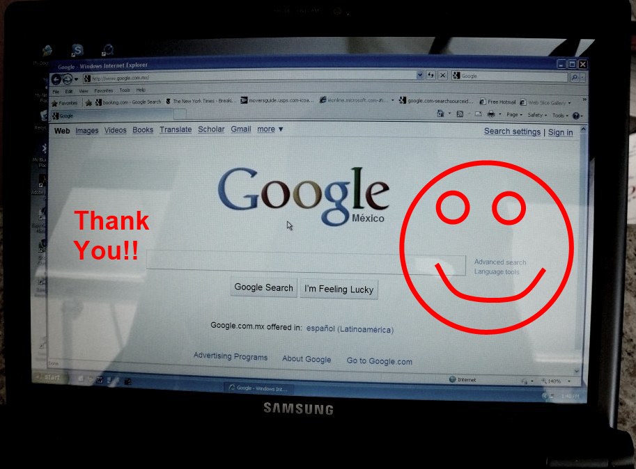

Try going to Internet Options, Advanced Tab. Use the Reset Settings option, keeping the clear personal settings checkbox unchecked.
Also, make sure under tools, Work Offline is unchecked.

It would have been so much better with a DSLR  LOL!  Attached is the tracert photo. tanstaafl. That tracert photo shows you are in facet connected to the internet correctly. You are resolving IP addresses into domain names, you are going from hop to hop... Problem is not in TCPIP, and it is not in radio association with the WAP. I think the issue may be in firewall or some browser setting. I suggest you 1. Try to disable windows firewall, just for a test: control panel, windows firewall, disable. - edit: sorry, I read in your first post you already did so. 2. Try a different browser (not permanently, fo course), just to see if it is browser specific. Edit: 3. Do messengers work? Do email clients (Outlook, or similar) work?

Posts: 5554
#342052 - 07/02/2011 20:06
Nice! Ben wins!

I don't mean to rag on you Doug, but, while I expected a screenshot of text-only information, I really didn't expect for it to have been taken with a camera.
#342086 - 08/02/2011 01:17
[Re: wfaulk]
Posts: 5554
I don't mean to rag on you Doug, but, while I expected a screenshot of text-only information, I really didn't expect for it to have been taken with a camera. But what other option did I have? I guess I could have done a printscreen, saved it to a MS Paint file as a .jpg, then copied the .jpg onto a flash drive, brought the flash drive over to my computer and copied the file onto my hard drive, then attached the file to the bbs post. Without any connectivity on the netbook, there was no easy way to get the data to the bbs. tanstaafl.
