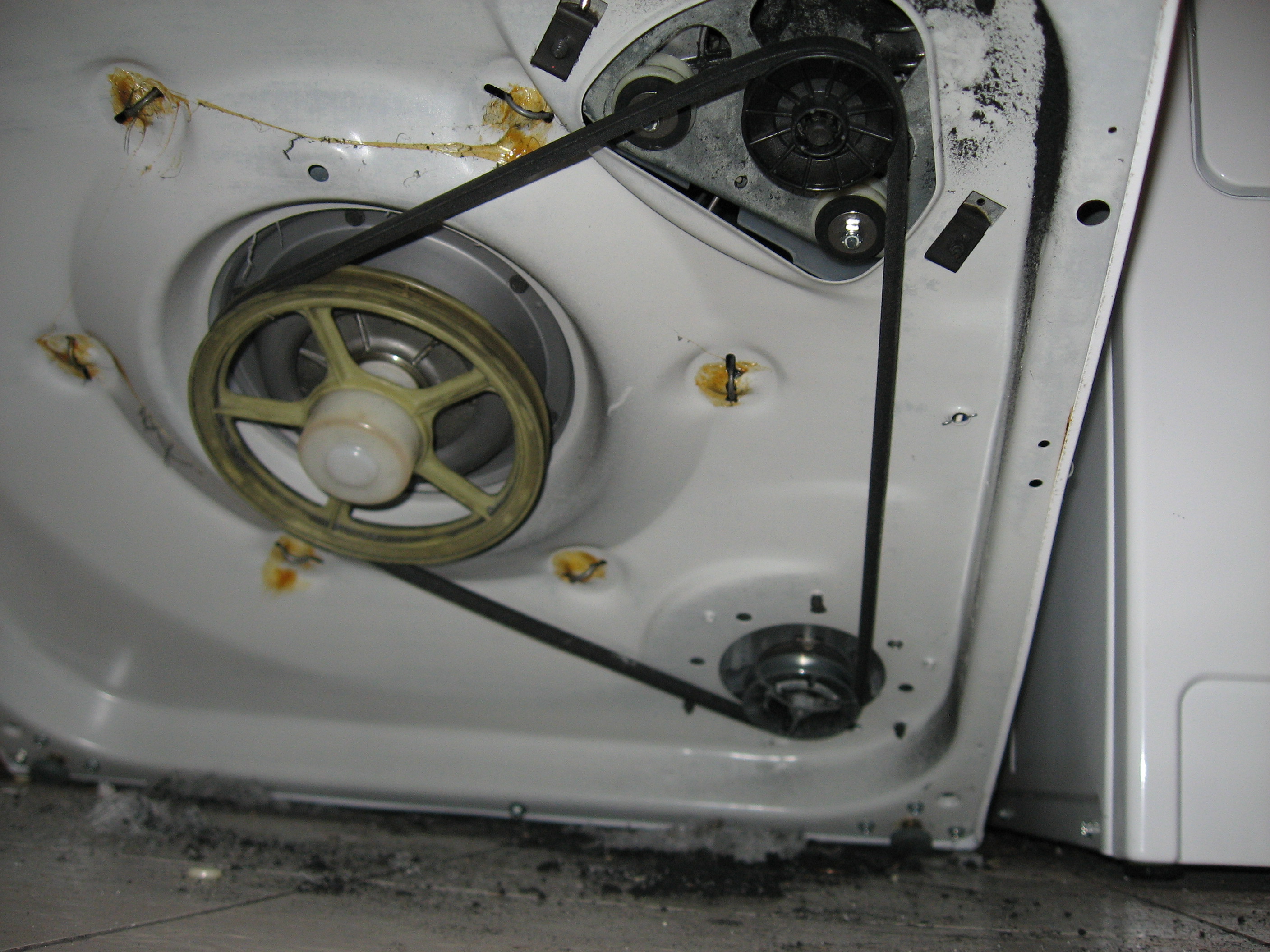

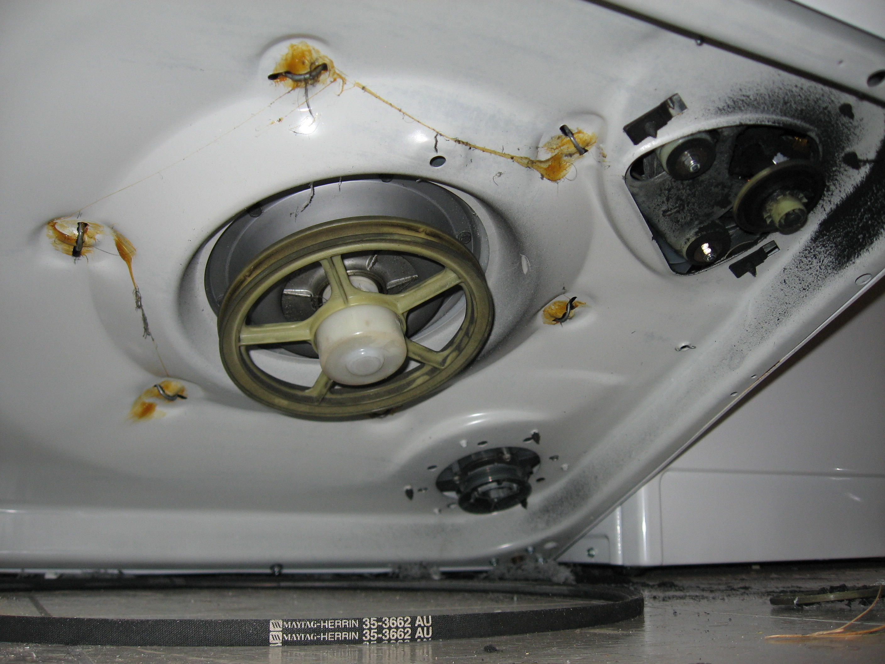

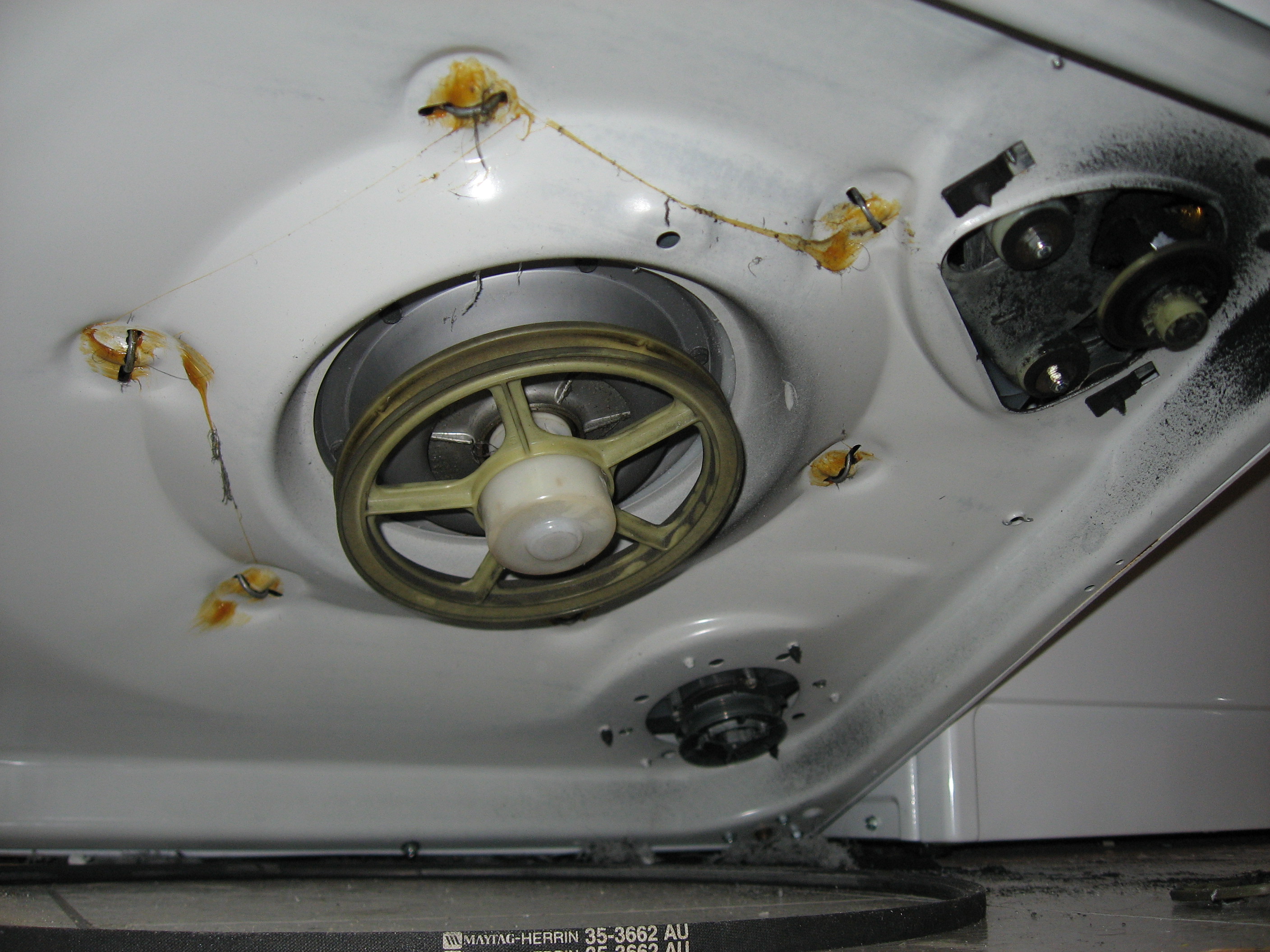

Washing machine failure the drum stopped turning I wonder what could be wrong. (check the pics)
I knew the belt was slipping because I would hear it squeak sometimes but I didn't think it was this bad. My guess is it was slipping and ate through the pulley on the drive motor. Washer isn't even that old I think we were over filling it tub.

Wow! I've never seen anything like that before! Something must have been out of alignment perhaps.
Anyway, repair looks straightforward enough: replace the dead pulley, and then check the belt tension and geometry afterwards.

You may already have this fixed, but you can rent a puller to remove a pulley. Mostly on that stuff, these days, the replacement is sold as an assembly with the bracket already attached. You get a pulley assembly, not just a pulley. That makes it much, much easier to fix and you don't need any special equipment to remove it. I'd recommend getting the replacement part before tearing it all apart so you know what exactly needs to be removed.
Jim

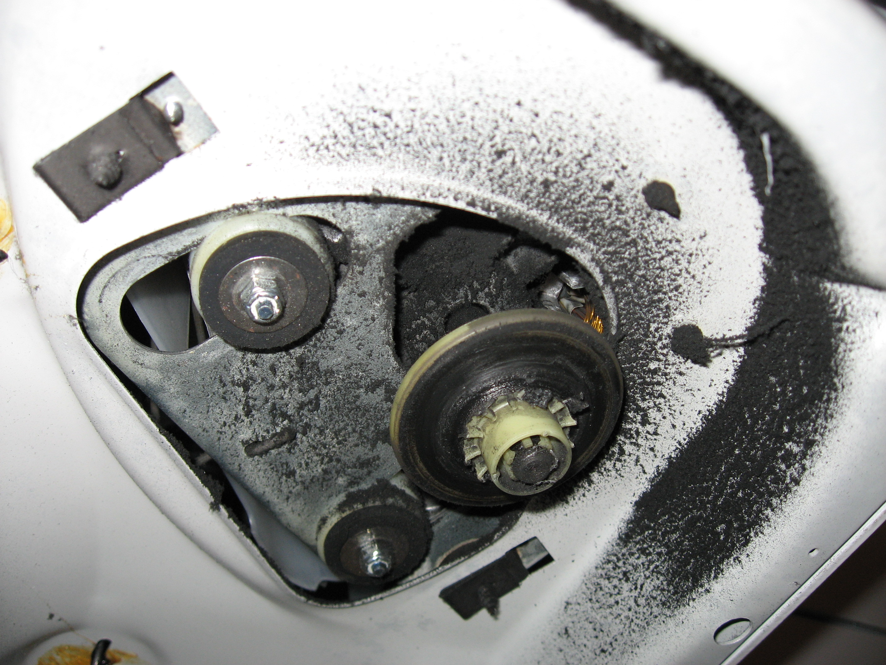

Edit: on closer inspection, it looks to me like the bearing seized on the pulley shaft, which is why there is so much buildup of belt material around that pulley (the pulley stopped turning smoothly and the belt slipped on it). That led to overheating and eventually the pulley broke. You may want to see how smoothly the remains of that pulley spins and make sure you don't need to replace the whole assembly the pulley drives (due to a bad bearing). That assembly looks like the motor...

The pulley that is broken is on the directly stuck on the end of the motor armature so I don't think there is a bearing there.
I think what happened is the drum got stuck which stopped the belt but the motor kept going. That shaved off the belt and ate through the pulley.
The motor does still operate so I hope I can get the old pulley off and a new one on there. A belt and pulley is 15 bucks and the motor with a pulley is 130.
I read a guy saying he breaks the old one off with a chisel and pounds on a new one.

OK, that makes sense. You can rent a pulley puller from an auto parts place for cheap. It's got two little arms (some have 3) that grab the pulley, then a screw in the middle which you turn and it pushes against the end of the motor shaft. It's pretty easy, you'll manage no problem.
Spin the pulley around and look for a set screw. If there's a set screw to lock the pulley to the shaft, it will pull off easier if you loosen this screw first. More likely, it uses a keyed shaft or a D-shaped shaft and just presses on.

I would agree, your drum probably seized, or became high friction, and the motor pully slipped on the belt and melted itself. It may point at the machine having been overloaded, or the drum bearings failing. The belts have a remarkably high destruction temperature, I once managed to do something similar with a cast aluminium pulley on a 4 horsepower petrol engine, and the pulley actually melted before the belt snapped!
Looking at the middle picture, the shaft has a groove machined around it near the end that small plastic tangs from the pulley snap into to stop it coming off. I would imagine that the shaft is keyed in some way to stop the pulley rotating on it. If you break or cut off those tangs, the pulley will come off much more easily. It may even pull off with hand pressure.

I just cut the pulley in half to get it off. The armature has a tapered and splined shaft holding it on. I think those tines are to keep you from pounding it too far down or give you an idea of where to stop pounding.
