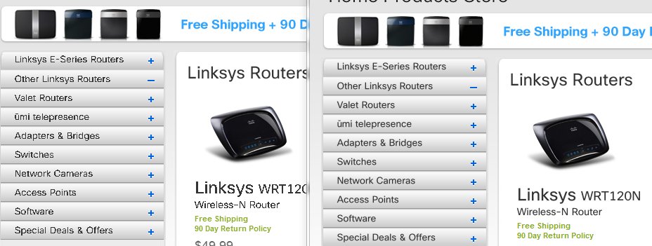

Now that your issue is fixed, Tony, is it okay if I ask about a web font rendering issue as well? I've noticed that on several sites, Chrome displays a certain type of font poorly in a way that FF and IE do not. I've attached a screenshot of what it looks like in Chrome versus FF. The only site I could remember that does this is some Cisco pages, but I've seen it on others. Is there a way to fix this for Chrome, my preferred browser?

Is yours an issue where small-point-size fonts get rendered without antialiasing?
Or maybe it's not the point size, maybe the rendering engine can't handle that particular combination of elements and layers, and it loses the AA in the process?
#344634 - 01/05/2011 14:22
Re: Weird HTML rendering thing - Cyrillic characters... Please help.
Haha, sorry, I thought you weren't using this thread anymore and that I could use it for a while  I hadn't noticed, but I think you're right about the antialiasing. Why would that happen, though? Is it something I'd be able to fix on my end?

I've got no idea, all I know is that when I zoom in on that page it looks like a font where the antialiasing just failed. I successfully fixed the web site just now, and it was funny. I made the repair to the .htaccess file to make the Cyrillic post come out correct, and that broke all the other places where I'd special-cased foreign characters (resumé, bodhrán ©, etc) and I had to fix all of those. I'd managed to find work-arounds for that stuff years ago without solving the root problem. Now that I'd solved the root problem, the other stuff stopped working.

Cisco is using cufon to do font rendering. It looks like there may be a known problem with Chrome and cufon.
