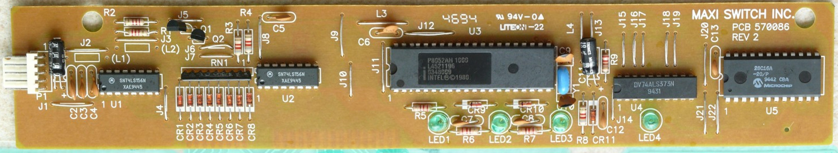

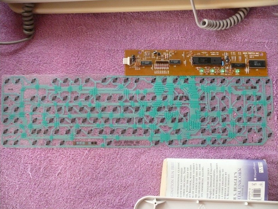

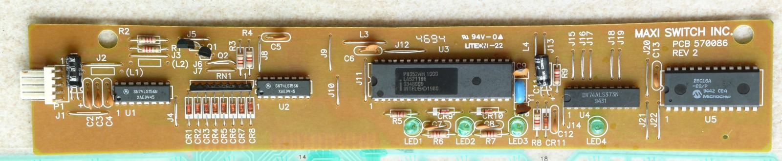

Mmm... can you photograph the electronics bits in more detail and more sharp focus?
Thanks

#346443 - 15/07/2011 14:48 Re: WTB: Gateway 2000 AnyKey keyboard [Re: mlord]
Yes. Attached is a low-res picture to give you the idea; I have emailed the high-res version to you directly.
#346444 - 15/07/2011 15:32 Re: WTB: Gateway 2000 AnyKey keyboard [Re: tanstaafl.]
Posts: 14526
Nice barrel distortion there. smile
emails sent.

#346451 - 15/07/2011 20:15 Re: WTB: Gateway 2000 AnyKey keyboard [Re: mlord]
It's an artifact produced by the stitching program -- it's actually three shots joined together. Don't know exactly what caused it, haven't had that happen before.

Ah. good old Pertinax (resin bonded paper). smile

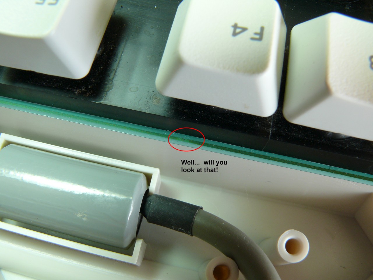

I have a spare AnyKey on hand, but it had been stored for the past several years in non-optimal conditions (temperatures reaching 125 degrees (F) or more on occasion) and when I brought it out, about half the keys wouldn't register any input
Now this is interesting... from a Wikipedia article:
The 2189014-00-211 Gateway AnyKey model contains a toroid on the inside, around the keyboard wires near the top middle of the keyboard, which might rub against the plastic membrane circuit board and cut the leftmost trace emerging from the left ribbon connector.
My spare keyboard is not the ...-211 model, but does have the toroid, so it got me to looking. I wonder if a thin strip of foil across that break would fix it? I am at a loss as to how to disassemble the keyboard to actually get at the mylar sheet with the tracings on it, but that one little spot is semi-accessible without taking it any further apart. Worth a try, I suppose.
Apparently that trace is just a marker around the perimeter of the mylar sheet, and does not perform any function other than decorative.
Before trying to bridge the broken trace, I plugged the keyboard back into the computer just to see how badly I had wrecked it by soaking it in soapy water (electronics and all) in my bathtub. To my absolute astonishment it is now 100% functional. The only problem that arose was a sticking "Alt" key, and a single drop of teflon lubricant fixed that. I now have two working AnyKeys, and three more coming in the mail. Is it possible to have too much of a good thing?
I guess these keyboards are pretty robust.

I have only found three things that worked to "repair" an AnyKey keyboard.
The Ctrl-Alt-SuspendMacro is the first line of defense. If that doesn't work, then disassemble the keyboard (difficult with your model) and clean the Mylar contact sheet, then re-seat and secure (with RTV silicone or with good quality packaging tape) the circuit board where it attaches to the Mylar sheet. The final, last-ditch desperation step (although in your case it will probably have to be the next thing you try) is soaking and "swishing around" the keyboard in warm, soapy water followed by a couple days of drying. That worked for me, but YMMV.
FWIW, both of my "new" replacement keyboards failed last month, in both cases the circuit boards had separated from the Mylar sheet. Some previous owner had repaired this problem before, with two small pieces of Scotch tape. I re-did the repair much more robustly, with full-length strips of clear packaging tape and to my delight, both keyboards subsequently worked perfectly. I'm typing this on one of them now.
If I had to guess, I would say that your current problem with the "N" and the "P" keys is caused by this separation, although there is some doubt because it is only the "N" and "P" keys that have failed. Each one of those circuit traces from the Mylar sheet to the circuit board (there are about a dozen of them IIRC) controls about 10 separate keys, odd that just two of them would fail. It might well be a mechanical problem, dirt on the contacts on the Mylar sheet for those two keys that might be fixed by non-disassembled washing.
About your only other solution would be a good thesaurus where you could look up alternative words without "N"s or "P"s in them... frown
