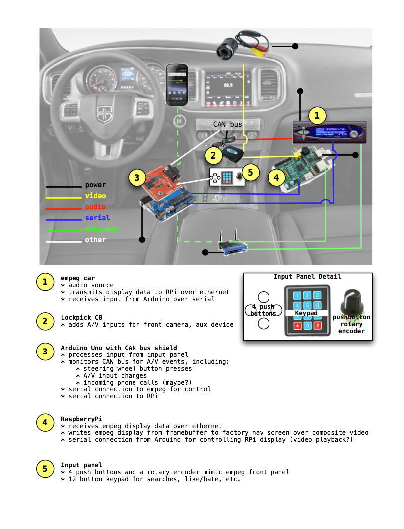

Since discovering this project, my install plans have gotten a bit simpler, but also a lot more complicated. Simpler in the sense that I might not have to worry about finding a physical location for the empeg display panel, but more complicated in that it involves adding some more components, doing some hardware hacking, and a lot of additional software bits. Attached is a rough picture of what I'm considering doing:  My first cut is going to be with the empeg as an aux-in device using the Lockpick C8 to add an auxiliary video input. The empeg display buffer will be sent to a RaspberryPi as per the project linked above, with the RPi pushing the empeg display (possibly along with some other stuff) to the aux video input on the Lockpick. For empeg input, I'm looking at hacking together a custom switch panel that will be placed in the cubbyhole underneath the climate controls. The input will be read by an Arduino board with a CAN bus shield, which will also monitor the CAN bus for relevant activities in the factory A/V system (so it pauses the empeg when switching to another input, responds to steering wheel remote presses for next/previous track, etc.) (I looked into trying to do all of the input and CAN stuff on the RPi so there are fewer moving parts, but CAN support on the RPi seems to be somewhere between totally absent and experimental at this point, whereas the Arduino CAN shield purports to be pretty much plug-and-play with a pretty robust set of library calls and some easy-to-follow example code.) Of course, with such an ambitious project, there's many a slip 'twixt the cup and the lip, so I'll probably do everything in stages, starting with getting the Lockpick installed and feeding in the empeg as an aux device. If I hit any dead ends, I can always try to go the "conventional" display extender route instead. I'll post updates here when/if I make any progress on any of this.
2012 Charger empeg install.png (10408 downloads)Description: Install diagram

I admire your determination and will enjoy watching your progress.
EDIT: Personal preference, but I would ditch the button panel and just use an empeg remote with an IR extender and the steering wheel buttons. Much cleaner. If you REALLY need to get to the buttons on the empeg, you could always pull over and get in the glove box.
In my Blazer, my empeg was installed in a low position that was hard to reach, and I used my remote all the time. I got very good at using it by feel alone without taking my eyes off the road.

I do suppose the IR extender route would be less work, but I always found navigating menus with the remote to be more awkward than using the front panel with its D-pad-esque button arrangement. I also tend to drop or lose the remote in my car. I could always mount it semi-permanently, but I think I'm going to at least play around with the input panel idea, even if it just turns out to be an educational project rather than anything practical.
Yeah, the other good thing about the Arduino CAN board that I didn't mention is that it's pretty cheap. I did run into that PCAN-USB module on the RPi forums, and once I saw how much it cost, I realized Arduino was the ticket for now.

Just a little bit of progress to report so far. I received my Arduino kit and some controls the other day, and put together a quick mock-up of the code to handle the control input and send it over the serial interface to the empeg. I've got the knob left/right/press and the keypad input working with some cheap controls that I won't be using in the final input panel (if I get that far.) Thinking about it more, I'm coming around to the notion that hard-wiring a Kenwood/RioCar remote will probably look lame, so I'm going to give that mini keypad a shot. I will still need to find some buttons small enough for it, or some sort of plastic membrane style thing to put over the switches, but assuming I can figure that out, that'll probably be a nicer looking install. Another option is to do my own matrix of square pushbuttons, which opens the possibility of using LED-illuminated buttons, but the ones I've found on Digikey and Mouser are all pretty pricey. With all of the inputs, I'm out of pins on the Arduino, so I'll have to do some muxing. It looks like this guy is a cheap and easy way to get as many as I'll need. For the input panel itself, I found a reference to this site in an old thread here, and it looks like getting a panel in anodized aluminum will run me somewhere in the $30-$40 range depending on how many drill holes/cutouts there are. Seems reasonable, but it's the kind of thing I'll really need to get right the first time, as they won't do proofs for a one-off project. I'll probably just be using wood and epoxy on the back of the input panel to mount the controls in, as a full enclosure would just end up being bulkier and would be hidden from view anyway. The CAN bus Arduino shield should be here early next week, and I look forward to playing with that to see how much control I can get over the factory system and Lockpick, which should also be here next week. I also ordered one of those quickconnect harness jobs so I don't have to hack up the factory or Lockpick harnesses.

A bit more forward progress. I got the CAN bus shield working, and though the libraries sample code are a bit lacking, I was able to do the basic "detect RPMs, accelerator pedal position, etc." thing over the OBD-II CAN bus connection. I'm probably going to have to do some proper library routines to make things manageable as I add more stuff, but it all seems doable.
I also received and installed the Lockpick last night. I'm hoping that it responds to CAN commands so I can make the task of switching inputs easier -- right now the only way to switch to its AUX A/V input (where the empeg display and sound will be going) is to hit the "Back" steering wheel button 4 times, then select the input from a menu. There's enough lag that this would be a real hassle. I was also hoping to be able to rig things so it switches away from the empeg input when calls come in, and without a dedicated CAN message I can send to the Lockpick, that's going to be difficult or impossible. If I can't find any dedicated commands, I'll have to settle for sending steering wheel presses. The Lockpick itself does some CAN mangling, so I'm thinking about monitoring the messages going into and out of it to see what it's doing for some ideas.
I have a Raspberry Pi arriving tomorrow, so I'll probably start playing around with that next. I'll need to check in with John to see if his code for writing to the RPi frame buffer is in good shape. Once I know how the RPi is going to fit in, the actual empeg install is next -- there's not enough room in my glove box for a sled, so I'm going to have to go the sledless route with Hijack's force car mode and/or force DC functions. For the time being, this rules out using the empeg as a head unit, but I think there are too many missing pieces for that now, anyway. Maybe some day.
