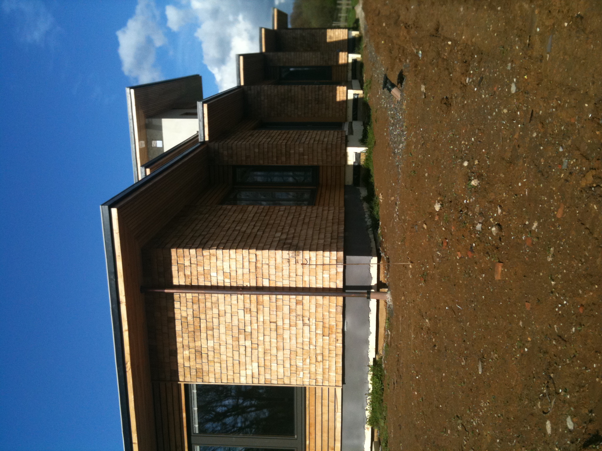

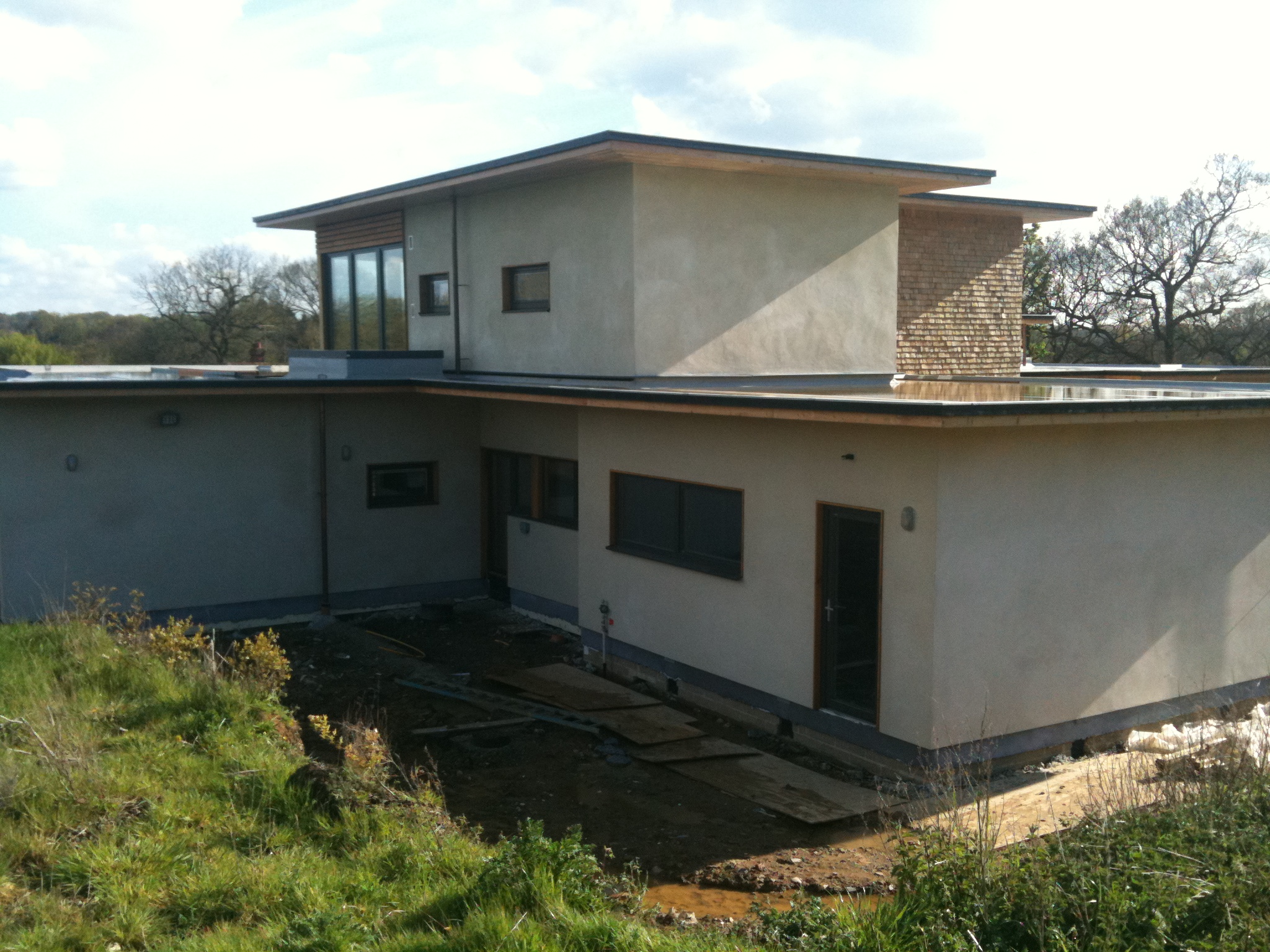

#355535 - 10/10/2012 10:21 New house pics
Posts: 1946
I did once say I'd post pics so here they are

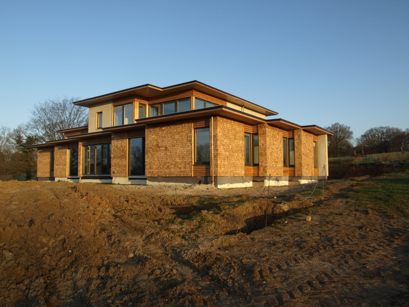

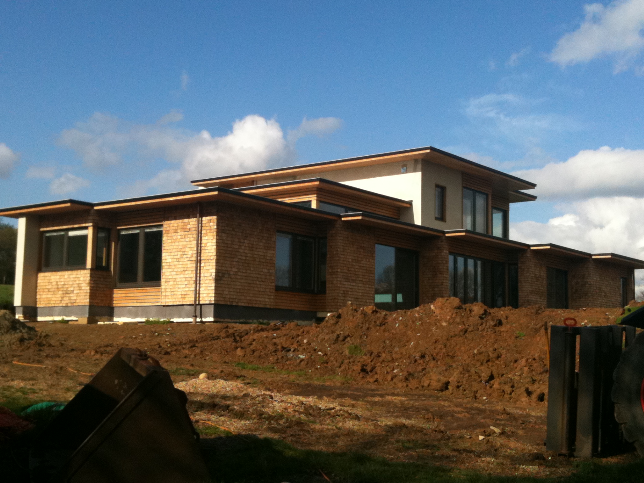

#355536 - 10/10/2012 10:22 Re: New house pics [Re: tahir]
Posts: 1946
Some more

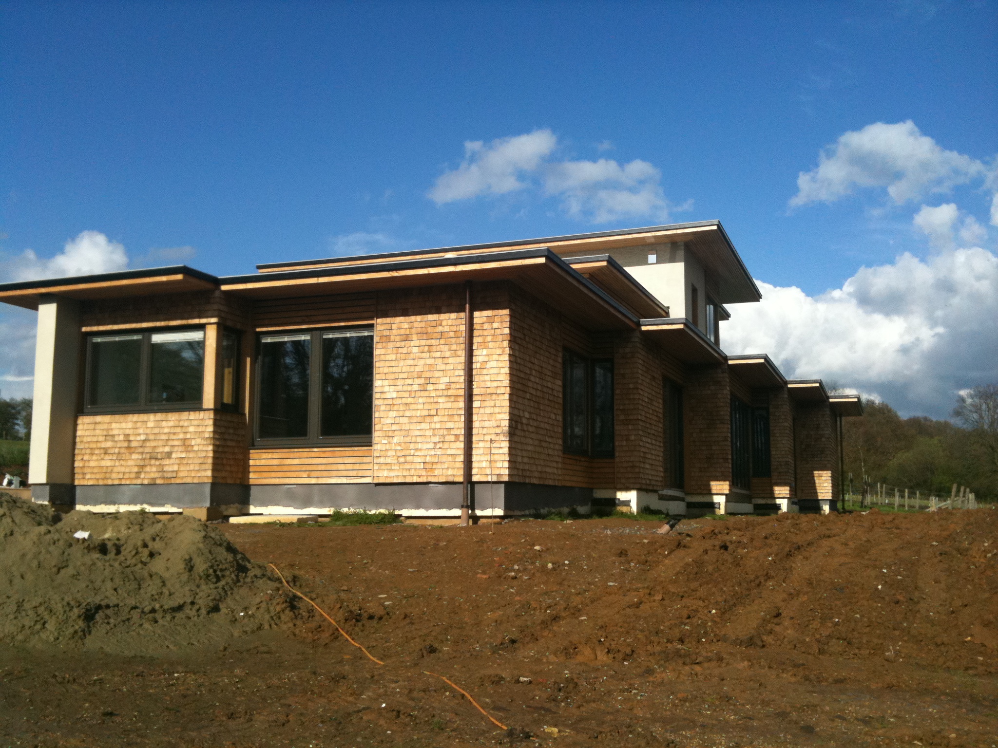

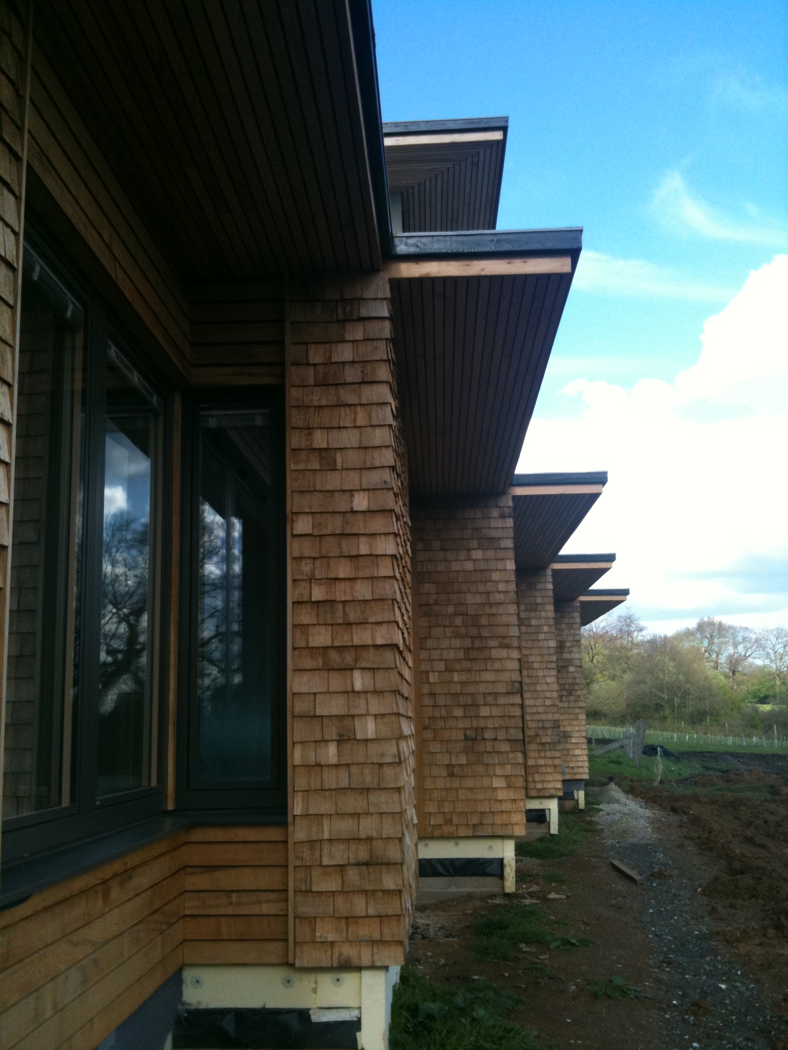

#355537 - 10/10/2012 10:24 Re: New house pics [Re: tahir]
Posts: 1946
And some more

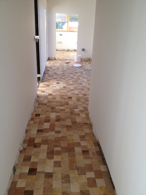

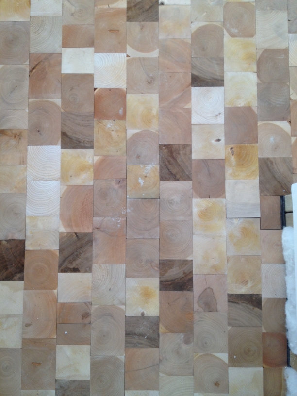

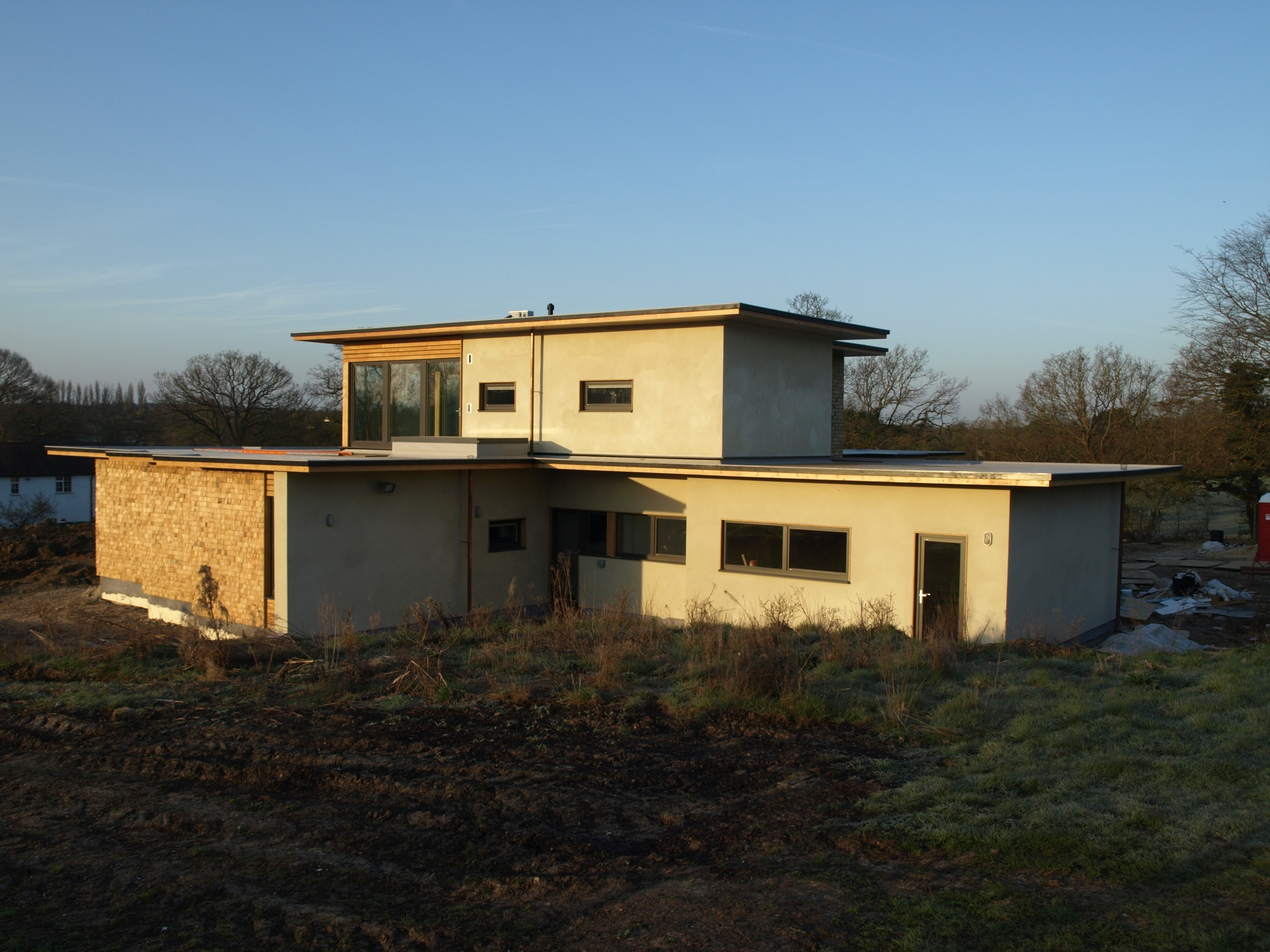

#355538 - 10/10/2012 10:25 Re: New house pics [Re: tahir]
Posts: 1946
Last lot, the flooring is end grain blocks of various species harvested on site.
#355540 - 10/10/2012 10:29 Re: New house pics [Re: tahir]
Nice! I really like the sides with the shingles. Sweetness. Congrats on the new place!
#355541 - 10/10/2012 10:41 Re: New house pics [Re: Dignan]
Posts: 1946
Thanks Matt, the shingles took ages to find locally, saw the guy fell the tree and everything

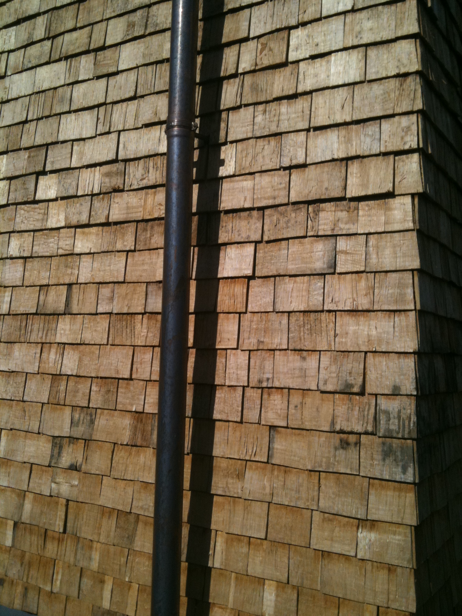

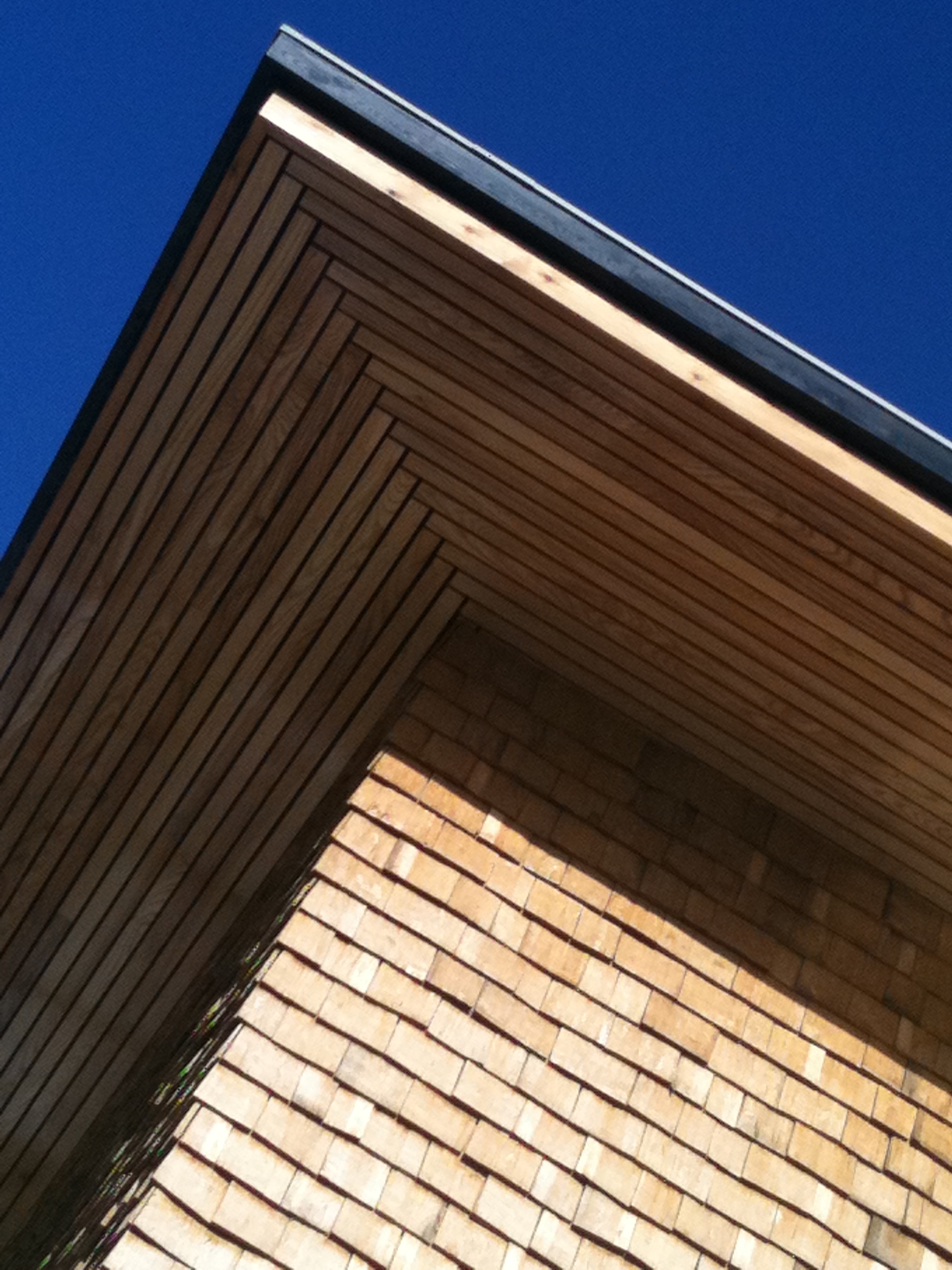

Love the end grain flooring, and the mix of clapboards with the shingles for the siding. The way the corners was done with the shingles is nice, labour intensive, but very nice. I assume they are cedar.
Is that a cast iron down spout? Also, the soffits, are those multiple ~2" wide strips with gaps in between them to provide for roof ventilation? Actually, that wouldn't make sense given that it is a flat roof... confused
#355547 - 10/10/2012 12:14 Re: New house pics [Re: Phoenix42]
Posts: 1946
The shingles are oak (traditional in Essex), clapboards chestnut, down spout is copper.
Soffits (ash) yes they are, and yes we do have ventilation beneath the roof, the visible roof is external to the insulated envelope of the house, it'll eventually be planted.

OK, it's almost a passive house, so needs very little in the way of heating. It's heavily insulated all the way round, in the case of the walls the construction is part of the insulation (40mm fibreboard externally, then 140mm I beam filled with warmcel, then 18mm OSB). The whole thing is extremely airtight, airflow is controlled via a whole house MVHR system. We have a small gas boiler running a very low temp underfloor heating system (cuts out at screed temp of 27C) and in one room (the posh one for mums and dads) we've got the lowest rated woodburner we could find (old parents like a visible heat source).
I don't know if we'll ever need to run the heating, it's been warmer in there since December with no heating than our existing house with heating on.

This house is in the UK. Almost no one in the UK has any form of A/C.
I notice it has big overhangs over the windows, presumably to shade them and reduce the need for cooling in the summer (such as it is here).
Yup, and the windows have integrated blinds as well, it's a 3 + 1 system so the blinds actually sit outside the insulated envelope, stopping the heat before it enters the building.

4) I really can't get my head around the building style. Don't get me wrong, I like the look personally, but it seems very inefficient for a passive house. For passive, best is to have a boring square or rectangular house with a normal roof (a 'compact' house). I find the shape of your house, with all the sections like the garage and the living room jumping 'out' (I don't know really how to put this, I hope you'll know what I mean) like they do really inefficient because they all are extra surface that is in contact with the air outside the house. All this extra surface inevitably means more loss of heat through the walls and roof. Naturally it's imperitive this should be avoided at all cost in a passive house. Flat roofs can be done, but also are more difficult to insulate. I can see you did the homework on your windows though ; small to no windows on the North side, most other windows in the South side of the house. Were this factors you took into account, but let the look of the house be decicive in the end? (I could understand that)
It was a VERY difficult house in terms of targeting passive house, too many corners, too much external wall to volume. The form was dictated by the floor plan, we wanted all of the house to be used, and for it to be flexible in it's accommodation.
We were aware that we were making things more difficult from a detailing point of view but there's not much point building your own house if you don't optimise your living space. One of the reasons there's more glazing than you'd expect to the N is that our kitchen is on the N of the building and we wanted to make full use of natural daylighting.
So if I understand correctly, the floor plan was pre-defined and you couldn't change that? Then I understand the choice you made. Because indeed, you want to use as much space as possible.
