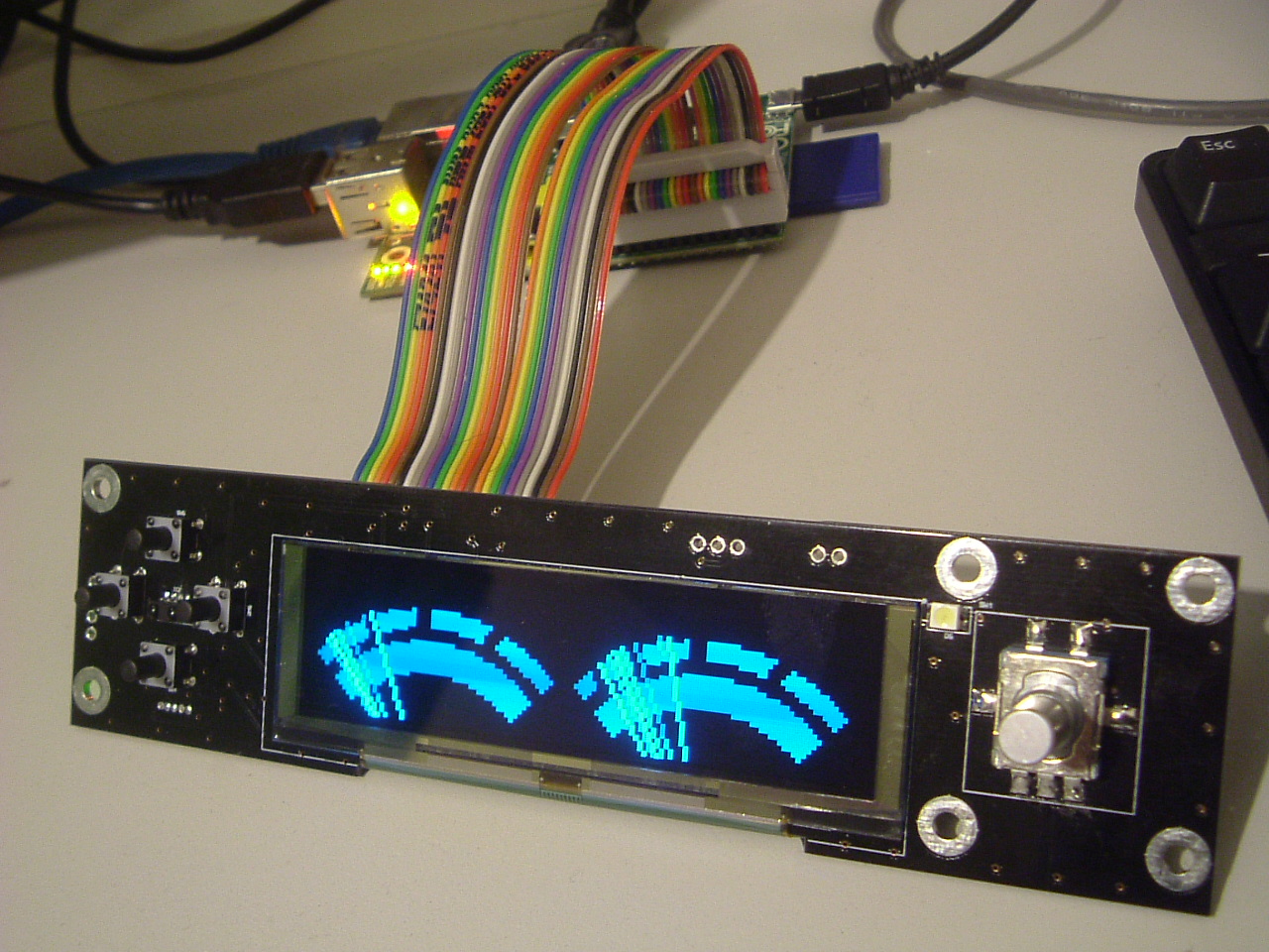

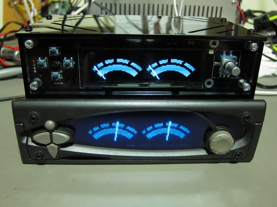

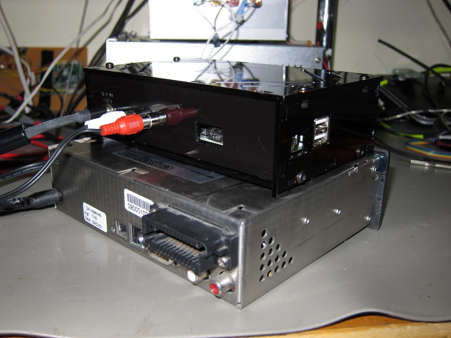

A couple of vidos to show the code in action. First one on a MK1 player.
The second video is a MK2 player, also demos slave mode with the master being a Raspberry Pi board.
http://youtu.be/c1wXFo_blmI
http://youtu.be/qs0bEXLIAek

>don't suppose there's much that's "special" about using a Raspberry Pi as the "Master", or is there?
Nothing special at all, you can use anything you like as a master:-) The empeg cant be an effective master simply because its fractionally too slow, works well as a slave though.
The player on platforms other than the empeg has no display of its own, it uses UDP to send display data and accept button push data from either a process on the same machine or stations on the LAN.
The script ./compile will build the player binary for/on most linux hosts. I've yet to try a Sparc (I do have one, I must dust it off, we use an Ultra 10 as a coffee table !) or MIPS but I have tried numerous PCs plus the Pi board and another generic Arm linux board :-)
Two display programs for Centro player are in the sources, "display_on_x11" is a scalable X11 128x32 display, display_on_framebuffer is similar but for raw framebuffer, both require 16 bit per pixel displays at the moment.
The master is a UDP broadcast source, it sends audio data (called audio plus in the sources) and display data as UDP streams, any number of slaves on the LAN can decode it. I pretty much guarantee it will only work on networks with real cables !
Master/Slave is network transparent, if both players are on the same LAN and in the same subnet you simple select mode->master on one and mode->slave on the other (or push the rotary encoder button to toggle between normal and slave mode on a player).
I must write some kind of manual or docs for this when I have time :-)
Almost forgot, "buttons_x11" gives a virtual set of buttons, both the display and buttons code will drive Centro player,or the original empeg player software if you use this code on the empeg:
http://www.jonshouse.co.uk/download/broadcastfb_proc.tar.gz
(binary in is in the tar, code for original player only Centro includes the functionality)
This is what it looks like from the linux desktop:
http://www.jonshouse.co.uk/display_on_x11.jpg

Wow! VERY nice! Thank you for all your efforts you've put into this!
I myself am looking very forward to this RPi 'desktop' solution.
Your welcome :-) I've always been an empeg fan. The project was a bit of a vanity project for me, i've bult some displays and gadgets but I needed the software to make them useful. The software is probably not feature complete from an empeg perspective.
RPi board with an SSD disk into the glove compartment, all controlled by a small touch screen. (or maybe my iPhone?)
Very much in theory here..... if you put a bog standard Pi board with a good DC/DC converter on it and a suitable USB wifi stick it would be possible to run the player application (and hostAP) with no head and use an Iphone (or tablet) to control it. I dont have any Iphone or similar front end available but it should not be a huge job to write one.
The important to thing to note is that my player software does not require a display at all, its nicer with one - but is not required. It all functions with UDP packets, the player is not aware of the front end. Practial upshoot is you can connect or disconnect a display/keys at any point (or have multiple displays or key inputs), the player continues regardless.
For anyone who wants to write a front end, specify -ptx <port> (for just display data) or -master (display and audio data) on the player command line. The UDP display packet is identical to an empeg framebuffer (I thought ahead here). Its 2048 bytes of two pixel per byte 2 bit data. An example (a little crude) of the display end is "display_on_framebuffer.c"
From memory format is XXPPXXPP for a byte, X unused PP two bits of pixel data.

A picture of some prototype dedicated hardware smile

Ooo. So am I right in guessing that prototype has an OLED screen? (based on the file name)
#358707 - 21/05/2013 18:28 Re: Empeg player software, a new generation [Re: drakino]
It's a 256x64 OLED panel, which although smaller (and much thinner) than the empeg VFD, has a visible display area almost exactly the same dimensions. Also 16 grey levels, unlike the VFD's five and half, rounded down to 4 wink
Jon's current software emulates the 128x32 2BPP display on the OLED display in a very convincing manner. The blue one also looks very much like the empeg display, but if anything is brighter.
It's driven by SPI from the raspberry pi expansion port, and also has the same button and rotary encoder layout as on the empeg, with a consumer IR receiver as well.

We got a prototype box sorted out for the Raspberry Pi based Centro player today. I personally think it looks quite nice!
#358897 - 05/06/2013 19:39 Re: Empeg player software, a new generation [Re: jonshouse]
And the back view.

That looks great! Good work guys.
#358908 - 08/06/2013 00:27 Re: Empeg player software, a new generation [Re: sein]
Beautiful

Over thye next week I will try and write up what has been done to date and what options are available.
At the moment the RPI will drive an O-LED display using a board from PCA and myself. It has an O-LED module, 4 buttons and consumer IR.
With software on the RPI board the display can either act as a remote for an existing empeg player (via ethernet) or work as a stand alone player itself.
I have parts for 10 display boards on order and will solder this lot together when it all arrives, I have 25 PCBs available. The front panel PIC microcontroller code is finised, all buttons and the IR works as it should.
The display board has a pinout that matches the RPI :
http://www.jonshouse.co.uk/rpi_displayboard_pinout.png
The board uses SPI to drive the display. The button presses are sent to the Pi via serial, the serial from the RPI to the display is just used to toggle the front panel LED on/off :-)
At the moment remote control of the existing empeg from the RPI display board is pretty simple, as it is from the larger LED units i've built. All these units with buttons can run Centro and/OR act as a remote display for an existing empeg.
http://www.youtube.com/watch?v=zHSGtInrsDY
Using a RPI board + display board as a head unit for the existing empeg is pretty easy (but not documented yet, I will do that !).
It would be possible to produce a shim board that goes between the RPI display board and existing empeg to duplicate the functionality of the front panel - it was not designed for this, but it would be possible. It would be better done as a new project though as board holes are not designed to lign up with the empeg metal work.
The RPI disply board was designed to fit into a custom case PCA designed and laser cut from perspex, thanks Patrick - nice job :-)
http://www.jonshouse.co.uk/centro/
This page has some (not great) pictures. Words pictures and video to follow soon. The prototype has been running on my desk here for days, all seems stable (well as stable as anything using the Raspberry Pi ... ho hum).
http://www.youtube.com/watch?v=a6VpvDC5Cs4&feature=youtu.be
Assembled Raspberry Pi player.
Jon

Assuming this means what I think it does, basically what we were postulating would be a great idea for a display extender for an existing empeg, has in fact already been done. Cool.
From the pics I see, the display board looks to be pretty thin, and roughly single-DIN sized. This would likely fit well where my clock currently is, which is where I would mount my empeg if I had the depth.
I assume that the raspi can be some reasonable distance from the board (10cm)? and the empeg itself can be Ethernet distance away, so that works (trunk mount).
Silly question, but can you show remote control of a standard (hijack'ed obviously) player? What does the boot sequence look like? What power dependencies are there (thinking "key on" in the car - does boot order matter? etc...)
What other specific hardware (ras pi, etc) is needed? I know, I know, you said you were writing it up... OK. Ill wait. Heck Im going on vacation for 2 weeks anyway. :-)
Yes, should work ok - its not screened cable so I would not push it with the length but 10cm is about the cable length I am using. It will suffer with a longer cable as the SPI data is running at about 30Mhz.
I had to find the original player hard disk and put it back in, but here you go :-)
http://www.youtube.com/watch?v=JRC3K52T3N8&feature=youtu.be
Empeg end looks unchanged, the RPI board end is very very boring - nothing happens until the process "display_on_oled" is started. The Pi is not aware of the SPI display at all, only the process I wrote is drving it. In theory it could be made a linux framebuffer device but I have no plans to do that.
Not in the sligtest. You need to give the RPI and player a static IP address you also need to tell the RPI end the IP of the EMPEG unit, after that you can power on/off each end at will, order does not matter. A hub is not required, I have tested with a crossover ethernet cable and it seems to work fine.
You need this lot :
1) Raspberry Pi (B) board (either revision, not included)
2) The O-LED display and button board (included in kit)
3) 12v to 5v Buck converter (included in kit)
4) Ribbon cable to connect Pi to display board (included in kit)
5) 4GB or bigger SD card for Pi board (not included)
6) Case (not decided yet !)
7) Cross over ethernet cable (not included)
8) Some software (not all released yet, but will be soon) :-)
So far I have yet to test the Pi kit in a car. I will do this but I want to wait until I have put a few more units together before I start trying to blow one up !
I also need to make the IR proxy work with the original player. The decoded IR codes match so in theory this should be simple enough.... cant seem to make this work at the moment though. Writing 4 byte IR codes to /proc/empeg_ir is ignored by the original player ?
Jon
Edited by jonshouse (26/06/2013 14:02)

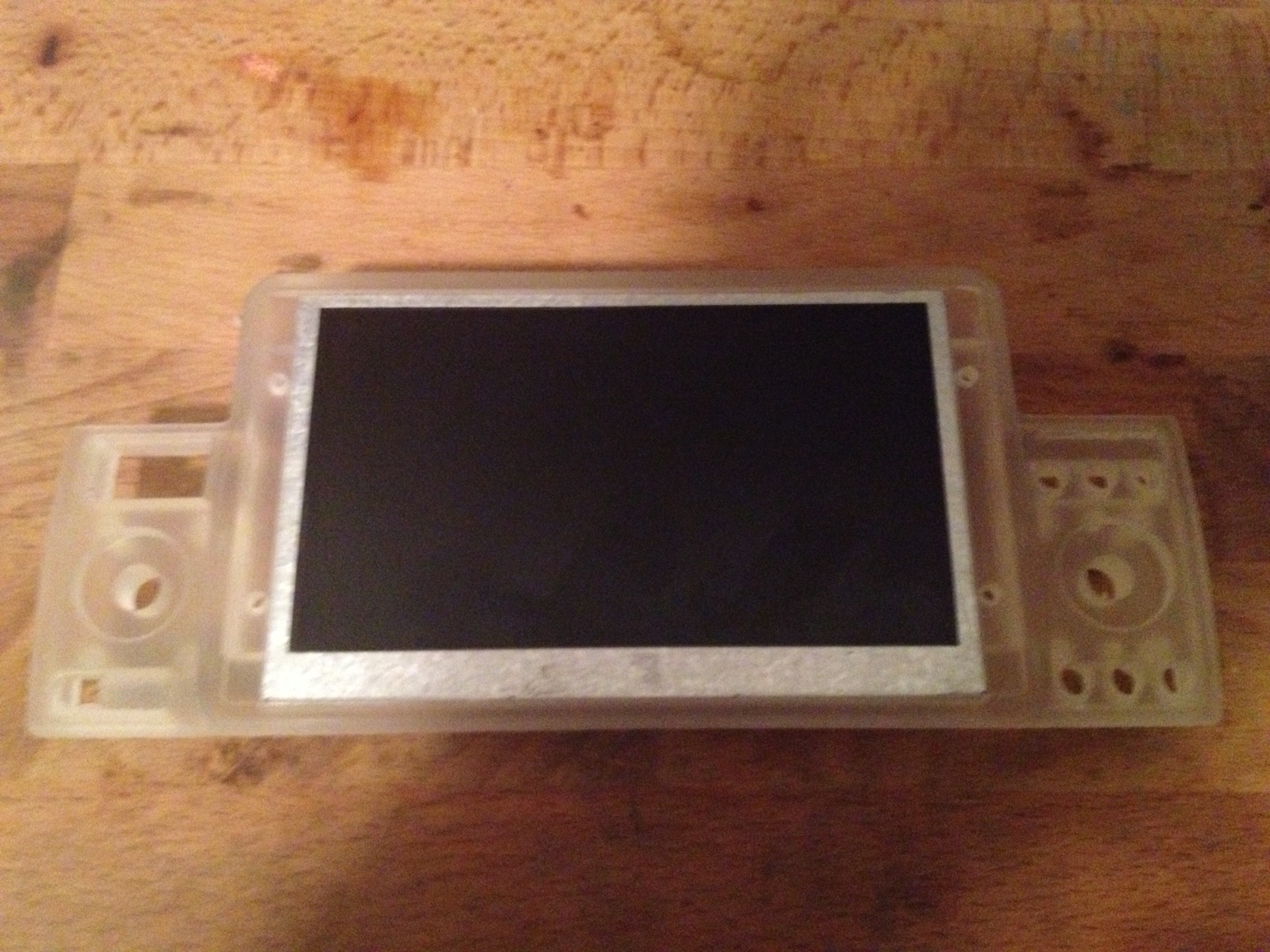

I 3D printed the faceplate. The housing itself will just be bent sheet metal or aluminum. The things I don't have figured out are the exact mounting of everything within the housing itself. Using a lot of right angle cables currently to make it even remotely packagable.
Here is a pic of the screen mounted in the faceplate before painting. Also a viewable eDrawings file
I just got a working version of the software running it all last week. It is going to be a necessity really to leave the Pi on all the time. The boot time takes less time than bringing up the logitech media server and being able to play locally stored files.
I haven't had time the past week to finish assembling the hardware. The button mounting is causing some issues and would probably be easier if I just made a PCB.
Ok, not bad :-) Should look good painted, gloss black ?
Yes, I do that in my software. The plan in the longer term is to clock the processor at a much lower rate when "powered off" to save some watts. I yet to investigate how to do this.
What I have done in the past is to mark up a bit of PCB material with insulating tape then drop it into the etcher. The insulating tape stops of the etch quite nicely. If you dont have access to a small mill then this can be a good way of making a one off PCB if the detial is very low (IE just some buttons).
Keep ip the good work, please post some updates when its more complete.
