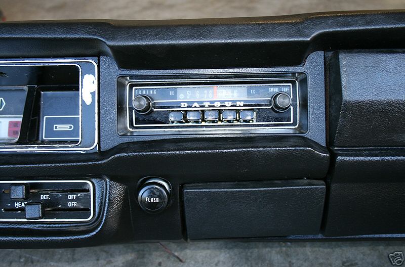

I'm making a custom faceplate out of acrylic for my empeg to make it look like a classic radio for my Datsun 510 (bakelite knobs with chrome inlays, etc)
In order to get the design right, I need accurate (better than I can get with a camera) locations of the screw holes, two-function button/knob, screen, and IR sensor.
Does anyone have either technical drawings of the display board, or know where I can get them? I have AutoCad, Sketchup, GIMP, and Adobe software.
-joe

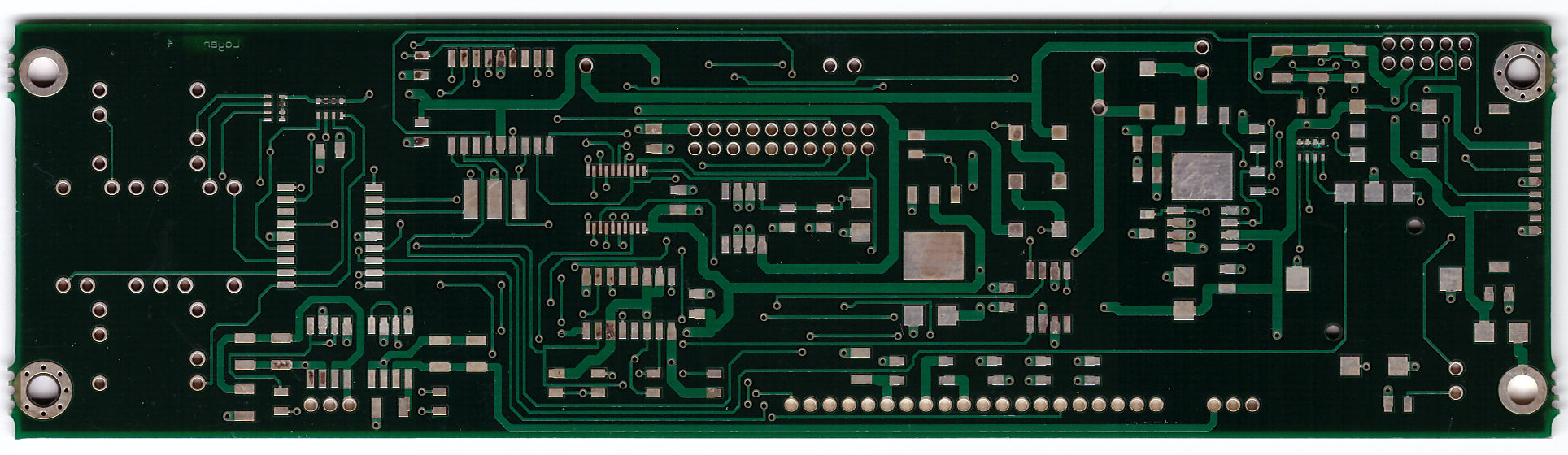

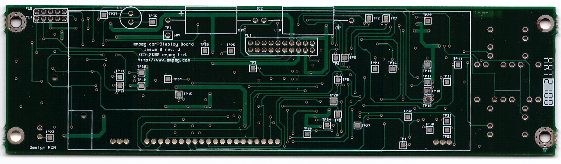

#359646 - 09/09/2013 11:16 Re: Display Board Technical Drawings? [Re: Joe Gorman]
Posts: 14537
These may provide a decent starting point.
The scans were done at 300x300dpi, so each pixel in the images represents exactly 1/300th of an inch.
(Edit: fixed orientation and naming of original uploads)
Description: Front of empeg Mk2 display board.
Description: Rear of empeg Mk2 display board.

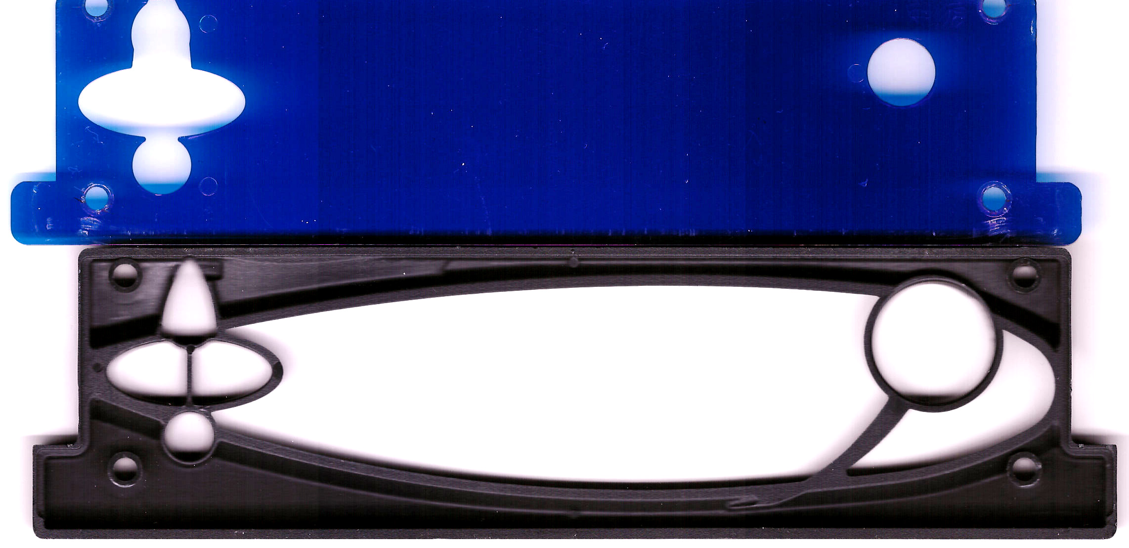

#359648 - 09/09/2013 15:16 Re: Display Board Technical Drawings? [Re: mlord]
One could also try scanning the backside of the fascia on a flatbed scanner, in the same fashion.

#359653 - 09/09/2013 20:38 Re: Display Board Technical Drawings? [Re: tfabris]
Posts: 14537
Description: Backside of fascia, 300x300dpi.
#359679 - 12/09/2013 20:03 Re: Display Board Technical Drawings? [Re: Joe Gorman]
Attached is a 2D DXF file of the top and bottom layers of the last version of the Mk2A display board. It should be exactly 1 to 1.
issue 9R2 empeg display board 2d.dxf (528 downloads)
#359680 - 12/09/2013 20:09 Re: Display Board Technical Drawings? [Re: Joe Gorman]
Here's one with the silk screens, which will be more useful.
issue 9R2 empeg display board 2d with silks.dxf (546 downloads)
