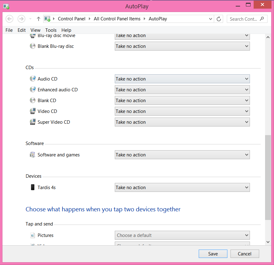

You didn't say this in your post, but, have the system's autoplay settings been modified? (Control Panel, Auto Play.)
On my computer, the iPhone gets its own entry in that screen, see the attached screen shot. Is that set to something good, like "open folder to view files"?

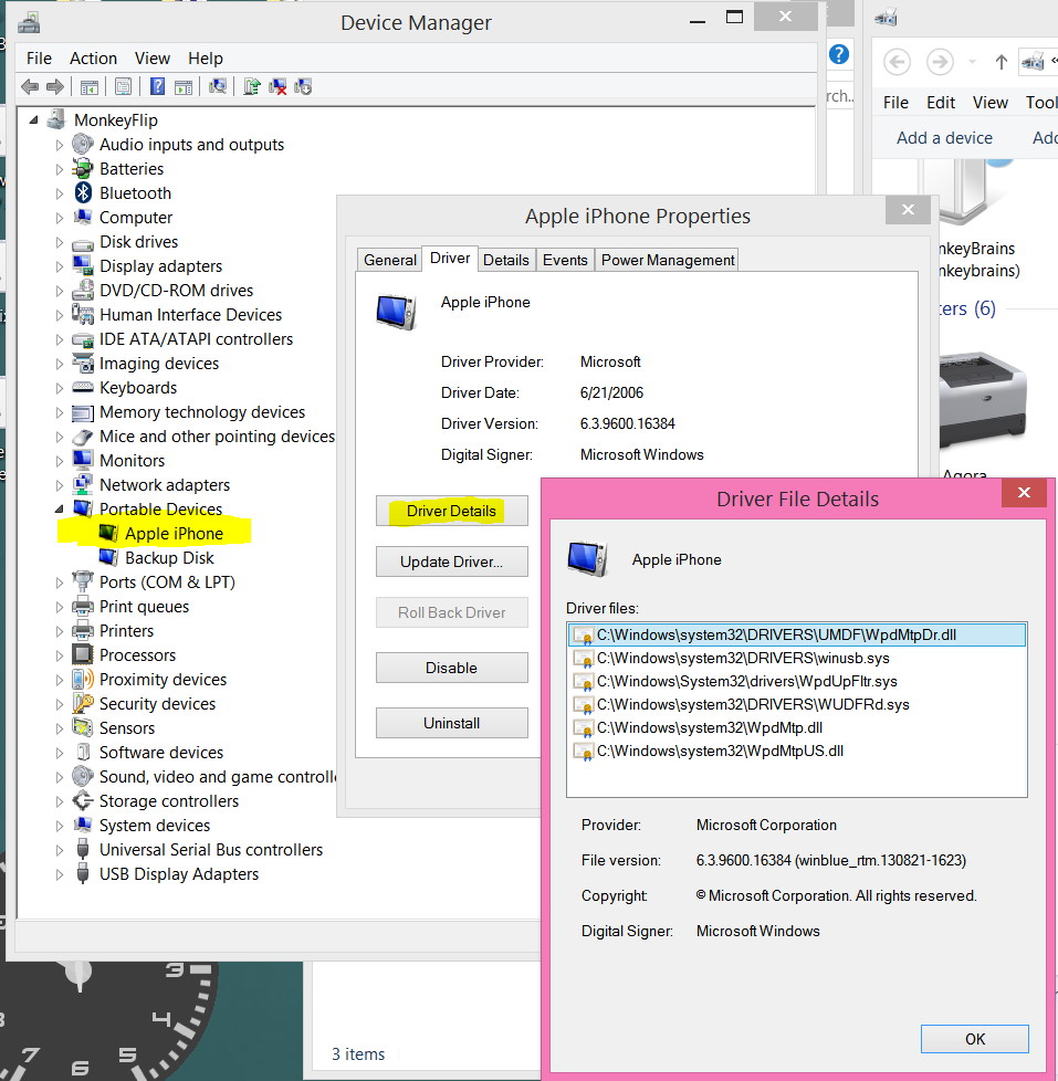

When plugging in the iPhone, does it show up as a Little Yellow Boo Boo Icon in the device manager?
I spent quite a while on that screen. No, nothing has been altered on there. This is actually a brand new Windows 7 installation, only about two weeks old.
The "Devices" section remains completely empty when the iPhone is plugged in.

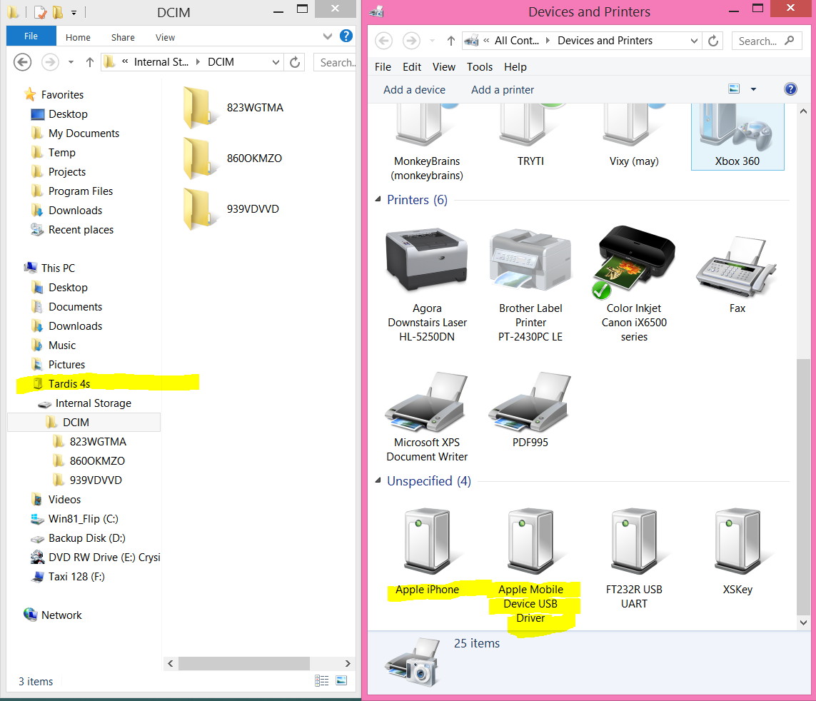

That's one odd aspect to this. I don't believe I got the little yellow icon, but the device did show up in the "Unspecified Devices" section of "Devices and Printers" (image below, though I can't remember which of those two unspecified devices it shows up as - only one of those two). In Device Manager, the only entry for the iPhone is the Apple USB Mobile Device or whatever.
I've heard that for most people, when they plug in their iPhone it shows in the left-hand side of the explorer window and you can go in and browse the photos and videos (I guess it's using MTP or something?). That's the part I can't get to work, I guess...

Correct, the part you can't get to work is the part where the photos folder shows up as a camera drive in Windows Explorer. Attached are screen shots of what mine shows up like in Windows. I'm betting yours is missing something compared to these.
