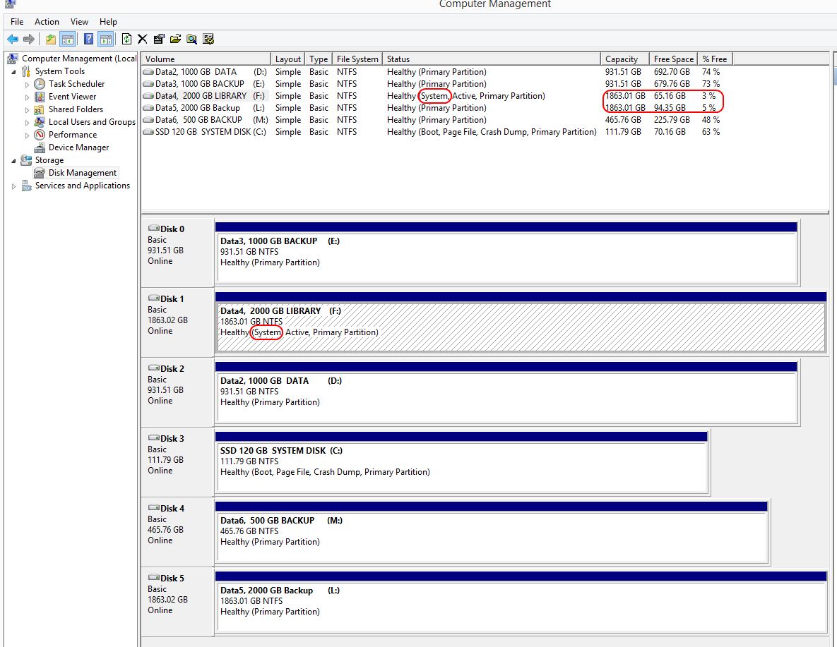

I have six hard drives in my system - four internal, and two external that are only powered up occasionally for backups.
My F:> drive is a two-terabyte internal drive that is backed up to my identical external L:> drive. F:> is somehow listed as a system drive. It is entirely data, containing nothing but a few audio books. (Few = 3877 books, 1769 gigabytes. smile )
Because it is shown as a system drive, it seems to be using up 29GB more space than the L:> drive, and when I run backups it throws errors trying to back up a very few files that apparently are involved in this "system" business. Not a great problem, just annoying.
What do I need to do to convince the computer that the F:> drive is not a system drive?

#361819 - 28/05/2014 18:43 Re: Disk Management Question [Re: tanstaafl.]
Is it possible one of the following is in the internal drive:
MBR
BOOT directory
bootmgr file
pagefile.sys file
What is in the drive root if you issue the "dir /a" command?

#361821 - 28/05/2014 22:02 Re: Disk Management Question [Re: Taym]
MBR
BOOT directory
bootmgr file
pagefile.sys file
and also
hiberfil.sys
pagefile.sys
swapfile.sys
Recovery (dir)
F:\dir /a:
LIBRARY
System Volume Information
and that's it.
There was a bootmgr file, and another boot-related file, but they are gone now. I spent an hour and a half with the computer at the computer store today and they were able, with considerable effort and a bit of risk (possibility of having to format the C:> drive and reinstall Windows) change the F:> drive from "System, Active..." to just plain "Healthy Primary Partition" like all the other data drives.
hiberfil.sys, pagefile.sys, swapfile.sys are all on the C:> drive and have been all along.
I disabled hibernation and got rid of the hiberfil.sys file, picked up 5GB of space on my SSD, and am working on moving the pagefile.sys and swapfile.sys files over to my D:> drive. I know it can be done, but so far the instructions I have found have been confusing.
After getting rid of the "System, Active" parameters on the F:> drive, I formatted it and as I type this am restoring it from backup. 1.72 TB takes a long time...
But that brings up another question. After a fresh format on the F:> drive, I immediately checked filespace, and somewhat to my surprise there was 237MB shown as "Used Space". Windows Explorer showed nothing on that drive other than the empty System Volume Information file. Now, that's a big improvement over the 31.4 GB that used to be hiding from me, but I AM a bit curious as to what's eating that 237 MB.

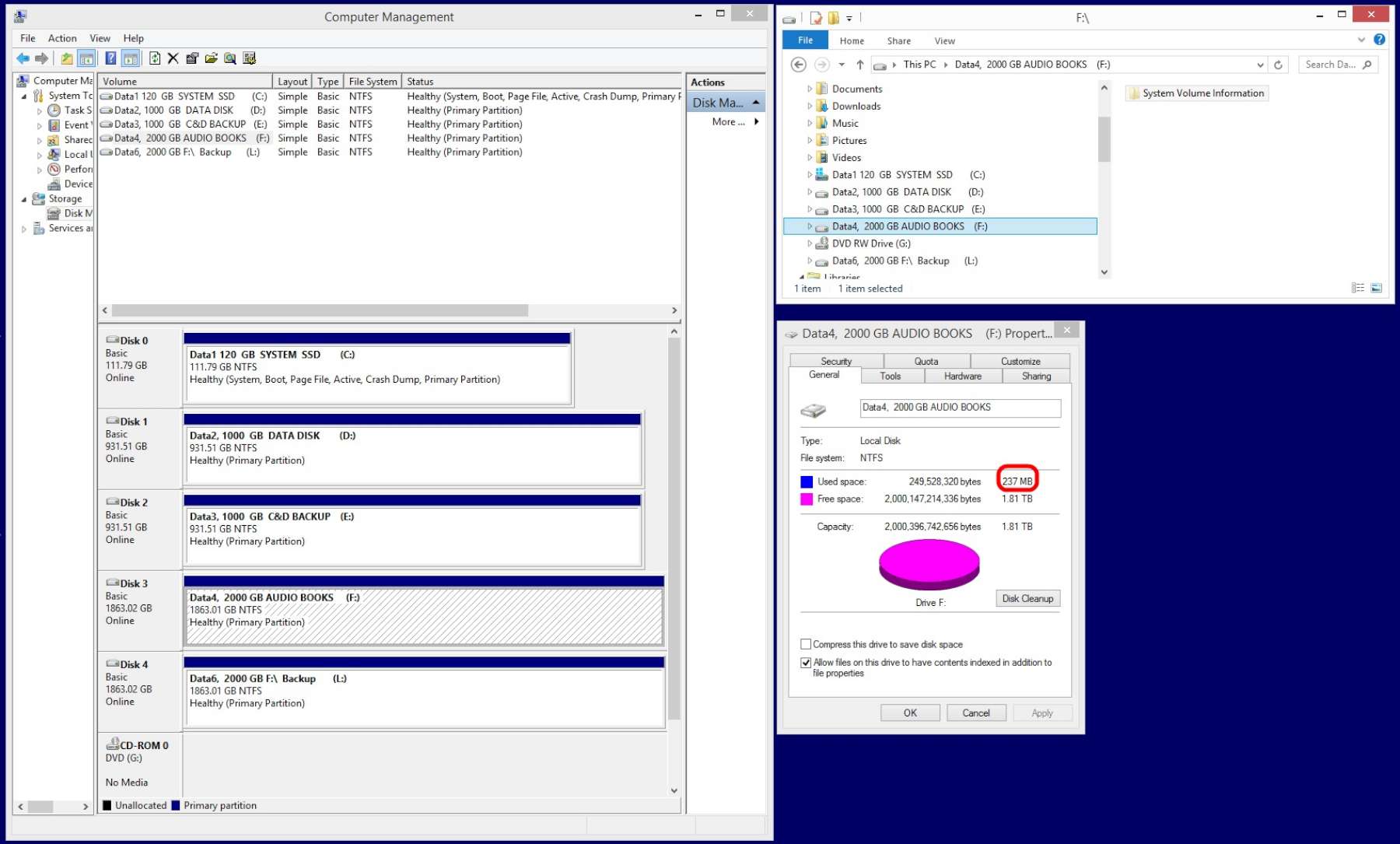

I bet wear leveling is why my fragmentation map looks like the attached.
Since there is virtually no penalty in reading fragmented sectors vs contiguous sectors in an SSD, defragging is counter-productive.
And now, for something completely different... I saved the screenshot below with my graphics editor, "Paint.Net", whose default save format is .png. Then I realized I should save it as a .jpg to get reduced file size, and did so. To my surprise, the lossy .jpg turned out to be considerably larger (7x bigger) than the lossless .png.
Odd.
