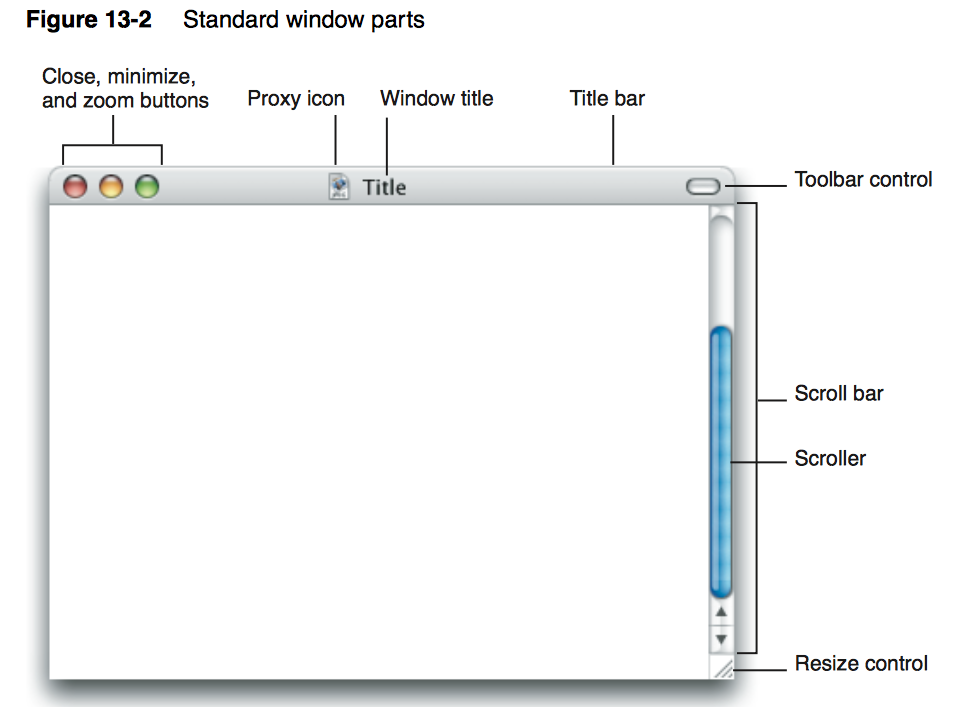

https://developer.apple.com/library/mac/...000957-CH33-SW1
Currently called "Transient resize controls" as OS X has gotten rid of the fixed point to resize a window. Before it was called simply "resize control". This screenshot is from the OS X 10.4 Human Interface Guidelines (HIG).
