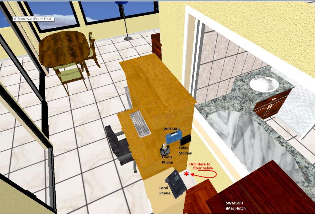

Without a rather thorough 3D model of the structure
As you can see, there is no easy way to place the primary router so that it could illuminate both residences without stringing cables along the floor and through the air in a most unsightly manner. Should I wish to remain married, this would not be optimal. smile
The first picture shows the current setup with the repeater in place out on the deck of the lower unit.
Mark has made a suggestion that I at first dismissed as impractical, but then after thinking about it, would appear to be a workable solution.
With some effort (I'll have to hire it done, I don't have a hammer drill and an 18" masonry bit) I can drill a 1/2" hole through my floor and into the bedroom ceiling of the room below. I could then run an Ethernet cable down to the second router which would mount on the ceiling. Mark says that instead of being a repeater, the second router would be a simple Access Point, with double the throughput of the current repeater setup. The hole would be quite unobtrusive and SWMBO concurs that it would be OK to "mutilate" the house to that small extent.
One small difficulty will be securing the router to the ceiling. I'll probably end up doing something crude, like pop-rivet aluminum strips to the feet of the router, protruding an inch or so out past the sides, so that when the router is mounted upside down on the ceiling I can run screws through the strips into anchors in the ceiling. Maybe paint the router and the strips to match the ceiling.
Uh-oh! I have to get power to the router as well. Can I run the power cord right along the Ethernet cable without causing interference?
So far this looks like my best solution. I can keep using my G-Class routers and replace them one at a time when they finally quit, configuration is much simpler and straightforward, enough so that even I can manage it, only one wireless network will be required, and overall performance will be better.

With a half-inch hole, I don't know if the RJ45 plugs will fit through the hole or not
I measured. 12mm, or .47 inches. Three hundredths of an inch to spare, and if I know Victor (my contractor) his masonry bit will be bent enough that the hole will actually come out closer to 9/16ths then half an inch. smile
One caveat for drilling: apart from steel, what else is embedded in that concrete floor? Any pipes, wires?
Not where we'll be drilling. The steel... just hope we miss it.

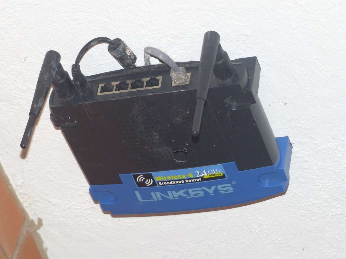

One small difficulty will be securing the router to the ceiling...

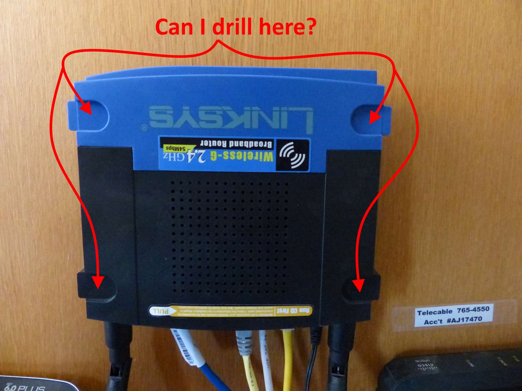

Some routers have keyhole style mounting holes on the underside, which can hold the unit to the ceiling of the holes are carefully located and the screws are just the right size to provide a snug fit, and screwed in until they just barely allow the slots to fit over the screws and slide into position.
If you choose this method, I can provide a tip for getting the drilled hole locations fairly precise without any measuring.
There are purpose made ceiling mounts, this one fits the compact Apple Airport Express router.
[video:youtube]http://youtu.be/cWLjo9yPFKc[/video]

Okay, just tried it through a 3.5" thick chunk of wood. A 1/2" hole will NOT pass an RJ-45 connector at all. A 9/16" hole will pass one, but it is a close enough fit to make it very difficult.
No problem at all with just the ethernet cabling and then a DC-power cord from a WRT54GL.

Have any of you ever taken apart a WRT54GL router? It would simplify my installation somewhat if I could drill through the mounting feet of the router and just run the screws directly into the ceiling, but I don't want to go stirring up bits of electronics with my drill bit. The mounting feet are indented at the top and project out the bottom, so that multiple routers can be stacked on on top of another, but are not hollow all the way through.
What are the chances that I could fun a 1/8" or 3/16" drill bit through them?
#366016 - 19/02/2016 22:03 Re: Router advice wanted [Re: tanstaafl.]
From this image, I'd guess no:
Three out of the four would hit circuit board. You know, the UniFi AP's come with a real nice mounting kit... wink
#366017 - 19/02/2016 22:15 Re: Router advice wanted [Re: tanstaafl.]
Yes, you can drill there, but only in the outmost edge of each of the four pod/feet things. The rubbery bits can be pried out with a knife/screwdriver first, and then it is safe to drill only outside of the "curved" edges of the router body.
If you want better access, open it up. Scary the first time, but here's how:
The blue/purple front detaches from the dark main body of the router. There are no screws (unless yours is old enough to have them under those rubber pads you removed above). Instead, just firmly grab one of the two back "feet" in one hand, the corresponding front "foot" from the same side of the router in the other hand, and pull hard/quickly. The front will snap apart from the main body, revealing the innards.
It helps to slice through the "do not tamper" sticker beforehand. smile
Looks like about 1/4" max space for drilling, on my v1.1 WRT54GL.
Mark

The secondary router will be mounted upside down on the ceiling, right over the doorway between the bedroom and the kitchen/dining room, so hopefully the signal will propagate through both rooms.
Now what I need to do is find the proper inverter software to turn the data right side up because it will be coming out upside-down from the router mounted on the ceiling. Haven't been able to find it by Googling... smile smile

No! You just peel the stickers off and put them on the other way. crazy
