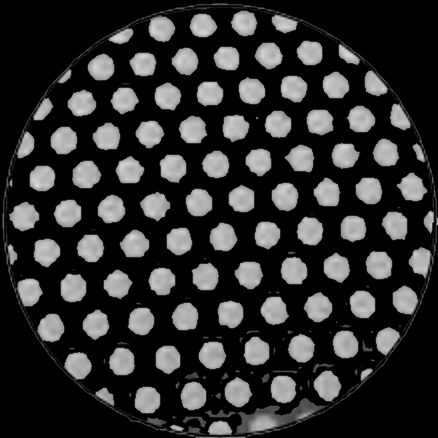

... because I am impatient and I do not own (yet) snips, as a temporary solution I decided to - reinstall the 12mm fan - make some small holes, approximatiely in a circle, on the side panel, by using a regular drill with metal bits (which I do own). Side panel has been in place for 1 hr and temps are 34 C 36 C Also, i can't hear anthing. Pretty good

... and so I have to take that back. Not good. Temp increased up to 42/44, so the few holes I made are not sufficient.
Would it be ok to use a 10cm hole saw (which I do have) to create a 10cm hole, and then enlarge it to 12 by using snips, once I get them and practice using them?

Would it be ok to use a 10cm hole saw (which I do have) to create a 10cm hole, and then enlarge it to 12 by using snips, once I get them and practice using them? Or alternatively, take a 6mm drill bit and make a lot of small holes in a nice symmetrical round pattern. tanstaafl.

Yes, that is an option too Doug. The ones i made are already larger than 6 and pretty random, though, so i'll probably resort cutting a big round hole somehow...
