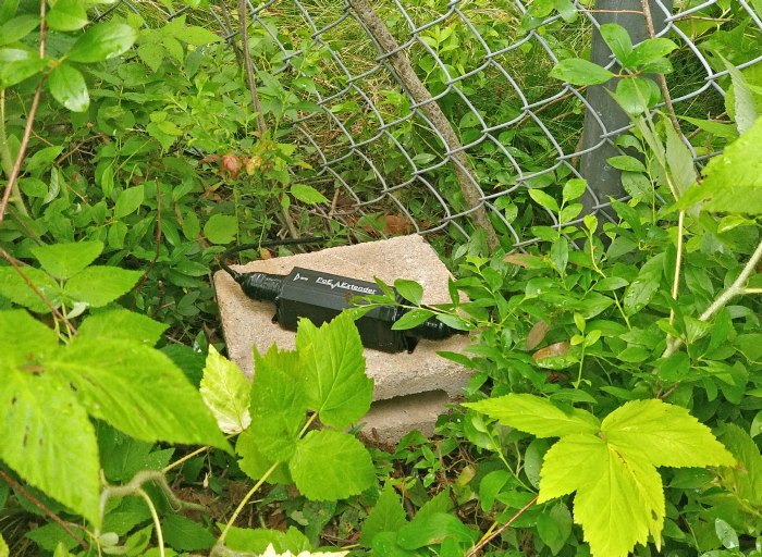

#373391 - 20/07/2021 14:01 Re: Ethernet extender? [Re: mlord]
Posts: 14537

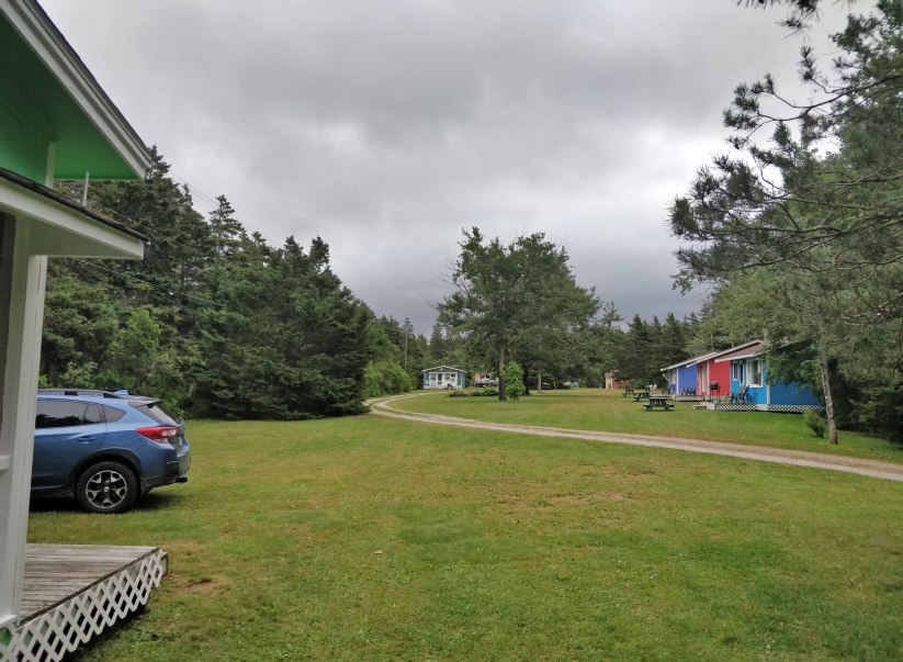

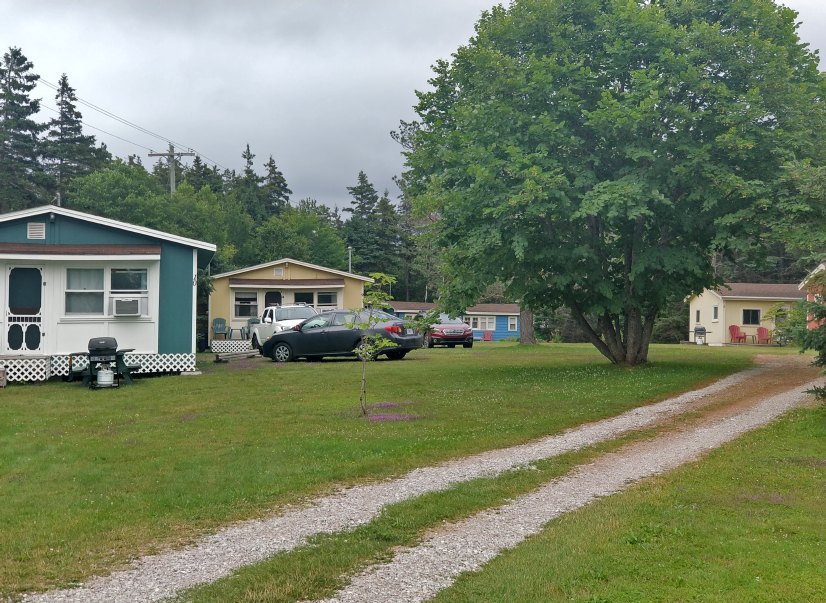

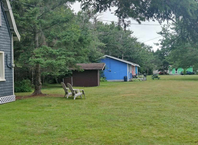

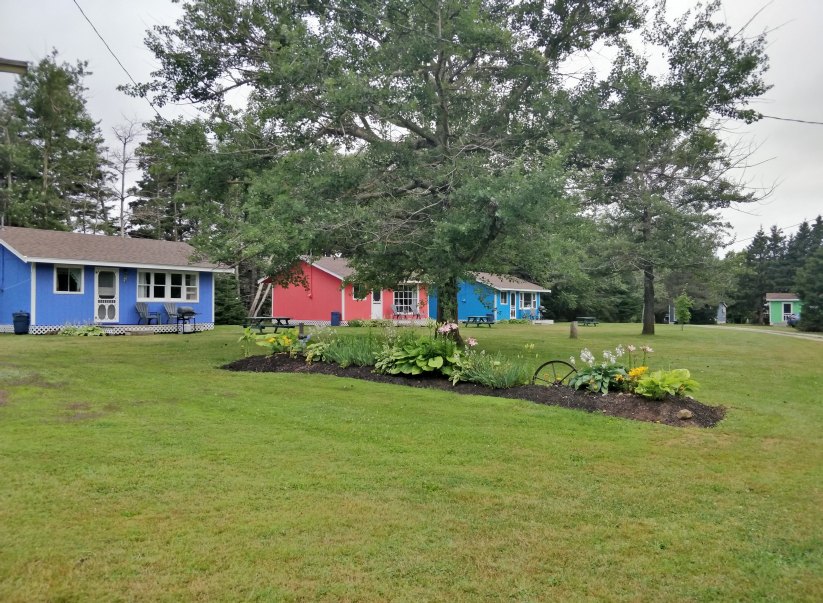

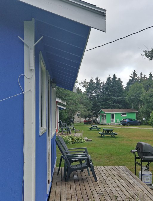

It all went well. The PoE extender got installed near the midpoint of the 220m run from the main router out to the far end of the property, and the Access Point (AP) out there is perfectly happy, serving five of the 12 cottages, and covering most of the property.
We moved the second ethernet run just a bit further, about 120m from the router, and the second AP is happily providing very fast speeds across the middle of the property, and covering most of it.
There were a couple of slow zones though, due to the placement of cottages (walls) and trees, so those got boosted with a third AP at the entrance end of the field. For various reasons it was decided not to run ethernet to the third AP, so instead it is simply meshing with the second (midway) AP, with an 866mbit/sec airlink from it!
Every room in every cottage has at least 30mbit/sec results on SpeedTest, and most of them are between 50mbit and 800mbit/sec. The internet source is 1gbit (both ways) Fibre at the office/entrance.
Everything working and happy. Rain in the forecast for later in the week, so we'll reassess and make antenna tweaks should the need arise. Uploading some photos here for general amusement!
Description: View down to the far end from my cottage.
Description: Ethernet Extender along the left edge of the field/fence.
Description: A lot more cottages at the far end, mostly served from the 220m run to the yellow cottage.
Description: The AP is on the right-hand corner of that yellow cottage.
Description: Looking back down towards the entrance area. Second AP is on the blue cottage, third mesh AP is on the distant lime green one.
Description: Another view of the middle cottages.. AP #2 at near left corner of the Blue one.

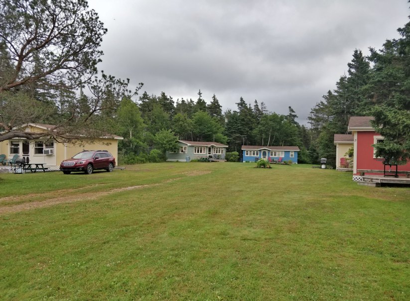

More Pix.
Description: The middle AP #2, showing view down to the fully wireless/mesh AP #3 at left edge of the (my) lime green cottage.

#373402 - 23/07/2021 17:18 Re: Ethernet extender? [Re: mlord]
Posts: 14537
It rained. A LOT. smile
And.. the long 220m run stopped working. Completely.
Today we pulled the cable segments out of the bushes for inspection. Racoons had chewed the cabling in two places, exposing conductors, and probably surprising the heck out of the racoons (24/48V on the tongue?).
Cut away the damaged bits, added inline couplers, and taped it all up again. A-OK for now. My buddy is thinking about how to protect it better (burying is not an option for various excuses).
Edited by mlord (23/07/2021 20:13)
#373403 - 23/07/2021 17:24 Re: Ethernet extender? [Re: mlord]
They supposedly make cable sheaths infused with stuff that mammals don't like to chew. Dunno if they work or not.
#373404 - 23/07/2021 18:45 Re: Ethernet extender? [Re: mlord]
Posts: 811
… Raccoons had chewed the cabling in two places, exposing conductors, and probably surprising the heck out of the raccoons (24/48V on the tongue?).
Sleeving the CAT cable inside armour sheathing would provide mechanical protection.
I do not know what this Small Bore Stainless Steel Flexible Conduit costs but it looks rather tough to chew into.
This Techflex® Rodent Resistant Braided Cable Sleeving makes some interesting claims.
#373405 - 23/07/2021 20:17 Re: Ethernet extender? [Re: mlord]
Posts: 14537
My suggestion was a cheap 200' coil of 3/4" black poly water tubing, commonly used for outdoor water runs to sprinkler systems, cottage wells, etc..
The two chewed bits were very near the two cottages on that side, with the racoons inspecting the outside (secured) garbage bins next to each cottage. So even perhaps just a plank of wood covering the cable near the bins might do the trick.
There's also a chain link fence there, so another thing that might work is to cable-tie the cat5e up a metre or so off of the ground along that run. More sun exposure, but above most ground rodents and stuff.
#373406 - 23/07/2021 21:02 Re: Ethernet extender? [Re: mlord]
Posts: 811
Run the CAT cable (perhaps also inside the poly irrigation tubing) inside the top or bottom horizontal rail pipe of the fence?
