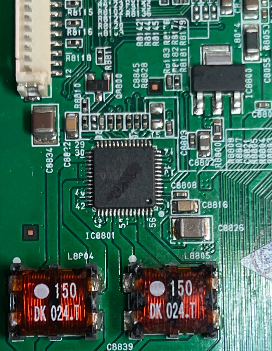

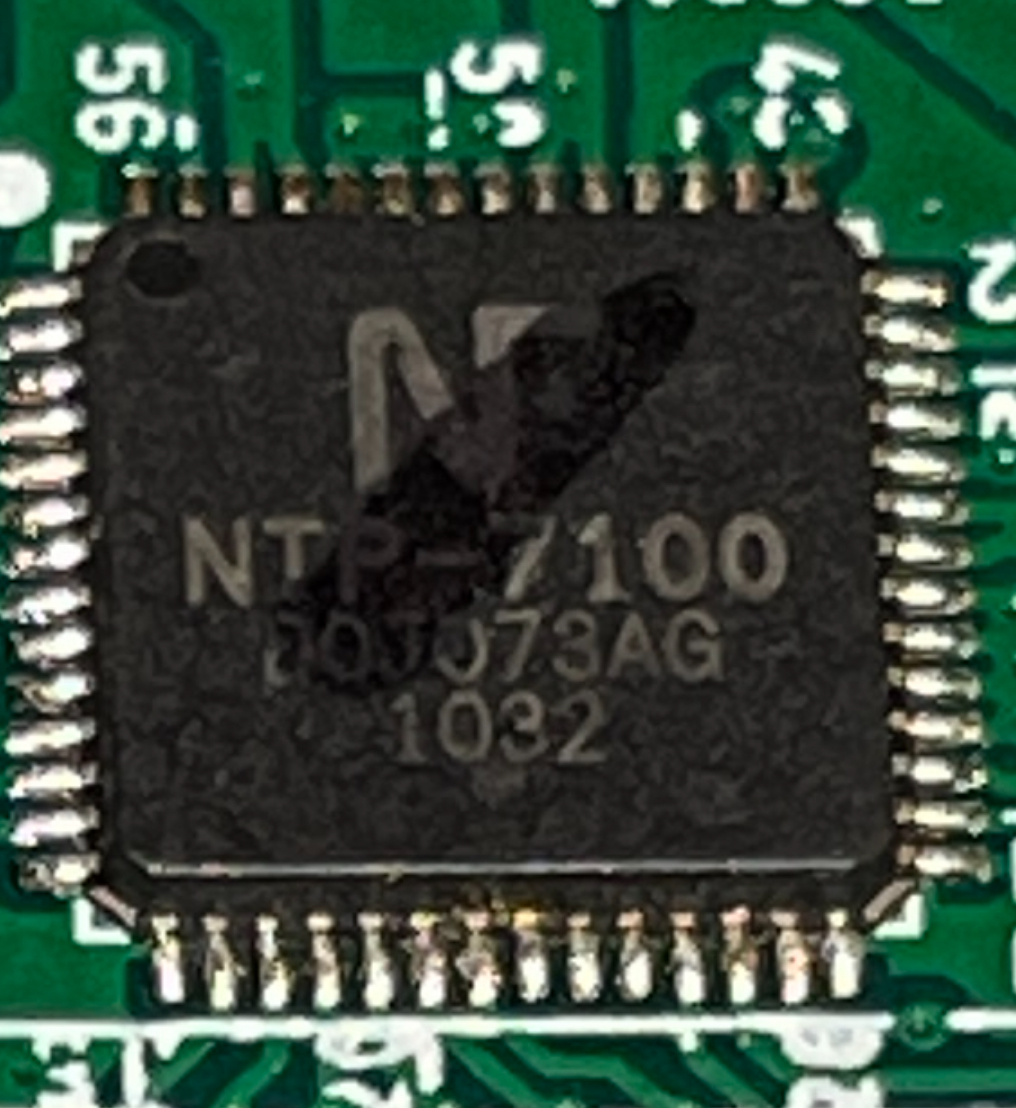

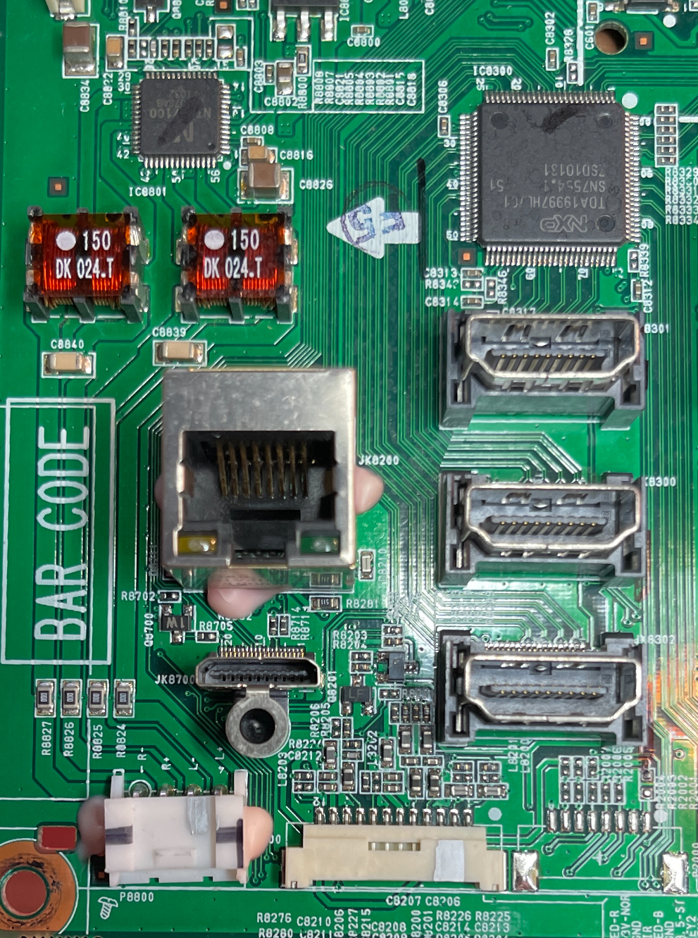

Non-functional board:
IMG_4886.jpg - NTP-7100 DOJ073AG 1032 - Audio amplifier chip.
IMG_4885.jpg - 150 DK 024.T - Possibly audio amplifier transformers?
IMG_4884.jpg - Wide shot: Audio amplifier at top, transformers below, connector to TV speakers at bottom.

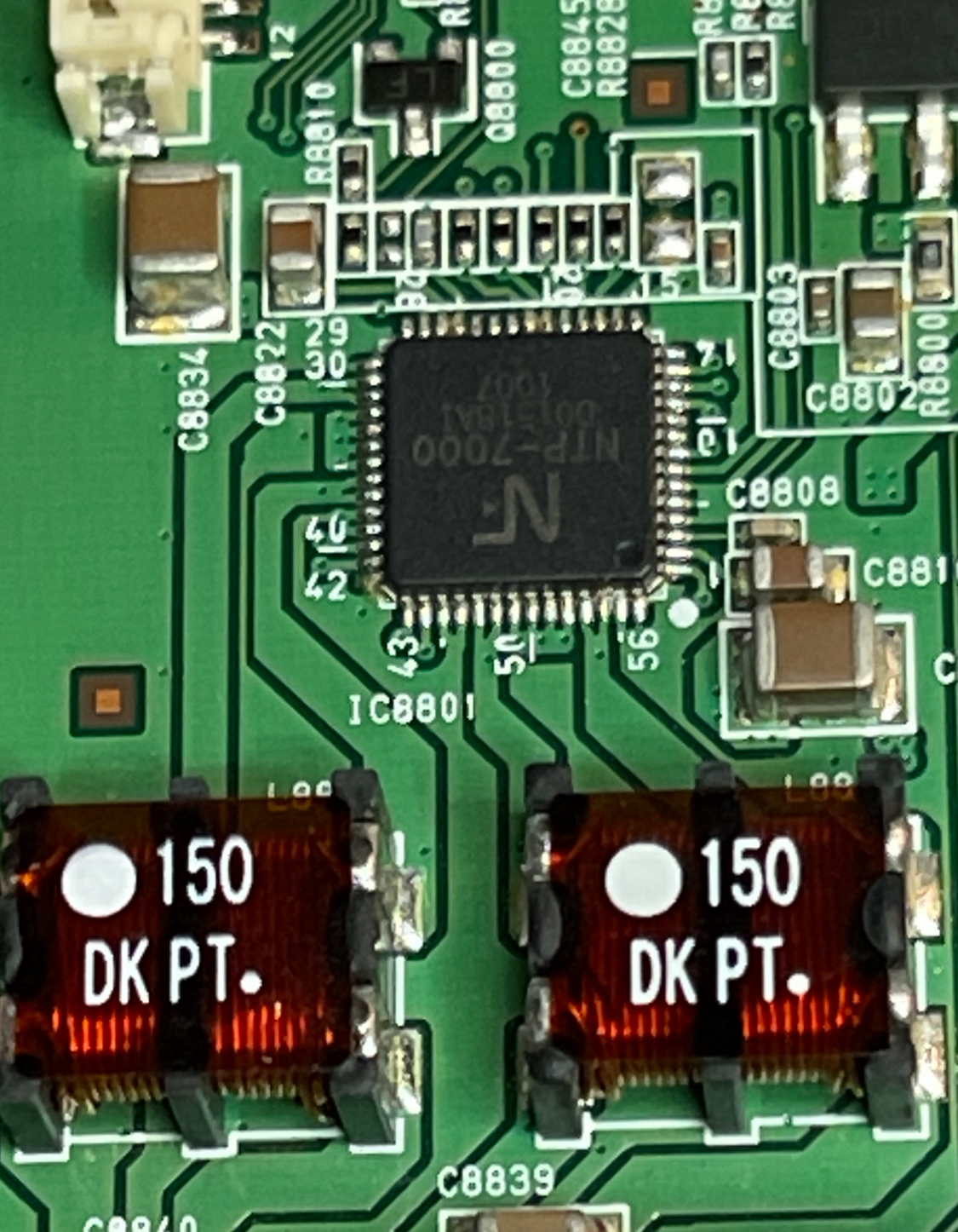

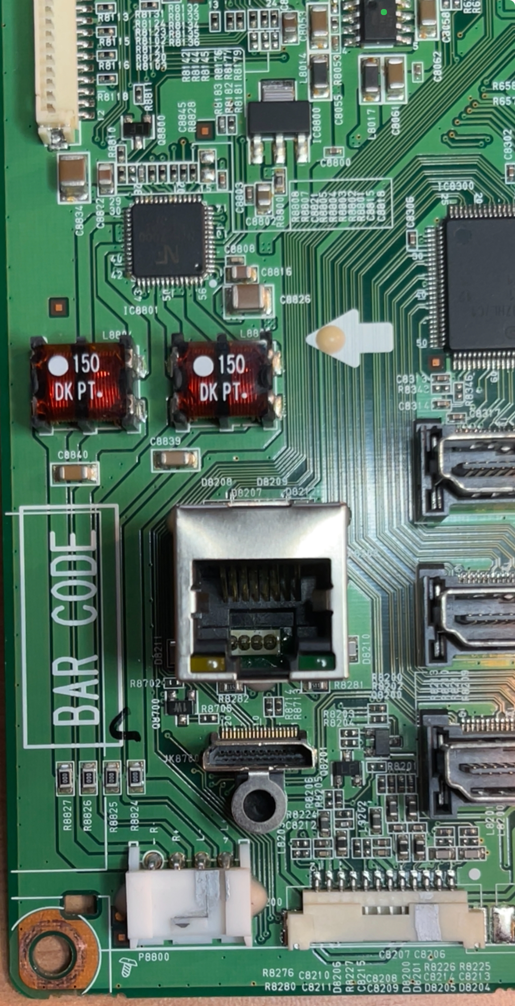

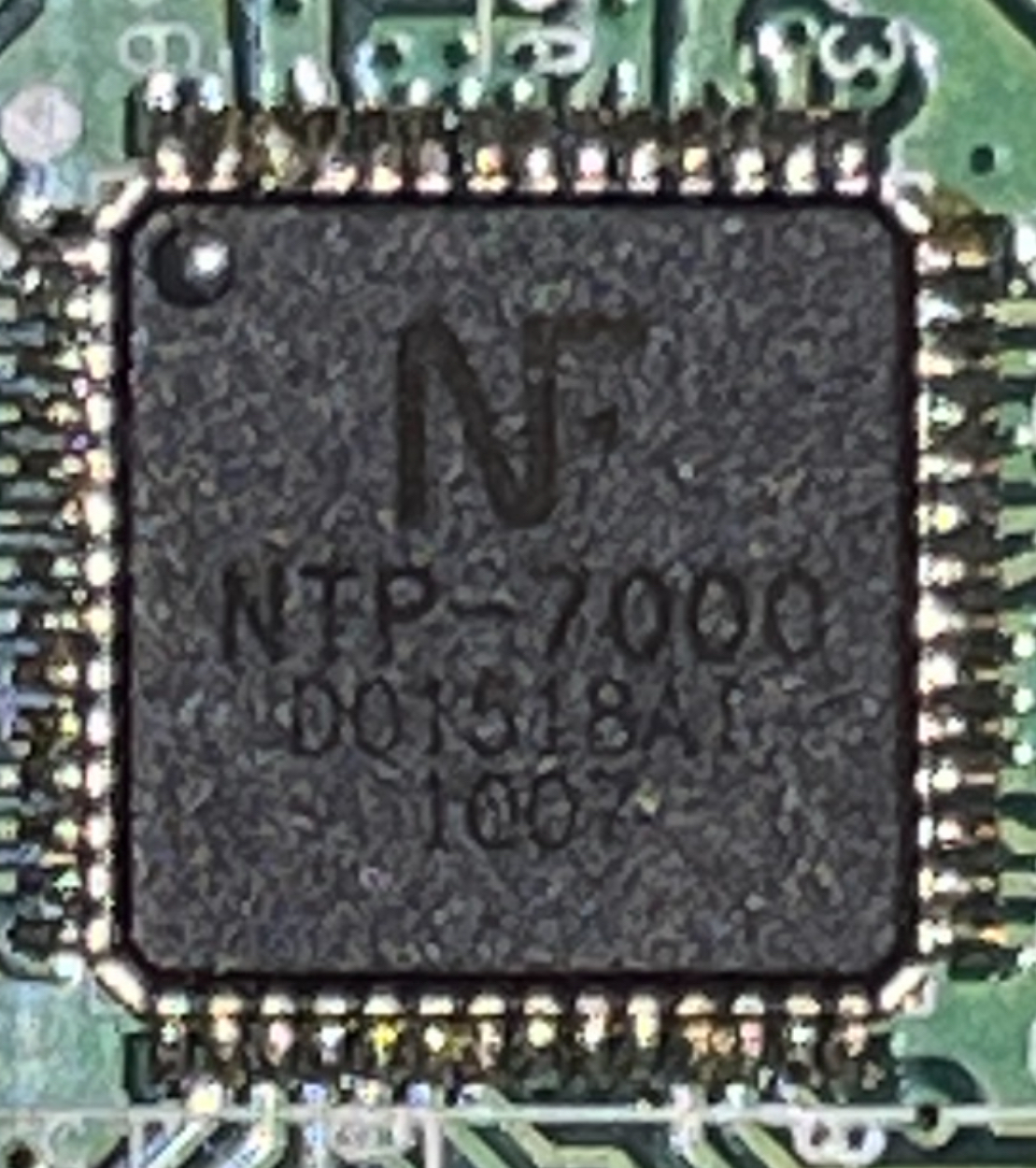

Intermittently-working board:
IMG_4887.jpg - NTP-7000 D01518AI 1007 - Audio amplifier chip.
IMG_4883.jpg - 150 DK PT. - Possibly audio amplifier transformers?
IMG_4882.jpg - Wide shot: Audio amplifier at top, transformers below, connector to TV speakers at bottom.

- Can anyone find datasheet or pinouts for the NTP-7000/NTP-7100 audio amplifier chips? I can find the chips by googling but I'm coming up dry in locating their datasheets.
- Can anyone find a datasheet or pinouts for those "150 DK" components? Are they audio amp transformers as I suspect? I'm wondering if I merely need to tap some RCA jacks onto their top-right corner pinouts to get the line level I'm looking for?

That component appears to be an integrated DAC+amp: I2S in, speaker-level out. It's not clear that there is an exposed line-level signal. A speaker-level-to-line-level converter sounds like it could work.
