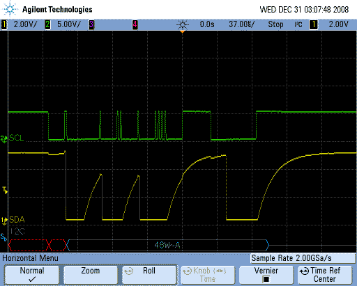

In my testing of someone else's Empeg this weekend that was having problems with the I2C fan controller I sold him.. I realized I also had the same issue lurking in my empeg. (In fact, hooking my scope probes made the problem occur fairly consistently.)
I was testing the I2C bus with my Agilent MSO6000 and realized (I didn't think of it before) that the pullup on SDA is way too big (100K). So, I made both units use a smaller (5.1K) resistor and both units work great now... I didn't drag out the specs for the CPU as I figured a 1mA pull-up current would be "ok".
I didn't change the one on SCL because it's obvious that line is being driven rail-to-rail... so the 100K is fine for any idle states where the SCL driver isn't set for output.
I wanted to get your opinion as to this change and alert other users in case they have issues with the I2C bus in their Empegs.
-Ben
p.s. I have lots of scope pics in case you'd like to see both before and after the change.

no, current sink looks great. nice and sharp. It's the pullup rise-times that show a lot of slope.
And I agree about the I2C requirements. So that's why I put in the different pullup. I had risetimes (measure 10-90% by my scope of around 25 and 26uS. Way too long.)
With 5.1K they are a lot like they should be. (I didn't measure since I compared against SCL's needed times and they look fine.)

I'm back with tests... the weird "pre-start" condition of SCL is now gone... Thanks for the effort Mark!
For all of you though, here are some stats:
100K Ohm resistor ends up being anywhere from 25-35uS of pullup time on the SDA line. This equates roughly as 27Khz to 40KHz xfer rate. Ouch. I'm not sure how this worked before as Mark's code generates a hi-low time of about 1.3uS and 2.6uS. Basically, the clock "frequency" is about 280Khz right now.
With my 5.1K resistor installed, I have a pull-up time of 1.9uS, so there's plenty of setup time before clocking in the next bit.. I don't have such warm fuzzies about the stock configuration.
So I thought I would mention it to you guys here. I'm kinda surprised the things on the bus are happy at all. No wonder I was seeing the "fan control error" messages I was.
I have lots of screen shots off my scope if anyone is interested in seeing before and after "pics".
-Ben

Ben has measured the timings again on his wonderous scope, and sent me the attached capture (below) of an I2C transmission.
Based on that, I've now added an extra microsecond to high pulses of SDA, giving it more rise time. But I've also fixed the low pulses to be *much* quicker, as they hardly need any time at all to transition.
Hijack v506 is now released with the I2C rework completed.

Shonky, if I may humbly offer the correction;
100K in this case "sources" current. I2C is an open-drain bus where open-drain typically denotes that the device sinks on demand while the pull-up resistor sources the needed current/voltage to bring the bus to V+. (I know you know this. My fingers tend to type things I wasn't thinking too. It's like they are on autopilot. )
Anyway - changing to 5.1K works great. I'm guessing that whatever it mastering the I2C lines (whether it's a transistor for 3.3->5V conversion or the strongArm itself, it has to be able to sink current like any I2C bus device might.The DS1721 is specified by what voltage is measured on SDA at 2 current level. 3mA (0.4V) and 6mA (0.6V). I would guess that 1mA would be fine for all as achieved by 5.1K.)

Yeah, this should have been 10k (or even less). We didn't own a scope at the time this was designed hence the issue was never actually seen (ie we never looked at it, and the original software had very long bit delays in the i2c driver). To mitigate at least part of the problem, we have a shorter delay if we're sending a zero bit.
edit: At least, that's how I remember it. Did you see that in the code, Mark? Really, adjacent 1 bits being sent in a row only need a delay for the first one too.
Once some units had shipped with this then it was kinda not worth fixing - that and we didn't really do anything that was very urgent on i2c throughput.
The 100pF caps were recommended by Philips to reduce any audio coupling from the falling edges.
