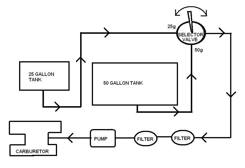

The bus has a complex fuel system -- dual tanks (25 gallon & 50 gallon) running to a selector valve, and then through two in-line filters and an electric fuel pump to the carburetor. (See diagram.)
If I drive the bus in warm weather (65 degrees or warmer) under load at speeds slower than 20 MPH, it vapor locks and quits. I have about 20 seconds warning that this is happening as the fuel pump is mounted under the floorboards and I can hear it starting to go "thocka-thocka-thocka" when it tries to pump vapor and I have until the float bowl in the carburetor empties to get the bus off the road. Opening the hood and letting excess heat escape for 10-15 minutes makes it work again. The engine is not over-heating; only the fuel system is too hot.
It was always my understanding that vapor lock could only occur on the input side of the fuel pump; that the pump couldn't pump gasoline "steam" and the fuel flow stopped; but that if the fuel were boiling in the output line between the pump and the carburetor the pump would keep pressure in the line and maintain fuel flow even if some of it were boiling.
I am beginning to wonder if this is a misunderstanding on my part.
The fuel lines are well away from any heat source, from the fuel tanks all the way through the selector valve, fuel filters, and fuel pump. From the pump to the carburetor is a different story -- the steel line is uncomfortably close to the exhaust manifold and exhaust pipe. Logically that is the most likely place for the fuel to boil. Arguing against that is the line should be pressurized, and usually when it vapor locks it is during a high fuel flow situation (crawling up a steep hill at maximum throttle in third gear low range at 15-20 MPH) so the fuel shouldn't spend enough time in the hot fuel line to boil. Also arguing against the boiling being on the output side of the pump is the fact that the pump is going "thocka-thocka-thocka" which strongly suggests that it is not receiving fuel from the input side. But the input side is not subject to much heat...
So, I don't know what is going on. Symptoms point to vapor lock on the input; logic points to vapor lock on the output side; [possibly faulty] knowledge says output side vapor lock shouldn't happen.

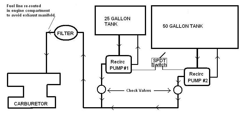

Perhaps a fuel system upgrade is in order--replace the fuel pump with a recirculating pump, the kind that recirculates back to the fuel tank the fuel that doesn't go to the carburetor so that there is always cool fuel in the lines. But this is complicated by the dual tank setup; I'd have to choose one tank or the other as the default recipient of the recirculated fuel. This could work very badly if both tanks were full and I was taking fuel out of the non-recirculated tank.
Hmmm... this gets me to thinking. How about a simplification of the whole system, like the attached? OK, it's not a simplification, is it? I get rid of one component (switching valve) and add a bunch of other things, but as a scatter-gun approach to solving the problem it ought to be sure-fire. I like the fuel pump redundancy idea, too. If one pump fails, I can continue on the other one. Center-off position on the SPDT switch also gives me theft protection, because God knows, the car thieves are out in force looking for 1971 school buses! smile
Are the check valves necessary, or are they built into the pump(s)? I don't want fuel recirculating to any tank other than the one that fuel is coming out of in order to prevent overflow in a full tank.
One problem I foresee is finding someone to do the work. Most mechanics are reluctant to work on fuel tanks, particularly if welding is involved, and I think there would be welding required to install the return line fittings to the tank. Are there any magic fuel-resistant epoxy adhesives that would work? I've used a fuel tank leak repair epoxy that worked for years after the repair. Could I drill a hole in the tank, thread a fitting into the hole and then gloop the hell out of it with epoxy? [Gloop = mechanic's technical term]

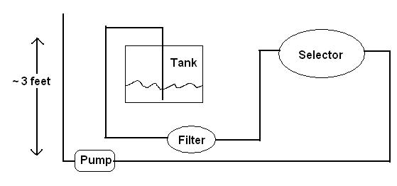

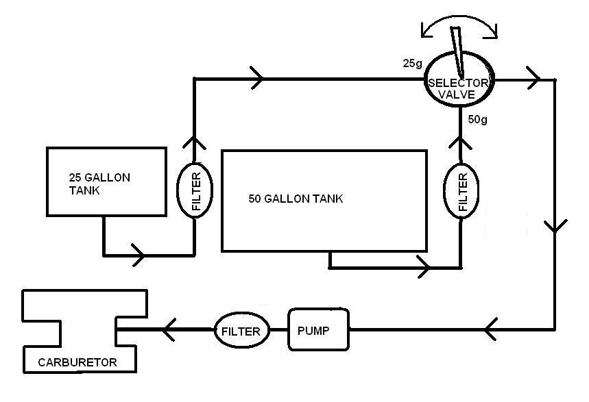

I went out to the storage yard and climbed under my school bus to be sure that the fuel flow path was as I remembered. It almost was. I've attached a modified diagram to show the differences. Essentially, the two fuel filters are between each tank and the selector valve, rather than in series after the selector. That will alleviate some of the problem - the fuel on the intake side of the pump only goes through one filter instead of two. I also found a filter on the output side of the pump, and there is a fuel strainer attached to the intake of the pump.
So, while the fuel only goes through one filter on the way to the pump, there is another aspect to the fuel path that will make things worse. Maybe. The fuel pickup is (obviously) in the bottom of the tank. But the fuel exits from the top of the tank, so there is about a two foot elevation gain. From there the fuel line loops back down to about a foot below the bottom of the tank to the fuel filter, then goes back up about three feet to the selector valve before coming back down to the fuel pump. Hey - don't blame me, I didn't design this! In the normal course of events, these elevation changes wouldn't matter, there is a net elevation loss between the fuel pickup and the pump so fuel would flow to the pump through siphon action even if the pump were not developing suction. But in our case, where the vacuum in the lines may drop the line pressure to the point that the gasoline boils, the siphon may break. I'm not sure about this. Maybe the ups and downs are irrelevant. I've attached a drawing more or less to scale showing the vertical travel of the fuel on the way to the engine.

Description: Corrected fuel path diagram
Description: Approximate scale showing vertical travel of fuel from tank to fuel pump

I'm thinking the elevation changes are no big deal, it's only the length of line that will cause friction, and gas in a carb setup doesn't move fast, so essentially no friction loss.
