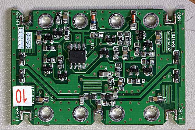

Ever since my previous adventures into TV antenna Frankenswitches, I've been looking for a simpler/cheaper way to accomplish something similar. A design for an antenna autoswitch that others could perhaps build/use for their own MythTV / SageTV setups.
DisEQc satellite multi-switches are widely and cheaply available. This past weekend, I picked up a simple 4-way DisEQc-2.0 switch for CDN$8 from Active Surplus.
Now, designing/incorporating a full DisEQc protocol front end for one of these would be optimal, but also complex and potentially expensive. So I'm thinking of something much simpler.
The disassembled DisEQc switch is shown below, and a larger version is here.
It appears to use pin diodes for the switching, with fairly straight and simple signal paths through those devices. One pin diode per input (four in total), plus two extras near the middle where they connect to the downfeed. Those two extras have me a little puzzled, but I think they're there just to provide additional isolation between the two pairs of inputs (left and right).
Each of the primary four pin diodes has a cascaded pair of transistors driving the bias, to switch it on or off. These four pairs of transistors are wired directly to GPIO pins on the unlabelled PIC controller chip on the board.
There is one extra pair of transistors, whose function I have not determined -- but that probably has something to do with powering the PIC. EDIT: they're for sending response packets from the PIC back to the receiver.
My plan, is to remove the PIC from the circuit board, and replace it with four TTL signals from the parallel (printer) port of my MythTV PVR box (or perhaps connect it through another one of those USB / GPIO gizmos).
Plus a ground wire, and a +12V supply line for the multiswitch, rather than trying to wire the +12V into the downfeed coax as is normally done with DisEQc.
Comments, suggestions, and wisdom would also be appreciated.
I'm a software/firmware geek, not an RF engineer!
Description: DisEQc 4x1 switch.
Edited by mlord (02/05/2009 00:57)

Yes, that's the 35x52mm PCB from a 4:1 multiswitch. The RF paths look reasonably straight, for a CDN$8 device. Most of the crooked stuff is in the control circuitry.

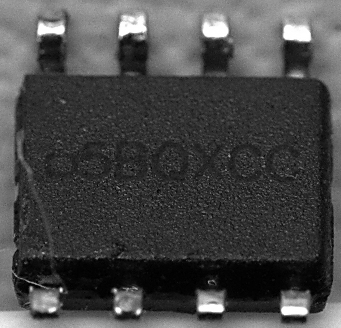

For what it's worth, here's the underside of the controller chip that I have now removed from the PCB. There were no markings at all on the top side, but here it appears to say ?5BQXCC on the underside.
Description: The controller chip from the DisEQc 4x1 switch.

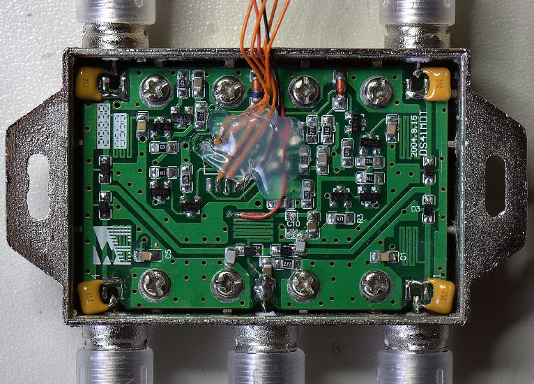

Here's the hacked-up multiswitch. I've removed the chip, and the two transistors that dealt with the 2-way communications over the downfeed coax, and then added +12V, GND, and four control wires.
There is also now a 1000pF DC-blocking capacitor on each of the four coax inputs. I opted for non-surfacemount to begin with, because they were 1/3 the price.
The wires will all go to a USB/GPIO subassembly, for software control from MythTV. Later today, I hope.
Description: Hacked multiswitch.

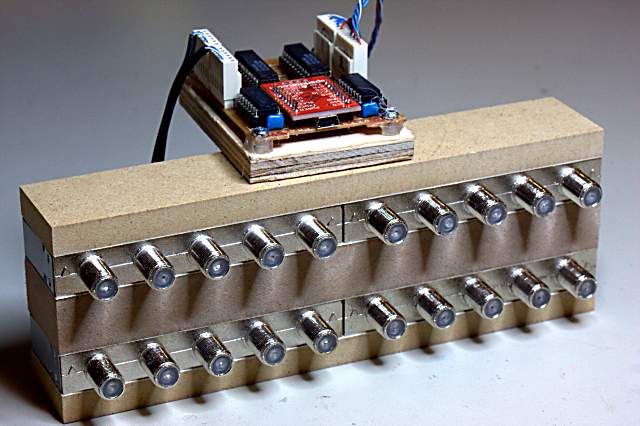

I finished the control board for this yesterday, and sorted out the multiswitches today -- three out of six were defective, and I ended up salvaging two of those using parts from the third.
The completed Frankenswitch v3 has four 4:1 switches tied to a single USB interface, with a pair of 74HCT139 demuxes providing fanout of the eight available GPIO lines, and a pair of 74HCT240 buffers acting as octal inverters to fix the inverted outputs of the '139 chips. Lots of wires/soldering to tie all of that together.
The switch is now installed in the Myth cabinet and working quite well. The remaining 4:1 switch (plus the dead one) is destined for a friend's Myth system.
Photos later, when the cabinet is next opened up to remove Frankenswitch v3.

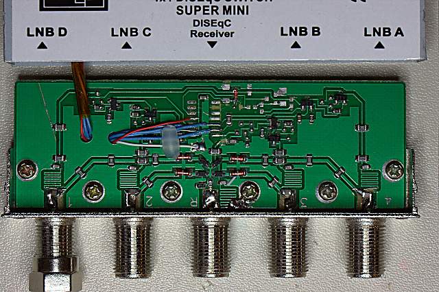

#327404 - 09/11/2009 03:32 Frankenswitch v4! [Re: Folsom]
Posts: 14529
A few weeks ago, I picked up a different $7 4:1 DiSEqC switch, and today I modified it to work with the Frankenswitch v3 USB-based controller built previously.
The new switch has all of the coax jacks on the same edge of the casing, making it much friendlier to use.
Internally, each signal path has its very own dedicated pair of two pin diodes (eight in total), compared with the v3 DiSEqC switch's total of six diodes for the four inputs.
The PCB layout is also better than the earlier one, and this time I used SMT 470pF capacitors for the DC blocking caps (I already had some on hand) instead of the long leaded 1000pF caps used earlier.
The results are good -- +0.2dB improvement on the SNR reported by my best tuner, and visibly better on-screen analog TV, especially VHF-6.
I expect 1000pF would do every bit as well (or better), but I don't have any SMT ones on hand to try.
#329052 - 20/01/2010 21:09 Frankenswitch v5! [Re: mlord]
Posts: 14529

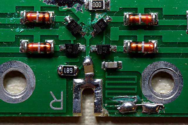

I finally got round to working on this again, and now have four of the newer DISEqC switches modified and mounted behind the MythTV cabinet. This setup works very well.
Description: Frankenswitch v5
Description: One of the newer 4:1 DISEqC switches, hacked.
Description: Closeup, showing the pin diode arrangement, and the four other non-pin diodes in series with them.
