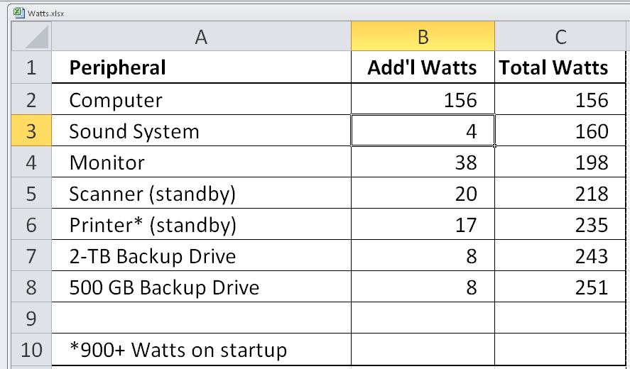

#352495 - 05/06/2012 22:26 Watts
Below is a chart of how much electricity the various components of my computer system use.
Are these reasonable numbers?
Normal mode of operation is at 198 watts.
#352498 - 05/06/2012 23:27 Re: Watts [Re: tanstaafl.]
Posts: 14514
Time to upgrade to something more modern and power efficient. 156W is way too much.
My MythTV system, with multiple tuners, five hard drives, and a fancy graphics card, doesn't hit that amount even when all of those items are "busy".
Edit: Normal steady state when watching 1080i video is about 85W, and there are far more power-efficient systems available now than when I assembled that one.
Edited by mlord (05/06/2012 23:30)

#352512 - 06/06/2012 12:10 Re: Watts [Re: mlord]
Wow - I'll need to look at my main system (which does have much lower power usage than the big servers and SGI boxen)
It isn't going to be anywhere near that low :-)
(what did you use to get power figures?)

#352535 - 07/06/2012 00:47 Re: Watts [Re: mlord]
Well.... I could do that, but it would not be cost effective.
My house is split out on two meters: one for the computers (mine and SWMBO's) and one for all the rest of the house. The A/C is split evenly between the two meters, with one 110V leg of the 220 the A/C uses coming off of each meter.
Right now, after a full year of operation on the split metering, the house has used one kWh more than the computers. My most recent electric bill which covers a two month period, came to 200 pesos for each meter. (This was before the A/C was installed.) That works out to about eight dollars per month for my computers.
I should note that in addition to the computers, the second meter also has two telephone systems (one local, one VOIP), a cable modem, and a router. These draw 30 watts 24/7.
SWMBO's iMac uses far less power than my system; it is efficient, yes, but also far less powerful than mine. Let's say it uses 1/4 of the power of my system. That means my inefficient power-hungry system is costing me $6.00 per month to run. That's for computer, monitor, scanner, printer, everything. The computer itself is probably costing me about $5.00 per month.
So, if I could cut my power usage in half by spending $2,000 to build a really energy-efficient but powerful system, why the electric bill savings would pay for the new computer in just 33 66 years.
I'll get right on that.
