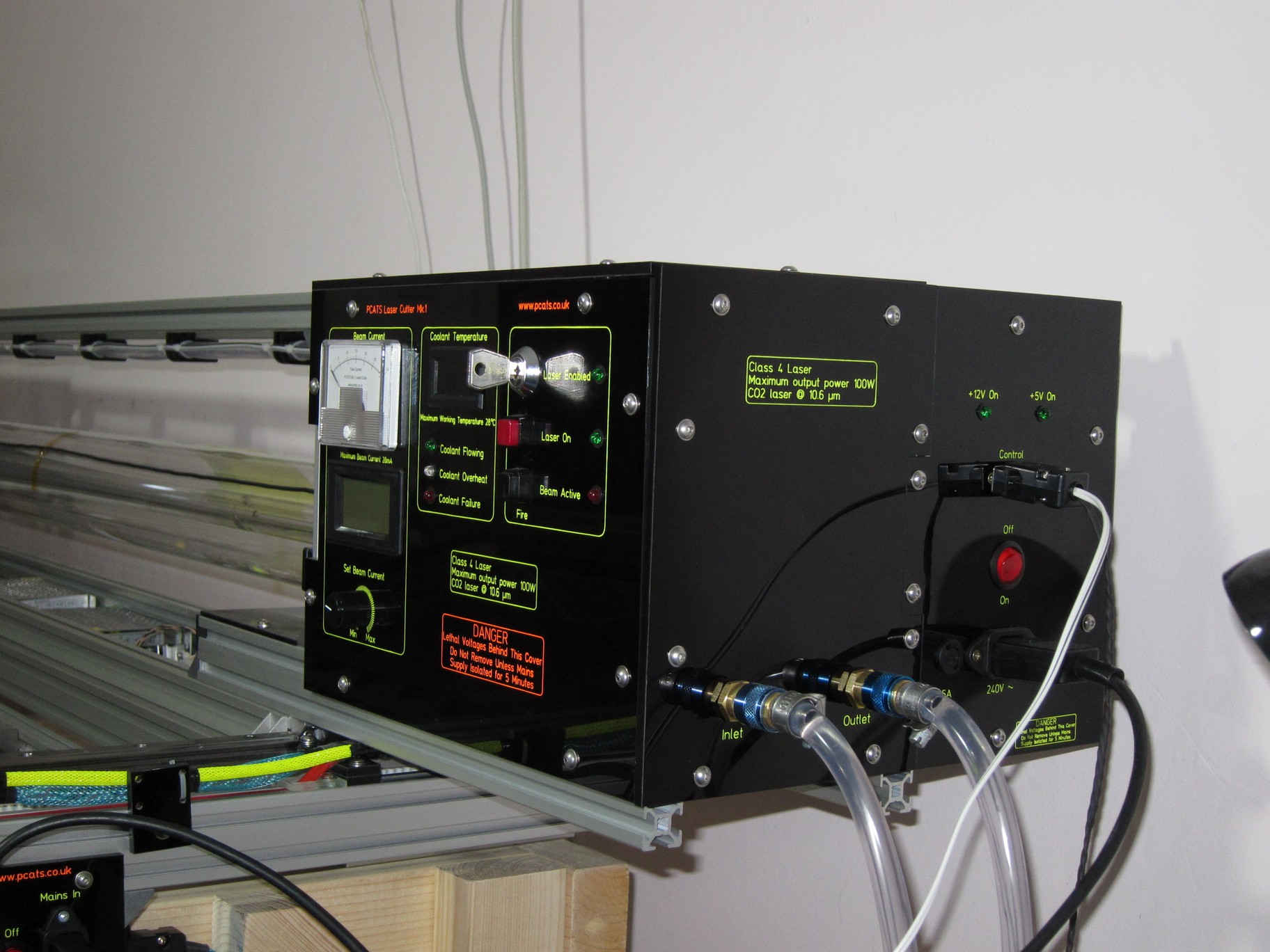

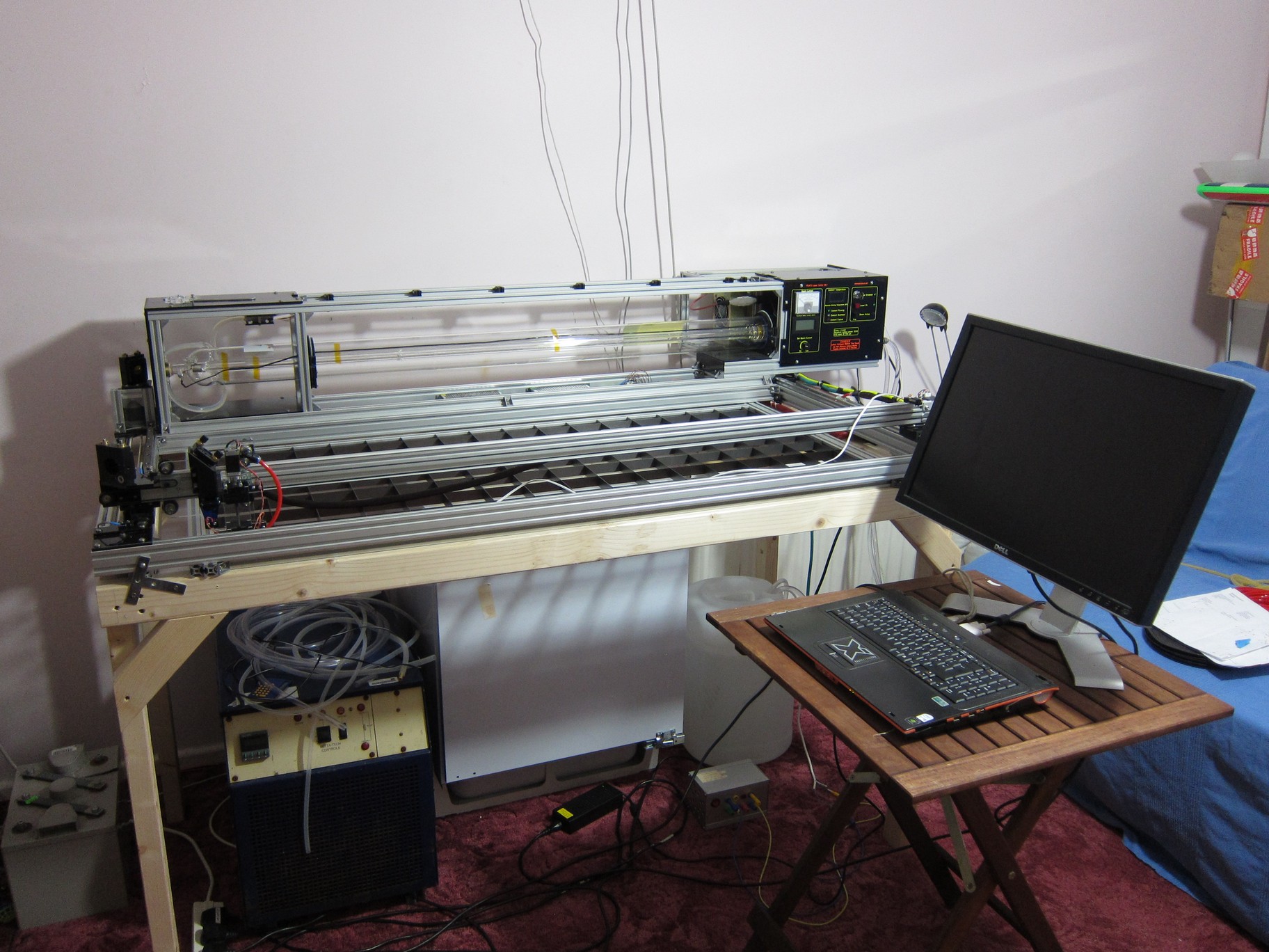

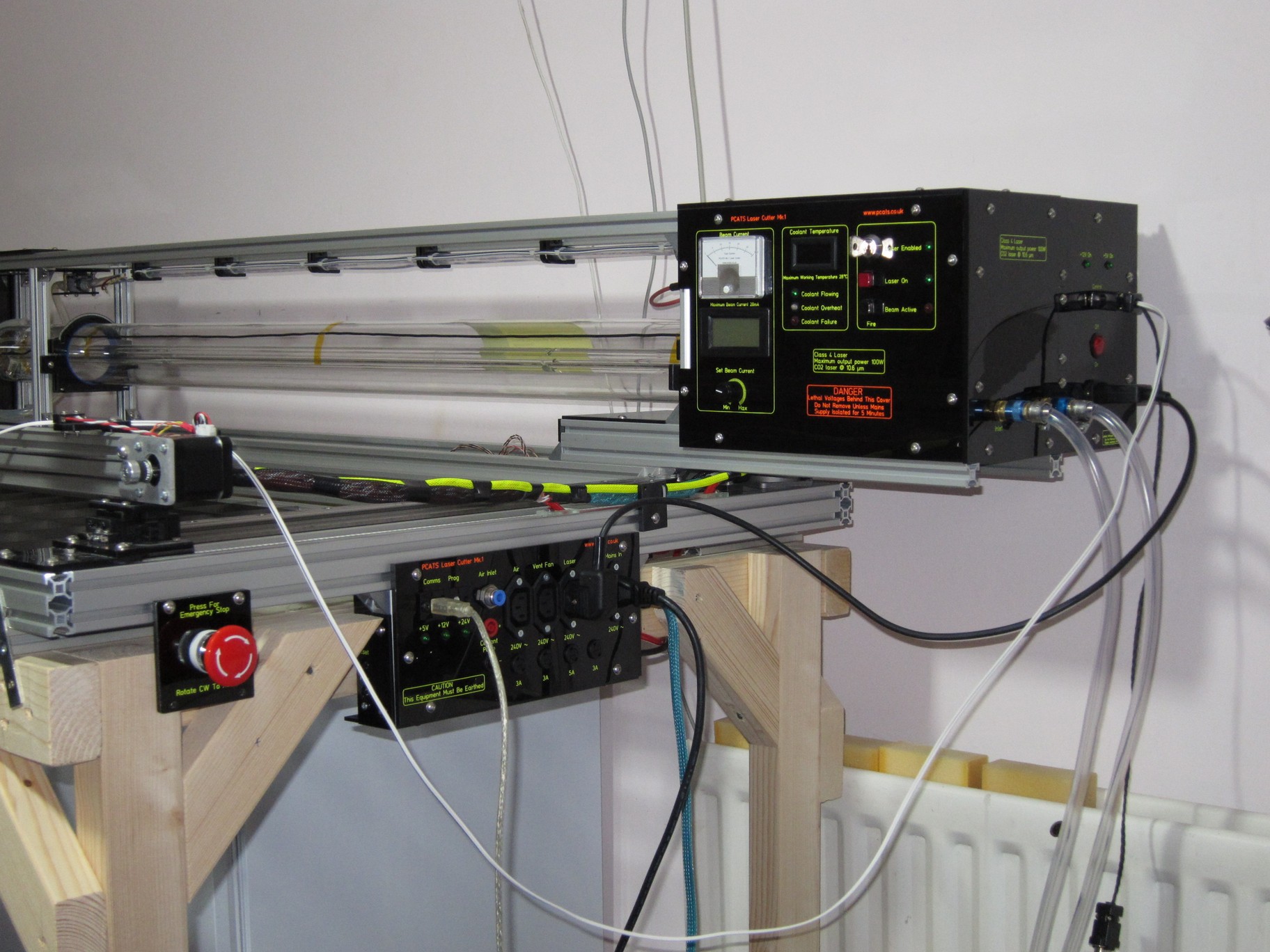

So I designed and began building a bigger, faster, more powerful one. I may have become slightly carried away...
Now that it's nearly finished, I'm looking at it and thinking, "Ummm..."
I'm rather pleased, overall. It was designed in such a way that the grid bed can be removed so a standard 8 x 4 plywood sheet can be slid in and cut up in just under 600mm tall pieces. The cutting area is 1245x595mm which is pretty large, while it has a 100W CO2 laser tube in it, which is absolutely huge. The tube is 1.7 metres long!
I designed the entire thing in CAD, then had all the aluminium extrusion parts cut to order. Everything just bolted together in a very pleasingly accurate manner. Most of the fiddly bits are made out of 5mm acrylic, which is a surprisingly structural material as long as it's not bent too much. It doesn't like that.
Amusingly, laser cutters self-replicate. I made very extensive use of the small one to make the large one. Especially for things like very nice control panels.
The laser is designed as a completely independent intelligent peripheral, the idea being I could fit a smaller one if necessary. In fact, I designed it around a 50W tube but the 100W one came up at a silly price during the later assembly stages and I couldn't avoid buying it smile It did increase the cost of the project, as I then had to design a new housing for it, and get new mirrors and a power supply as well, but I think it was worth it. I can always sell the 50W one again.
It's entirely my own design, to meet a specific requirement, but I will admit that seeing it fully assembled it's slightly larger than I pictured...
On the other hand, it works, it's cost less than 20% of how much a really cheap commercial one that size would, and I've added a lot of things I wanted that I haven't seen on other ones. Plus it was a lot of fun building it. Now I have to figure out where it will live, I need my living room back!
laser cutter full small.jpg (526 downloads)
Description: Nearly done
end detail 1.jpg (518 downloads)
Description: Nicely engraved panels

Description: Laser close up

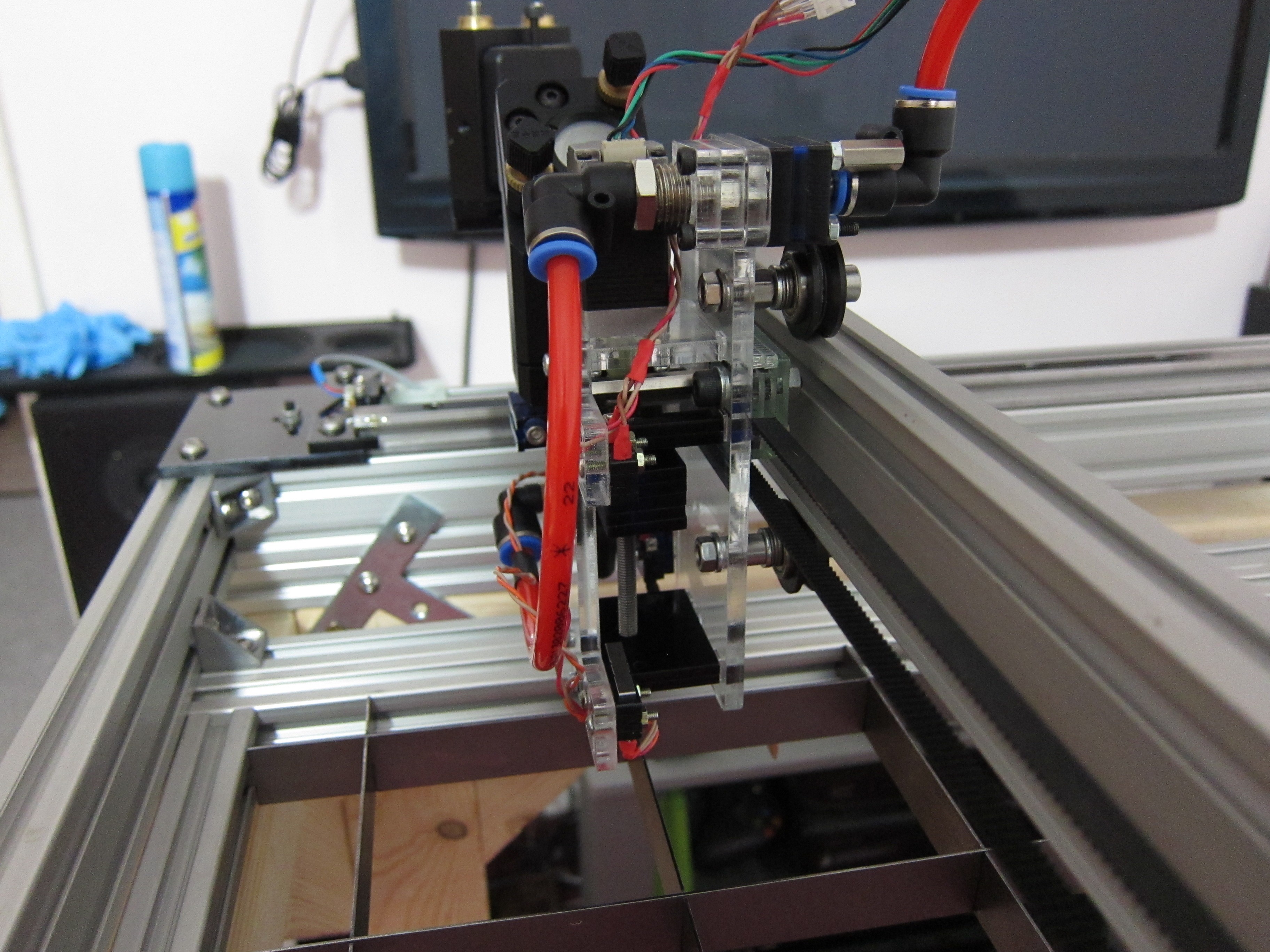

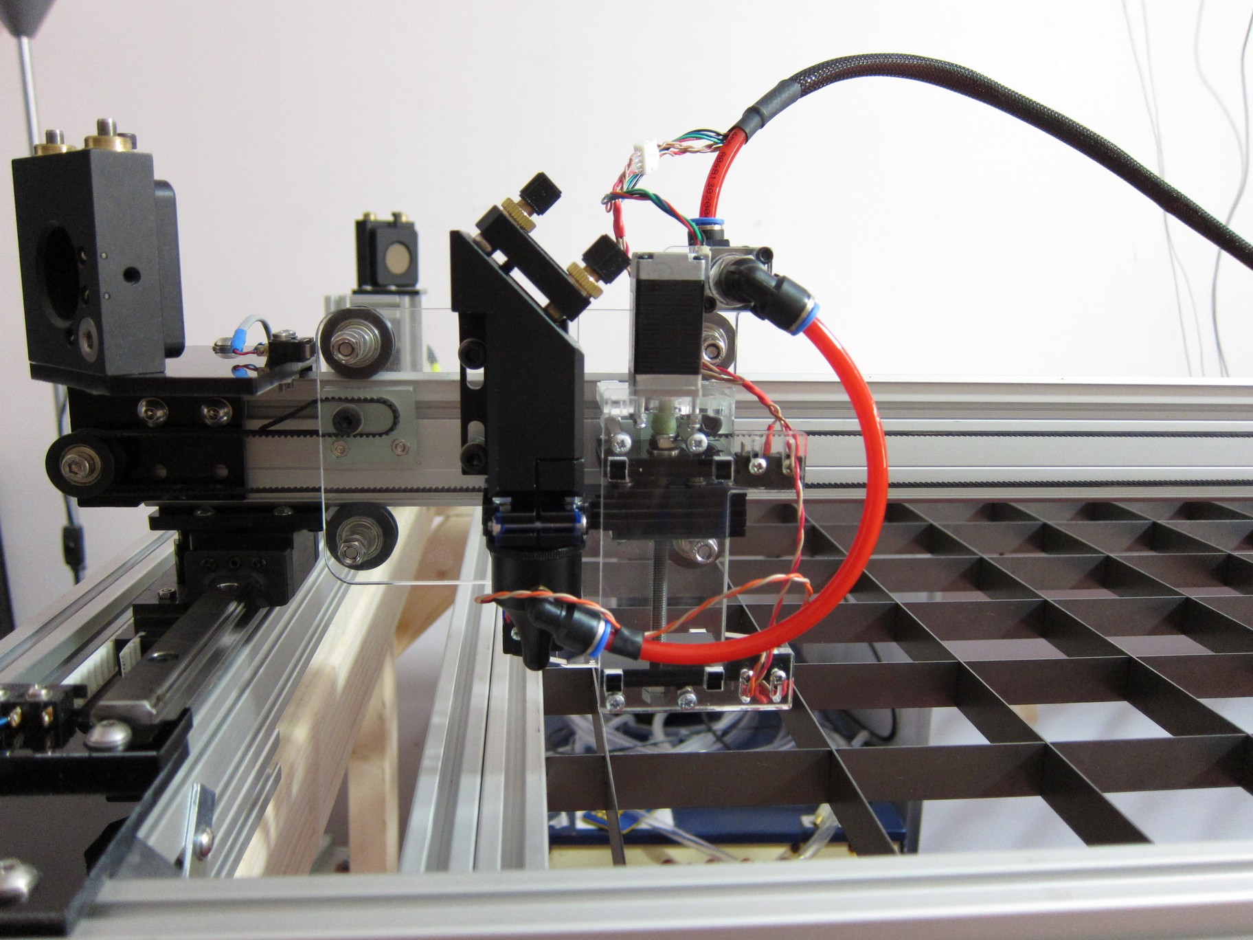

I'm particularly pleased with the self focussing head I designed. It's still slightly unreliable, but it's easy to make major upgrades just by cutting new pieces and bolting them on.
You just need to add a small segment of G-Code to the beginning of the job file and it finds the surface, then backs off to the rght focus distance, ensuring a perfect cut every time. In theory.
head 1.jpg (499 downloads)
Description: Self-focussing head front
head 2.jpg (549 downloads)
Description: Self-focussing head side
