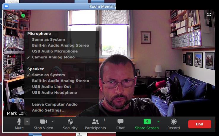

I use Zoom on Linux. My notebook computer has a built-in Mic, which is the "Same as System" default for Zoom. But my external USB webcam has another, better Mic.
So I first had to start up a Zoom "New Meeting" with only myself. This then bought up the main Zoom video window, with a microphone sub-menu now accessible at bottom left as part of the "Mute" icon. Accessing _that_ menu then permitted selecting _which_ microphone to use. I wanted "Camera Analog Mono" here.
I can test all of this by then "Recording" my solo Zoom session, and later playing back the recording to guarantee it all works.

Most video conferencing apps (including web based ones) have some sort of VU-type-meter in their audio/video setup sections. Can't help specifically on Mac or Zoom, but would look in Audio Settings in the screenshot above.

I finally got her to sit down at her iMac and try doing what you suggested. You nailed it.
Apparently Macintosh doesn't follow the common tradition of clicking the little triangle next to the icon to bring up the sub-menu. That was unfamiliar to her. She just clicked the mute icon which, of course, did nothing useful. Once I showed her how to bring up the sub-menu, then it was a simple matter to choose the correct microphone.
All is right with the world now. Thank you, Mark.
